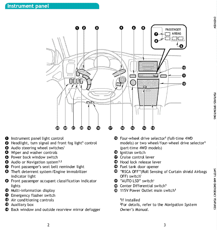

Roll over Side Curtain Airbag (on/off switch)
jwa898 said:
What does the RSCA off button do, and when would I use that?
It allows you to drive your vehicle along trails where the vehicle would be tipped up high to the left or right and not set off the RSCA system.
I am guessing that Toyota found in testing they could tip the vehicle high enough to deploy the side air curtain airbags - accidentally with out a crash.
The switch allows you the option to turn them off, so they dont deploy by accident
regs
joe
josh220 said:
Where's that button located, I can't picture it in my mind.....
Not sure if it's the same on other models, but in the '04 manual it shows it to the right of your diff lock switch.
here ya go
Josh,
If you don't have the side curtain airbags I don't think you would have the button. Also so I would never need to hit that when driving on a road even in the snow?
