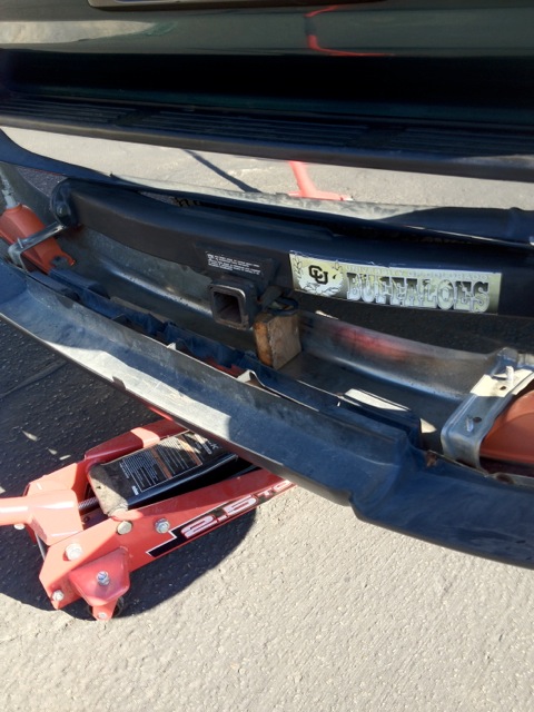

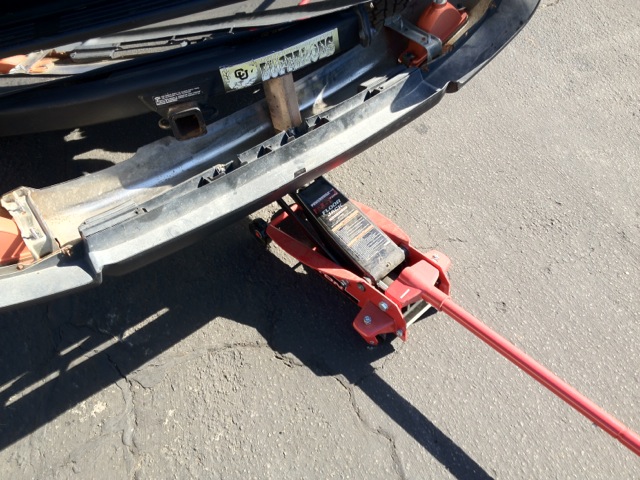

Step 1) Let your Dad drive your 4Runner and hit a tree, (Denting the Bumper)
2) Let Bumper look like crap for a year or so
3) Decide your going to fix it
4) Take Bumper off car.
5) Grab some blocks of wood and a Jack
6) Place your dent between two pieces of wood, and then put that on top of a jack.
7) Place this wonderfulness under your trailer hitch
8) Raise the Jack so your Runner is higher then your next door neighbor.
9) Lower Jack to see your bumper's dent is a hell of alot smaller
10) Put Bumper on, and grab a cold one. (Cold one = Cold soda obviously because I'm 15)
*These pictures do not do their justice, the after is way better then it looks*

Flip the bumper over, use a longer board across the (laying same direction of bumper) and jack from the back of the dent. Using a towel on the face of the bumper to protect it. I bet you will get even that much smoother. Good Redneck engineering though.

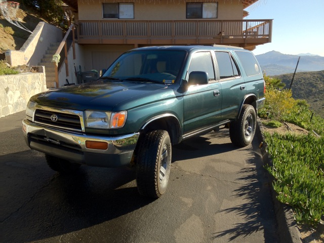

LOL dude you have no redneck cred if you live in Escondido and your other family car is a BMW 330i.
x2.. I noticed San diego and only looked at background in first picture seeing he was in the hills. So thought maybe he was in Ramona.or Campo... but now that I look at the houses in the other picture and know he is from Escondido... yeah can't give you much Redneck credit. How about I write a letter to your teacher and get you some Creative Thinking skills credit instead.

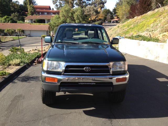

I didnt really notice the 4runner, I was checking out the view you have from your house !
Awsome
I gotta move the hell out of CT, CA looks awsome everytime I see pics and hear about it .

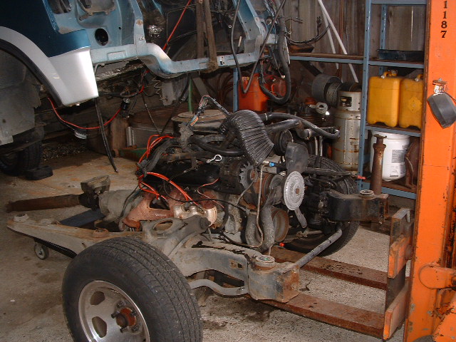

I have you beat on redneck engineering...
I once pulled an Audi A4 Frame rail straight by positioning the car between 2 trees, strapping the frame rail to the tree with a come-along, and tying the opposing side of the car to the other tree....then Ratchet away and hope the cable didnt snap!
I think that was the height of shade tree mechanics.
