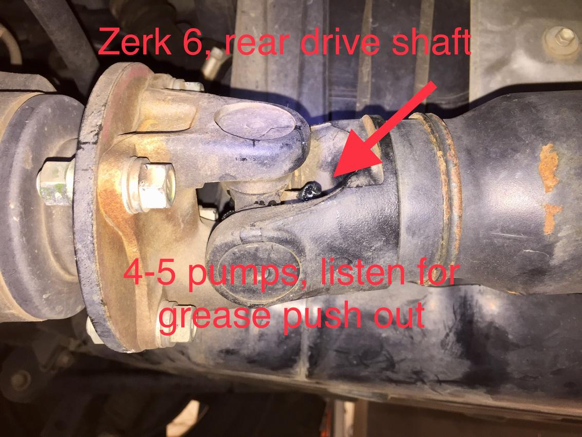

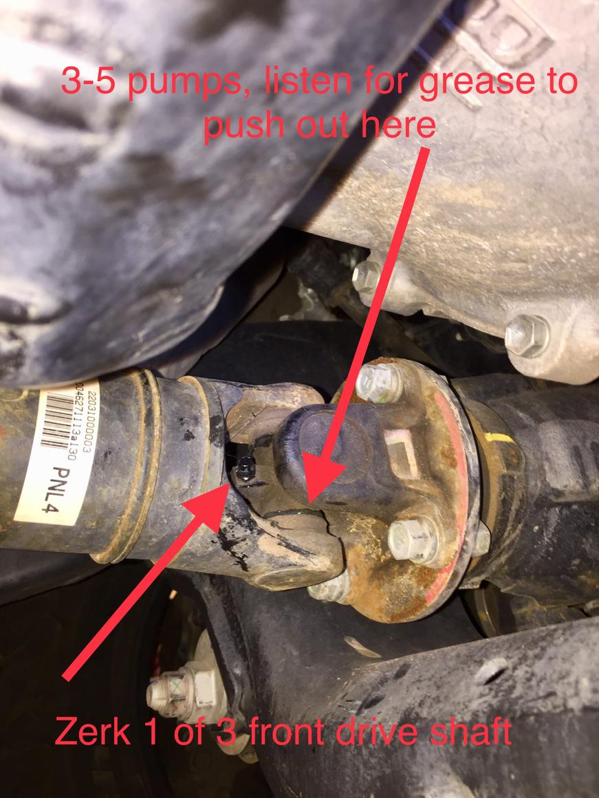

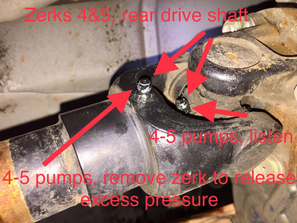

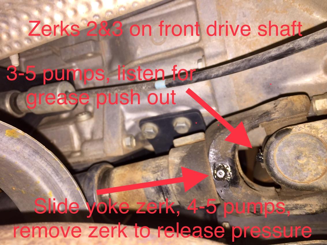

There are 4 spider zerks and 2 slide yoke zerks. Clean off the dirt from the zerk before pumping grease in to avoid getting dirt in the joint.
The spider zerks will take 3-5 pumps. This kind of depends on if this maintenance has ever been done or how long ago it was done. Just listen for the grease to squeeze out the joints. You’ll easily hear it. Wipe the excess off.
The slide yokes are another common area of confusion. Some people state that pumping too much grease in here is dangerous. You won’t necessarily hear these squeeze out when they are full like the spiders. Too much grease can cause too much pressure. Slide yokes allow some movement in your drive shaft. Too much pressure equals too little movement.
An easy way to do this is give the slide yoke zerk 4-5 pumps or so. Next using a 7mm socket, remove the zerk. Now push up and down on the front and rear bumpers to get a little movement in the slide yokes. Check back under the car and wipe off any grease that squeezed out. Replace the zerk. Do not overtighten this. Just needs to be snug. Now you can be sure there is not too much grease there.
