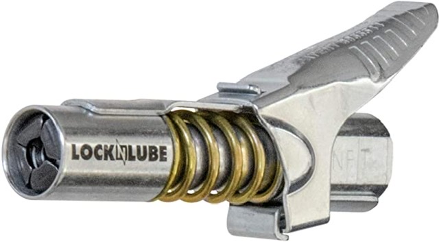

Is the xl lock n lube fitting worth the extra cost over the regular for this application?

Great tool! Just finished mine this afternoon using the LockNLube. It CAN be a little fiddly to get on to the zerk at certain angles, but once it's on, no issues at all.
