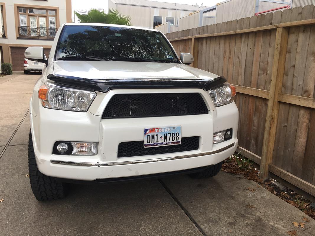

Ok, so I'm attempting to make a how-to installation guide for the Grillcraft Upper and Lower grill since "Grillcraft" did a really crappy job with theirs. What I have below isn't perfect (I missed a few minor steps), but if you use this in conjunction with Grillcrafts directions in the box or online Upper Grill Instructions or Lower Grill Instructions you can't go wrong. Some pics borrowed from Grillcraft because I forgot to take them while doing this today.
Step 1:
Take a before picture you start, because this is the last time you will ever see the old grill on your 4Runner.
NOTE: This modification is irreversible, you will cut up your old grill to insert the new grill. Again, this modification is irreversible!!!
IMG_0988.jpg~original
