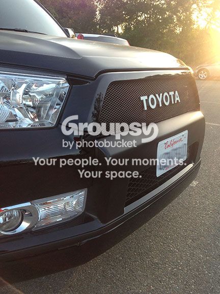

GREAT write up OP. I did my Tacoma a few years back and loved the look so I followed your guide and did on my 4Runner yesterday. Looks great

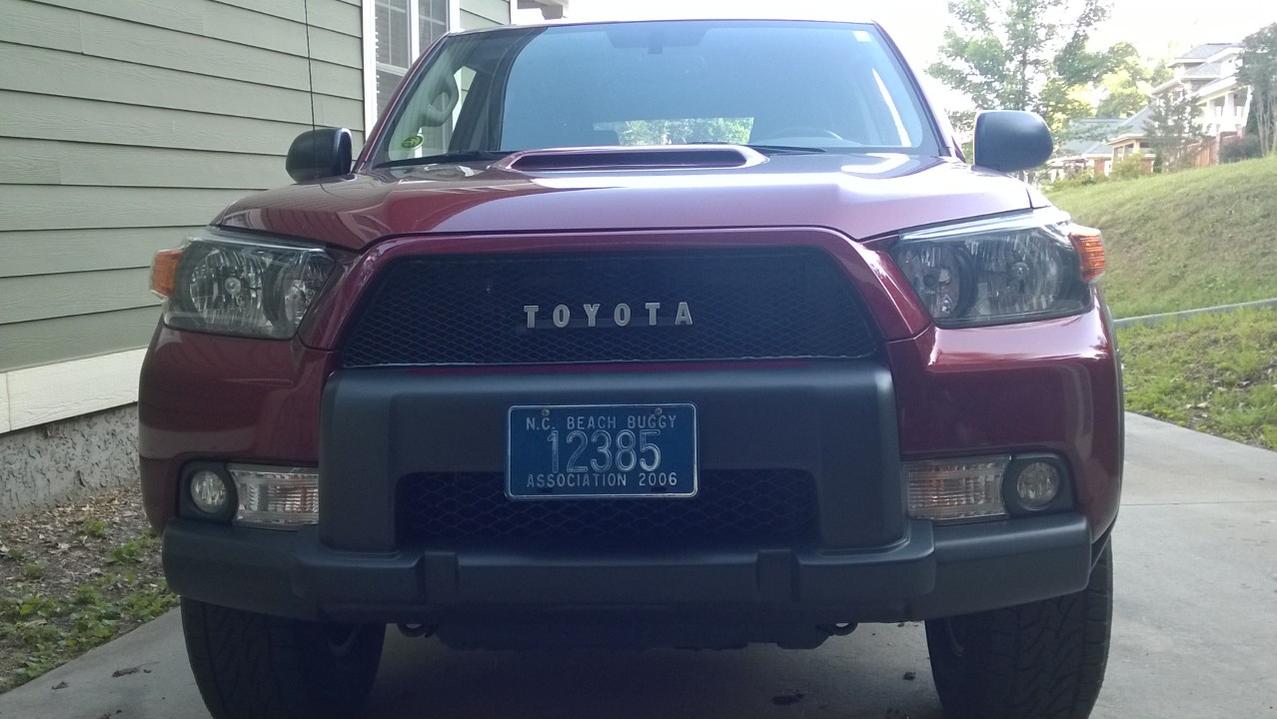

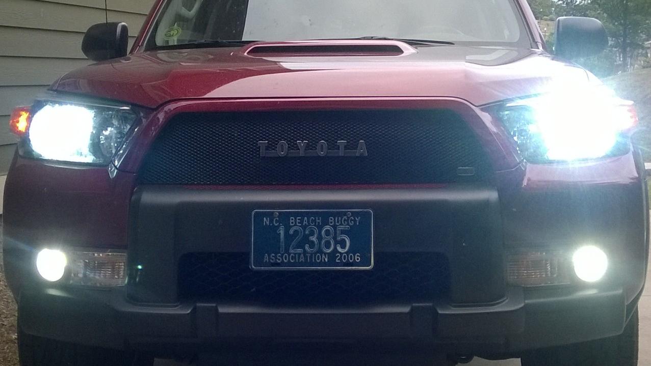

Thanks again to the OP for the walkthrough. It took me a year to finally carve out the time to do this. And now have done it twice.
First try was with a grill from customcargrills.com. I liked the mesh, and it was the right shape, but did not fit at all and needed a lot of trimming. Which I didn't have patience for once I finally finished it, so it all went back together (picture with lights off).
After two days, I hated looking at it and sprung for the much more expensive Grillcraft version. This one is cut correctly and is a much sturdier piece. So the second (and final) version is the one with lights on.
My tips for those who still haven't done this:

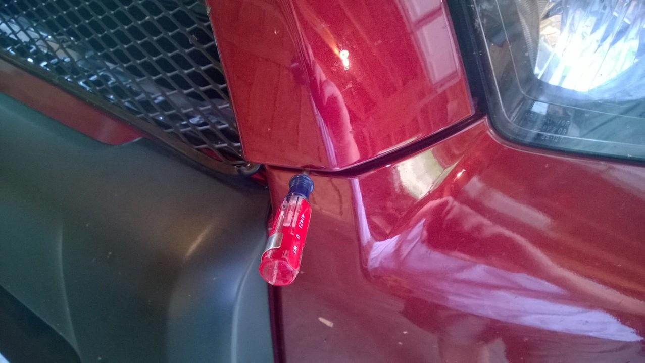

As mentioned before, the hardest part is getting the grill frame released from the front of the car (namely the PITA clips by the headlights). I finally removed the four plastic trim clips from below the frame (holding the painted upper bumper cover in place). This allows enough play between the two plastic pieces to slide a small screwdriver between them and release the tab. There may be minor scratching of paint there, but you don't see it once the parts are back together.
I tried the jigsaw method cutting out the bulk of the inner grille, but honestly would have been faster doing the whole thing with the Dremel. You need this anyway for the tighter spaces.
As y'all can see, I chose the smaller, old Land Cruiser emblem over the FJ one. This is metal. So I had to cut into the mesh (the customcargrills one is much wider and didn't need cutting) to make it fit, then used a bunch of washers as spacers to hold it in position with machine screws on the back of the plate.

Instead of that screwdriver [MENTION=25083]tophmack[/MENTION] you should have spent the $10 on a panel removal kit! Makes quick work of that stuff without leaving marks!
