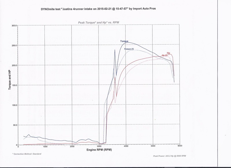

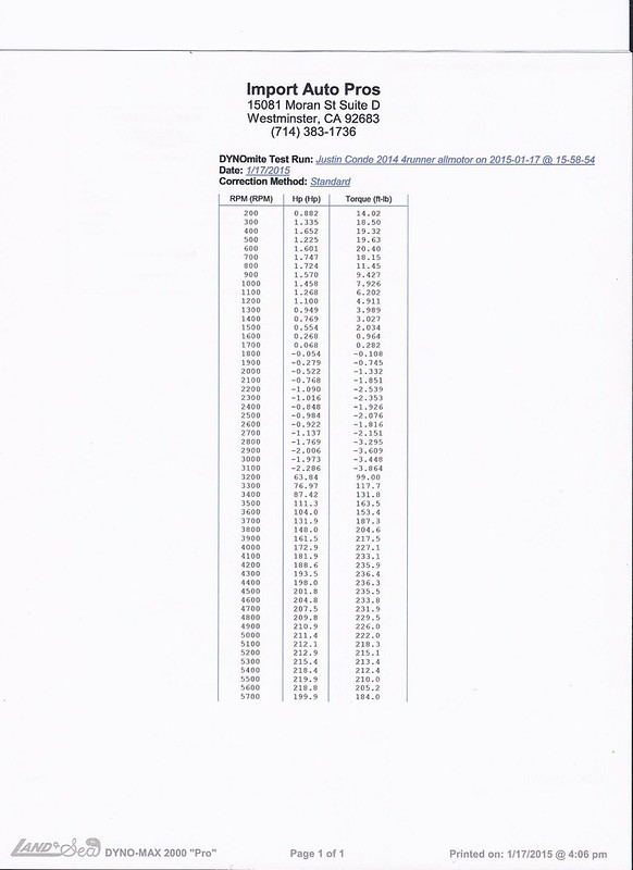

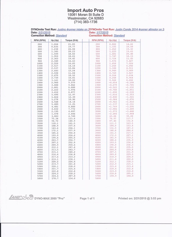

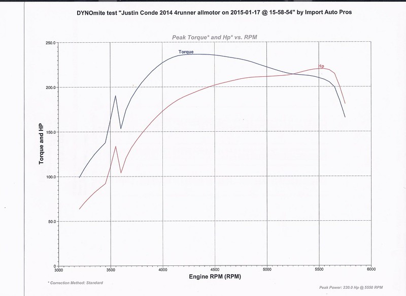

What you mean ???
I have Dyno results in my build thread ???
stock :
TRD CAI :

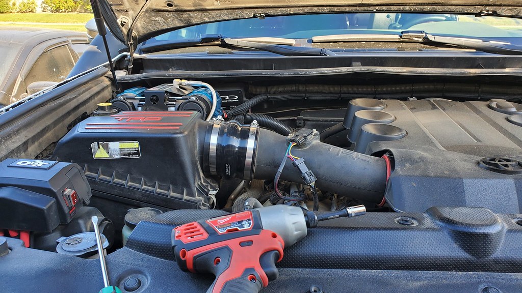

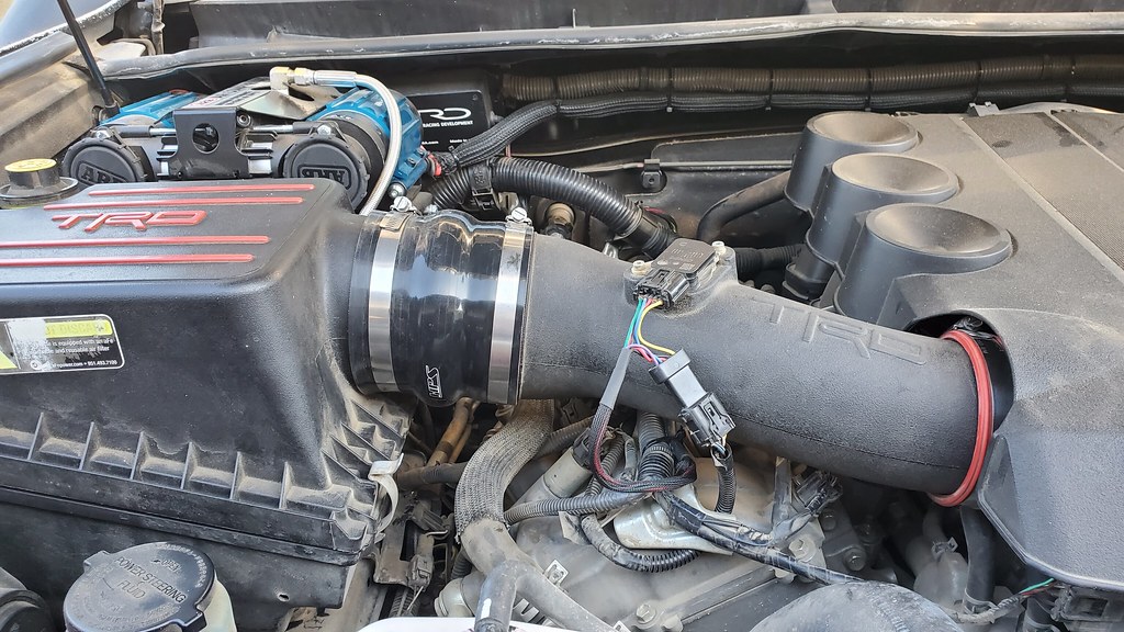

For those with issues like me ... Where the TRD coupler keeps popping off...
I replaced my TRD Intake coupler that always seem to pop itself off in the most inconvenient times. With an HPS silicone hump hose coupler.
HPS is the only one I can find with a 4.25" x 4" long hump coupler. I wished it was red but black will do. If anyone is interested The HPS part# HTSHC-425-L4-BLK
Plenty of dynos if you searched :confused:
Gecko's 2019 Limited 4x4 Black/Redwood Thread (All Dynos In)
+13hp and 13 lb-ft of torque

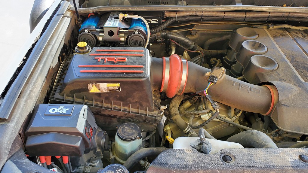

On the TRD intake box there is a little pressure gauge. It's a gimmick to alert you that your filter is dirty. It has a little yellow button to reset it. You can see it in this generic photo.
Ah yes. Not sure... I had it pressed down as instructed, but to your point, that’s about the only moving part on the entire intake.
I’ll have to look over the TRD CAI parts for any sign of contact or rubbing as well. Good point.
