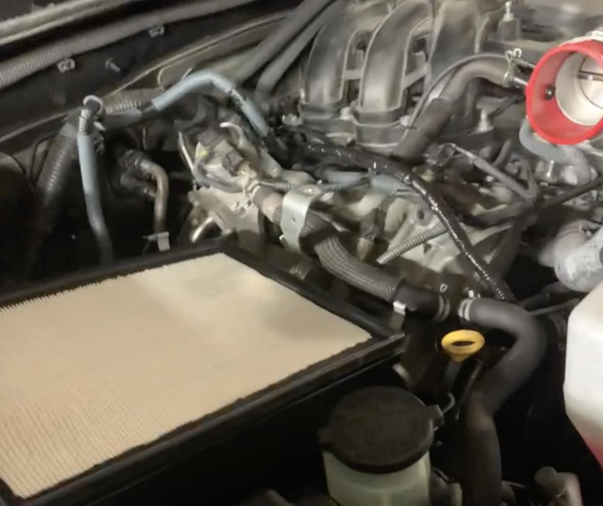

Did the TRD pro intake this morning taking my time and it was a simple install. Took about a hour of work if prepared and following instructions.
Toughest part was couplers from intake box to tube. I didnt buy the URD MAF wiring extension, that could've save 10-15 minutes. The wiring isn't difficult just be careful and take your time. Initial restart of the car there was no stalling of it, it fired right up. There is a deeper growl now when hitting the gas above 3k RPM.
