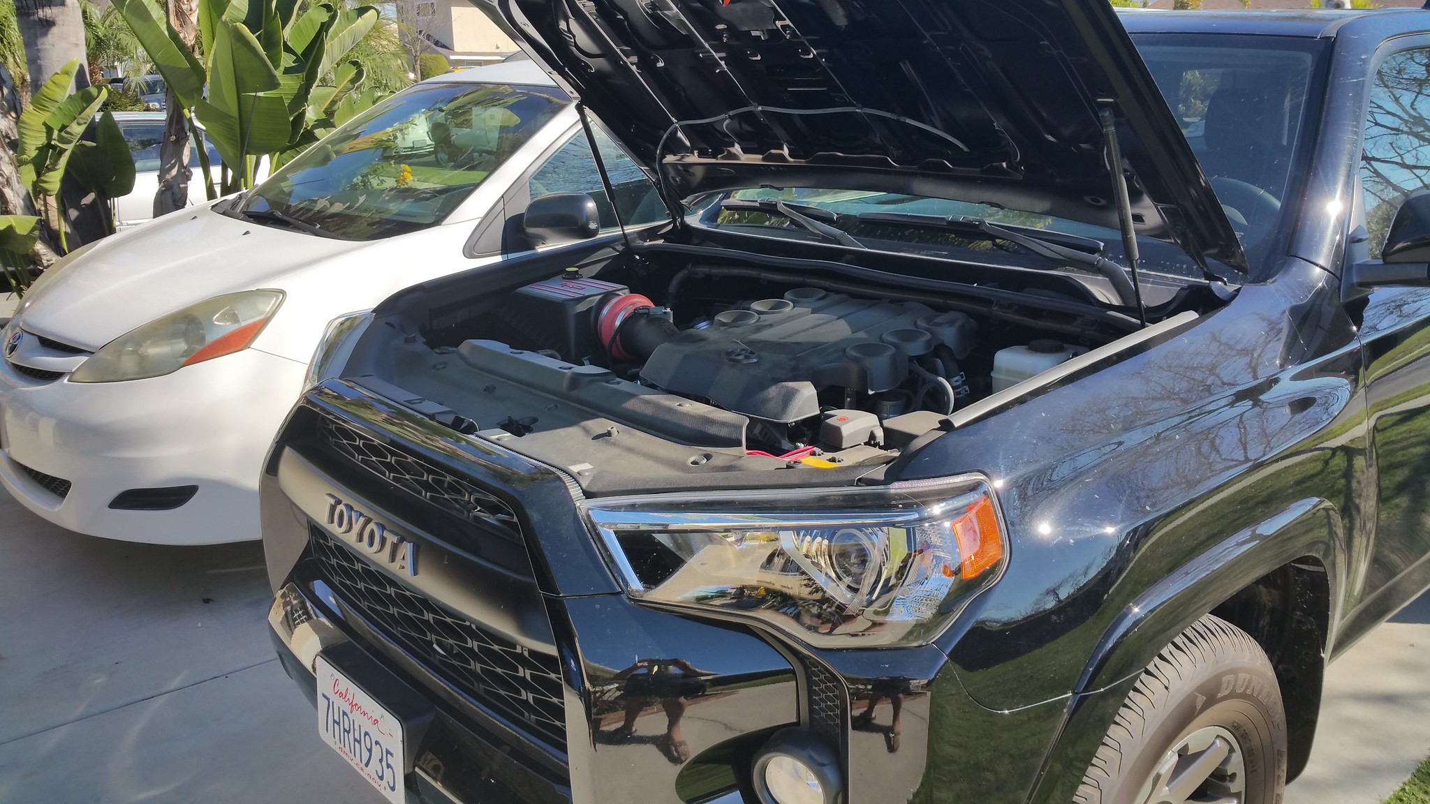

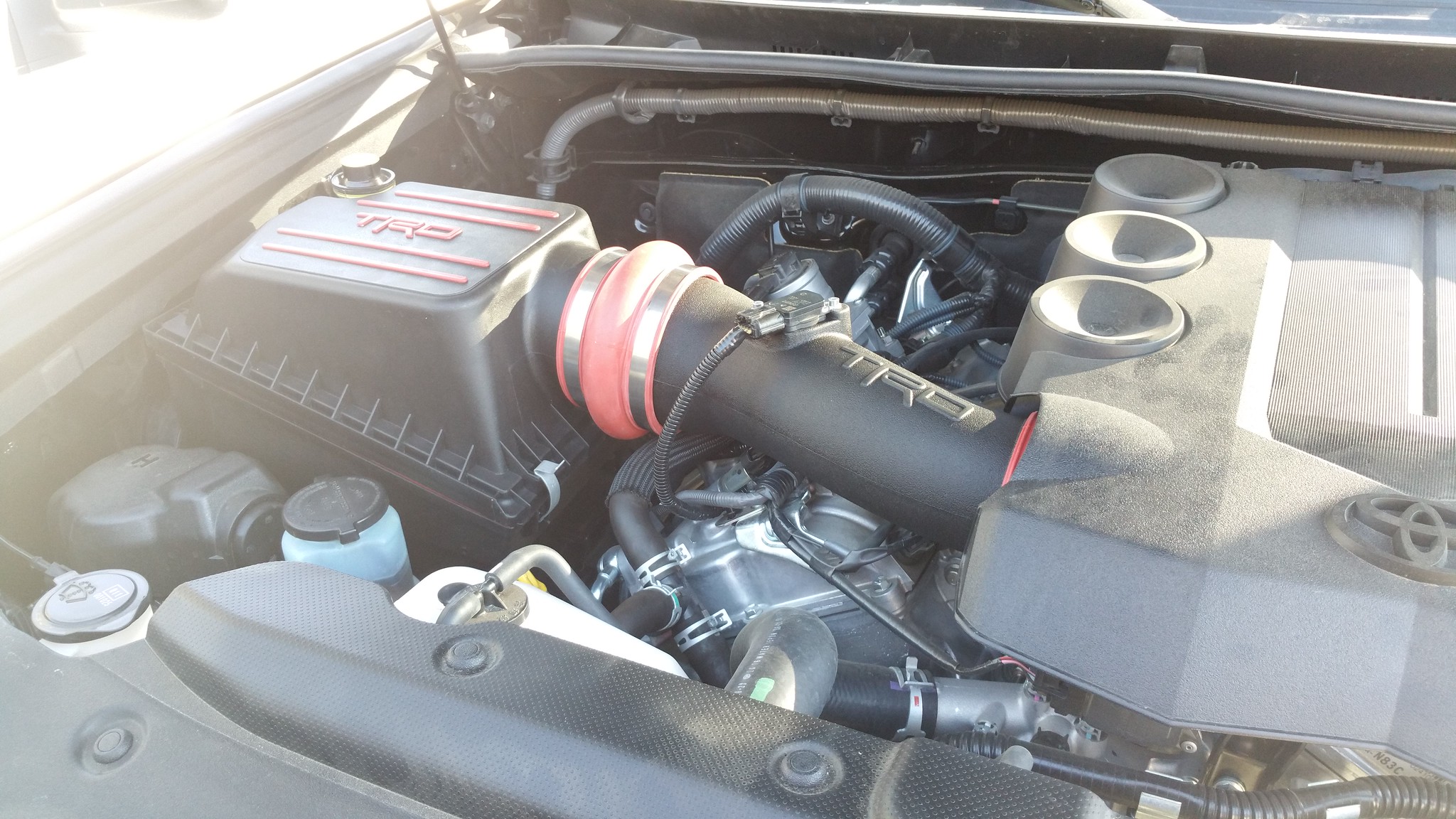

Done!!!
Everything fit except didnt use the tree mount zip ties... ohh I forgot ... The 3rd M8 bolt required a spacer on mine to fully bolt down the bottom half of the intake box. I just used a small/slim 14mm bolt.

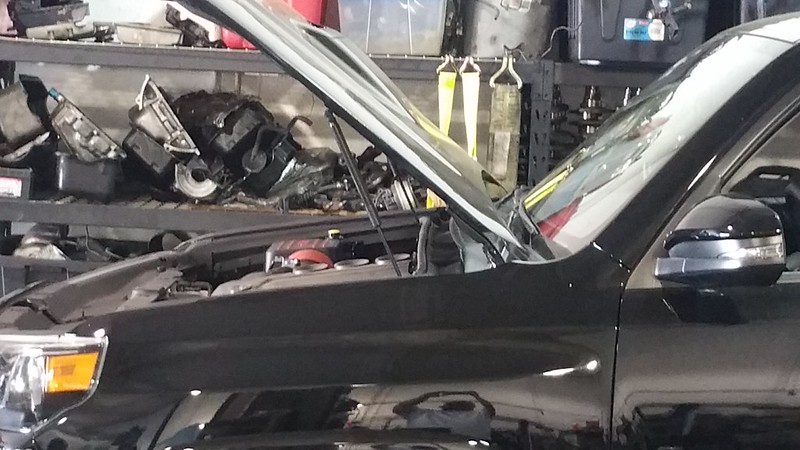

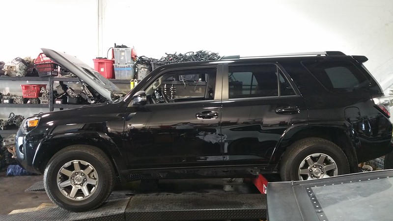

Let do an update ... I couldnt help myself. The 4Runner drove soo much better now than stock. Curiosity kill the cat; shall we say ...
Very nice! Thanks for taking the effort to do this. A few questions though, did you take note of the different environmental conditions during each run? Temp, humidity, fuel type, fans blowing on the vehicle? These can have a significant effect on the results since the runs were done on different days.
That torque curve is very nice. The area under the curve is great too. about 20TQ and 10HP at 4K RPM is impressive.
very nice! Thanks for taking the effort to do this. A few questions though, did you take note of the different environmental conditions during each run? Temp, humidity, fuel type, fans blowing on the vehicle? These can have a significant effect on the results since the runs were done on different days.
That torque curve is very nice. The area under the curve is great too. About 20tq and 10hp at 4k rpm is impressive.
stock run
TEMP - 77°
Humidity - No didnt take this into account
FUEL - 87octane
FANS - Yes never dyno'ed without fans on car
TRD run
TEMP - 70°
FUEL - 87octane
