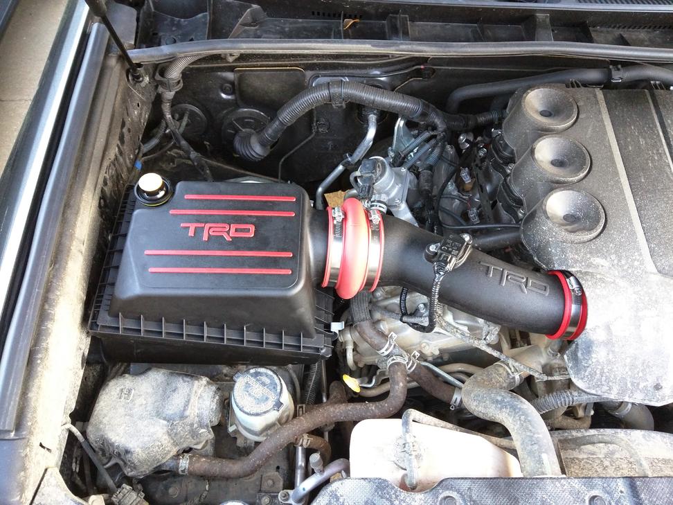

OK, just installed it on my 2015 Trail Premium.
A couple notes:
1) Thanks to the OP for the pictures. They helped a ton!
2) The '15 is a little different, which is probably why they don't sell it for the 15:
- The instructions call for a specific way of re-securing the existing wiring harness via some snap-in zip ties. The holes for the zip ties aren't there on a 15 because of the lovely air pump we have and its associates machinery
I think that was the only complication. I spent the most time ensuring I had the MAF wiring routed out of the main harness in a way where it wouldn't chaff/bind/wear over time. I think it ended up OK, but I'm always wary of messing w/factory wiring.
A pretty straightforward project. Took it out for a quick trip to ensure there weren't any check-engine light issues or weird noises. The only new noise is some really nice intake roar from 3krpm and up. Sounds good. Louder than I expected, but good.
One thing that worries me is the loss of the intake resonators -- the heimholz resonators. Those buggers are not only to quiet intake noise, but they are also about timing intake pulses to increase power and torque. I don't care about the noise, but I'm going to be watching low-rpm torque carefully. I don't want to sacrifice that in this truck because of how incredibly eco-aggressive the tranny is. Seems I'm always @ 1krpm
Cheers
Agreed. The only differences are securing the cables with the zip ties. Mine still looks clean and I only used two zip ties rather than the 6 or so that were provided. This was installed on a 2015 Trail Premium, btw.
