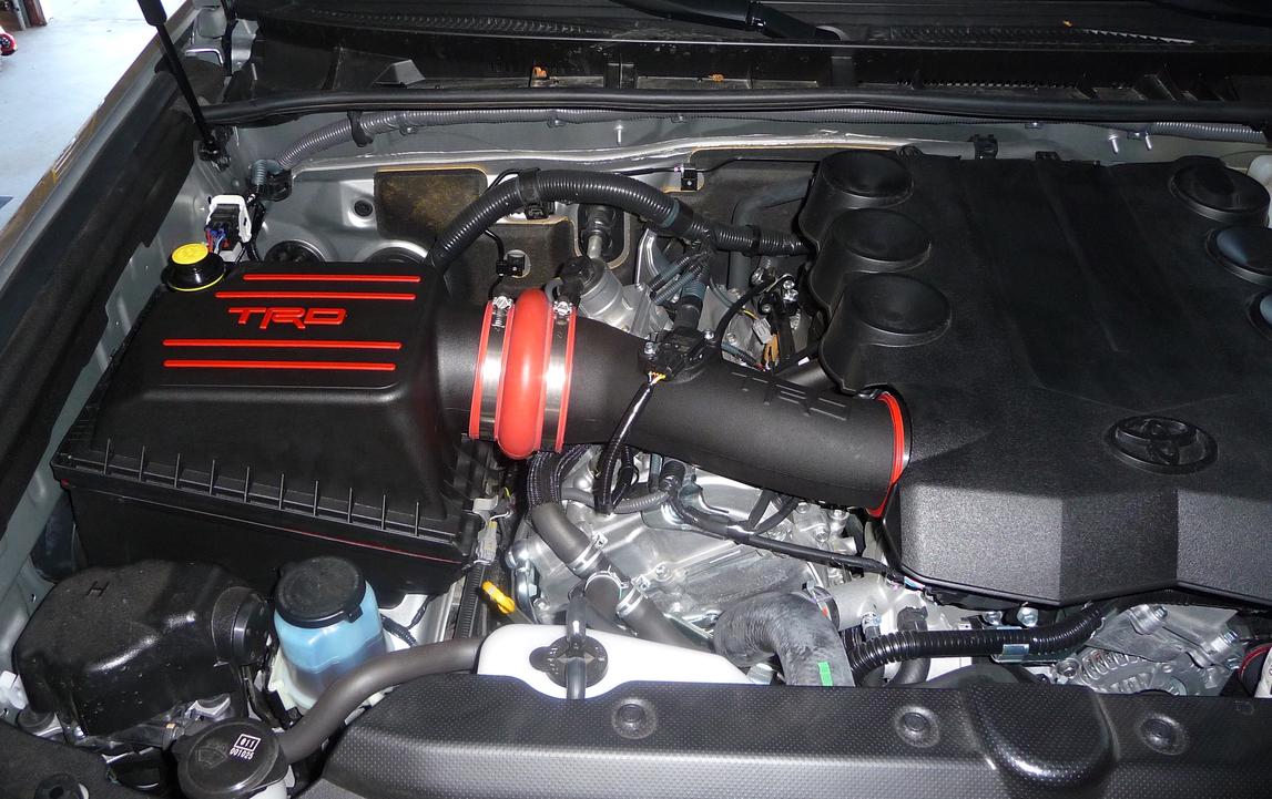

I received mine and installed it today.

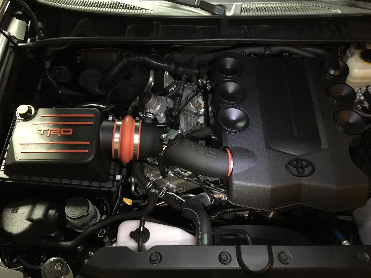

I did mine last week also, was complete in 2-hours time, i did it my way, its funny how everywhere you read it says it wont fit the GEN-5 4runner,but it does perfectly. Every aspect and every screw and strap fits perfectly. I like the sound at WOT. Plus it loks cool and it was a reason to hide in the garage for a couple hrs. I cant figure out how to rotate my piucs, i suck at computers. Also i did this on my 2016-TRD-Pro

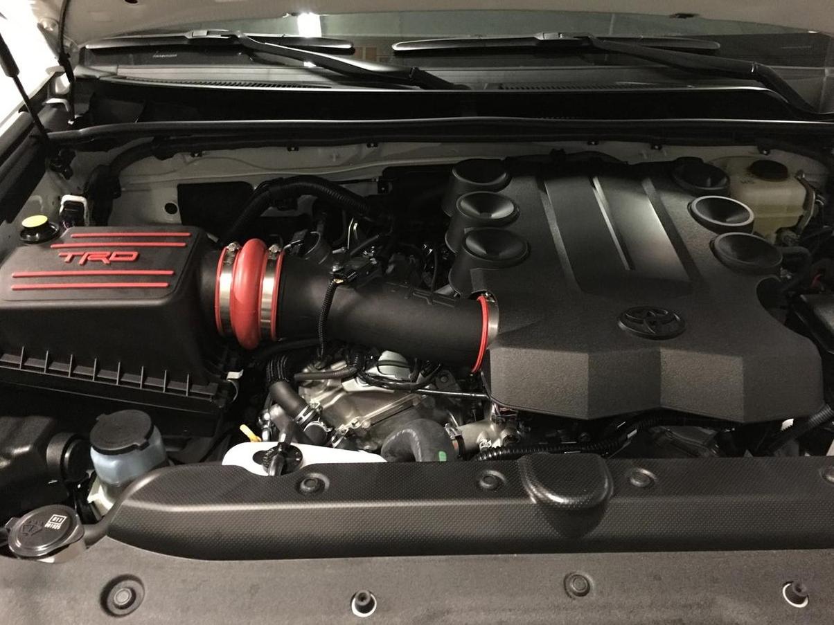

Biggest thing about this was the fact that I got it for almost half of normal cost by ordering individual parts thanks to you guys. All you have to do is get some hose and convoluted wire covers. I still need to get the wire tightened up a little.
[MENTION=135616]991-GT3MJK[/MENTION],
I fixed it for you, cause it was hurting my head to look at it! :D

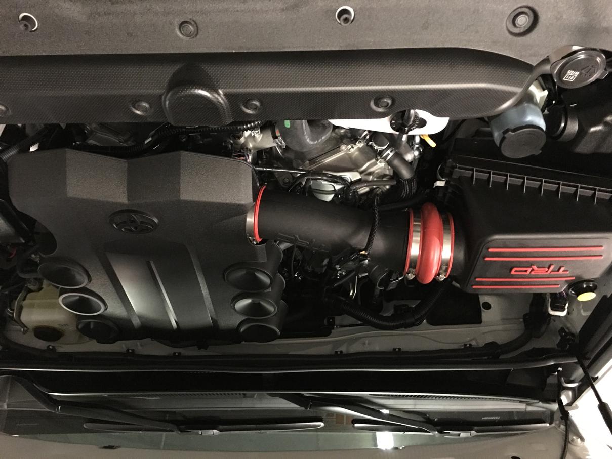

Completed the install on the 2016.
Installation notes:
1) the wiring harness had a ton of factory tape - took the better part of an hour to remove and re-tape.
2) I couldn't find the hole for the zip-tie "tree-mount" for the vacuum hose, so I just zip-tied the vacuum hose to the vent hose (loosely).
3) the "air flow accelerator" fits loosely in the the fender hole making it difficult to connect the lower air-box. There's also very little room to see if the connection is good. Stick a hand through the air-box hole, grab the air flow accelerator, and push/pull to get them to connect.
4) connecting the intake tube to both the air-box and the throttle-body is a bit of a wrestling match. Silicone spray is your friend.
5) after completing the install and starting the engine, the engine immediately shut off. A second attempt (and since) worked fine.

Nice post! Mine did the same thing in (5) I am glad that it wasn't just mine that did it.
