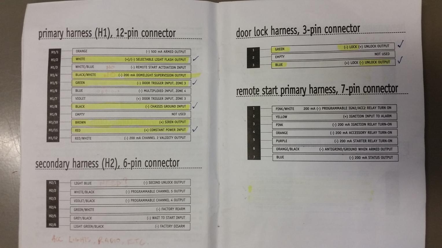

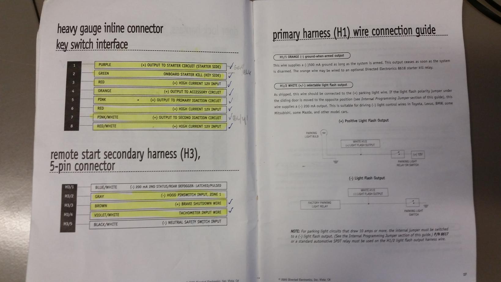

I found my book...here are the things I connected to for my system alarm and remote start. Everything that is highlighted and has a checkmark was connected, plus H3/5 Neutral Safety Switch.
This was for a 791XV, but it would be similar to your install.
Anything else is going to be up to you to decide if you want that option.
