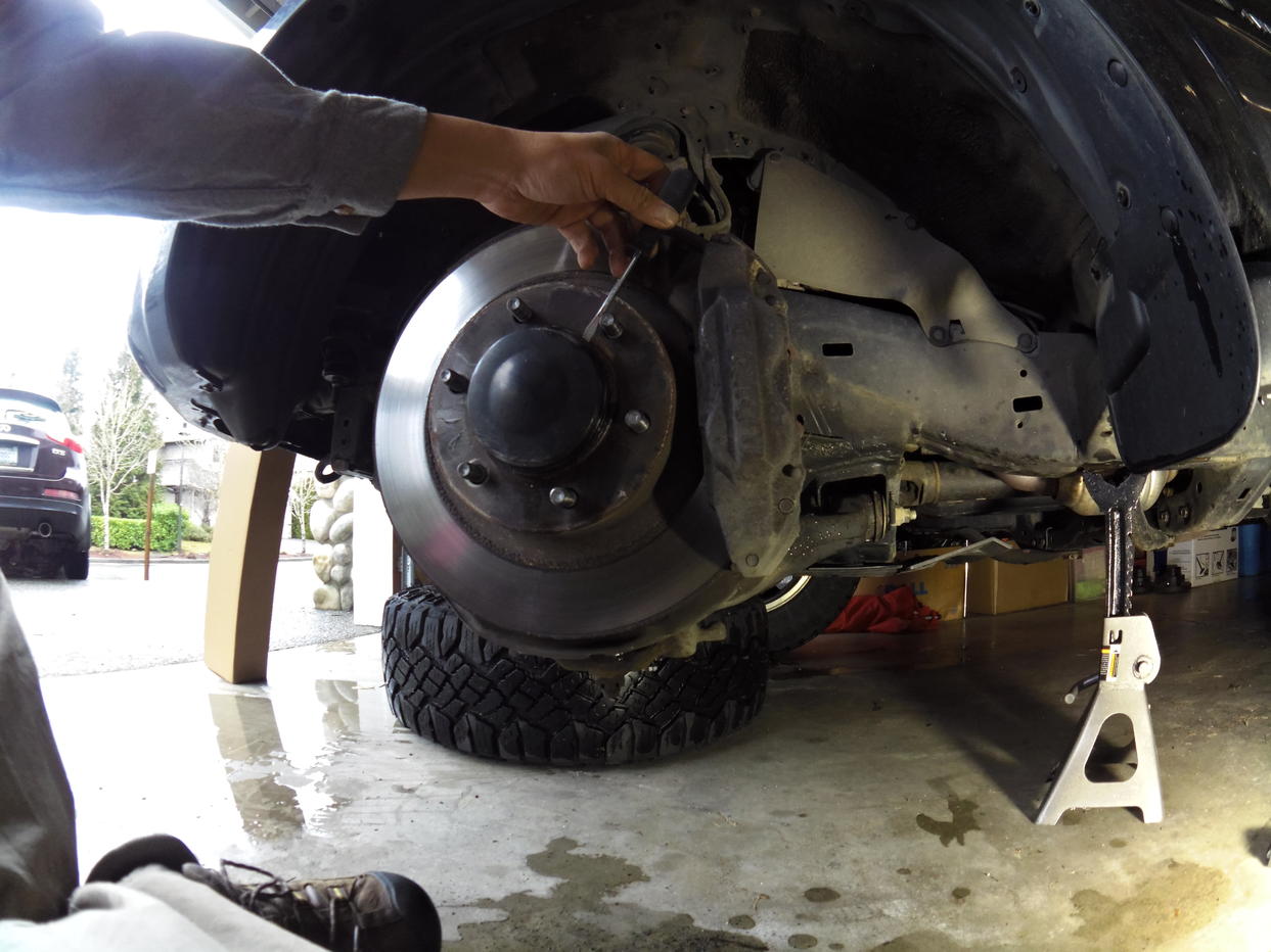

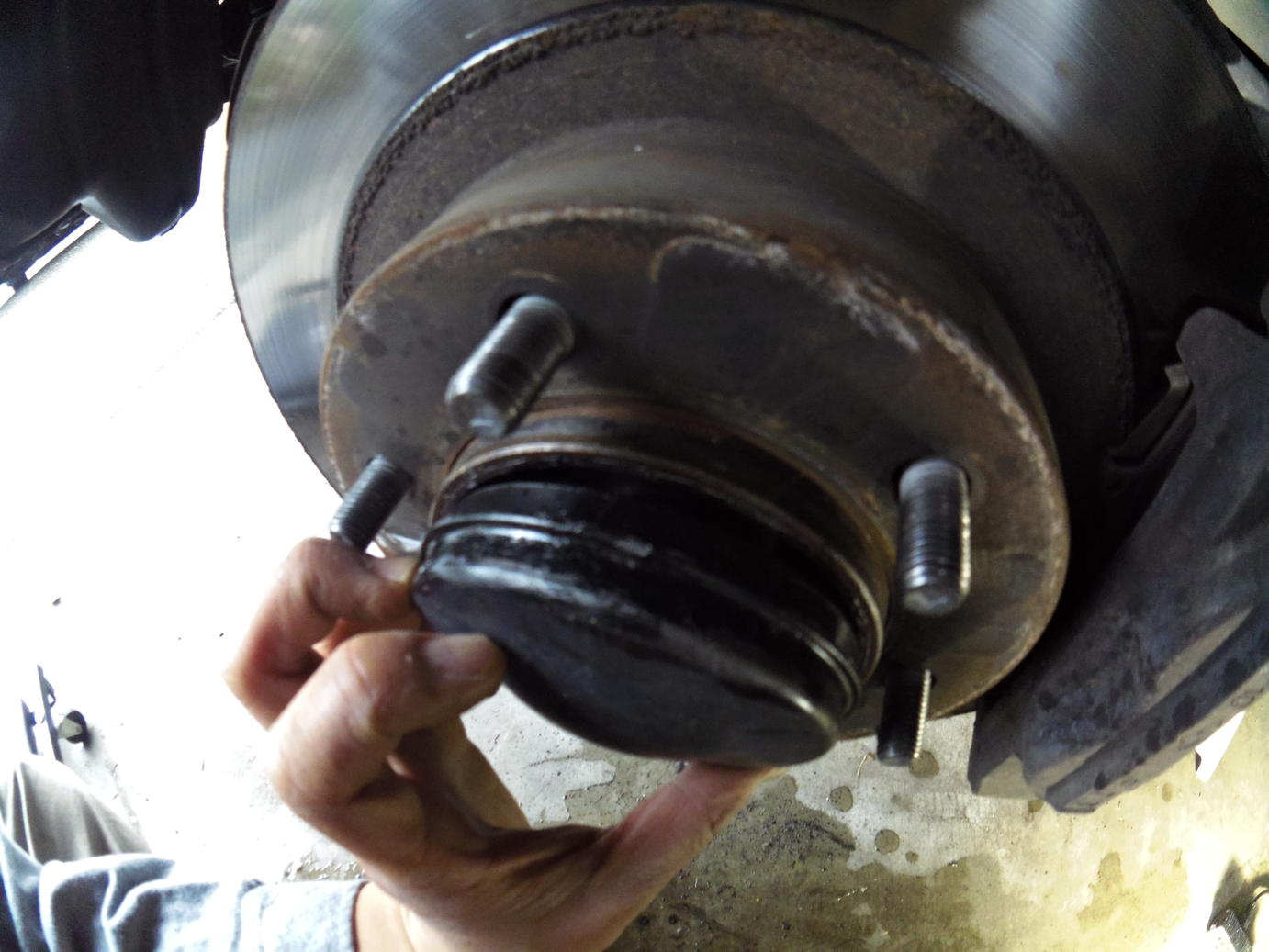

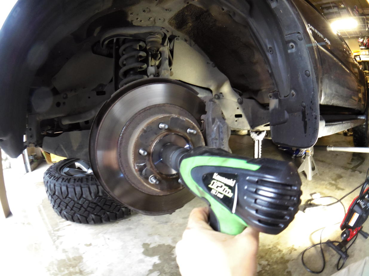

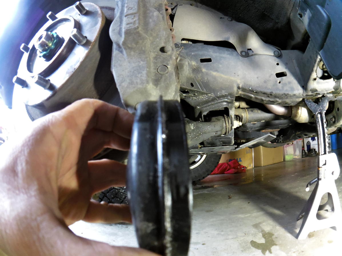

Thanks and a couple of tips that I learned
I just finished installing a new axle and thought I would share what I learned (trying to contribute)
  • Removing the dust cap takes time. Don't expect to pop it out immediately. Start with a thn flat screw driver.Don't give up.
  • Removing the old axle can be PIA. It helps if your buddy can pry out together. Never give up :)
  • 35mm socket is not sold at Sears. I bought it from NAPA.
Thanks everyone for sharing how-tos.
Some pictures to help folks understand how this cap is fit. Also, I've used this 12v Kawasaki Impact Wrench to remove nuts. I've had it for many years so far it's been absolutely great.
