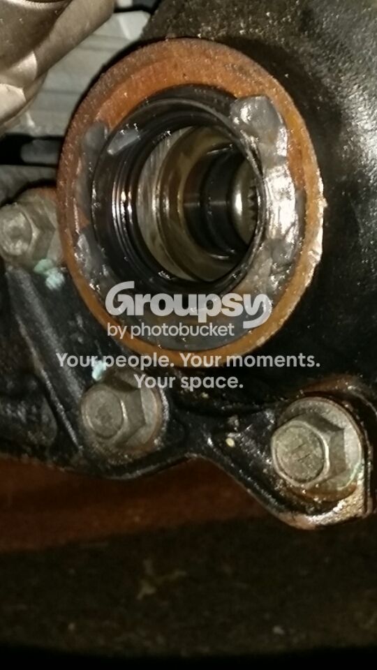

Thanks to this awesome thread I was able to complete my driver's side CV drive shaft tonight. It had been leaking from the oil seal at the diff.
I only had the truck for a little over 2 weeks, so I am working through some things I missed when buying it (leaking xreas, and bad diff seal)... and the wife isn't pleased... so lets hope this is it for a while! (knocking on wood)
My t4r is a 2006 sport edition v8 with about 60k on it.
Whelp... this is likely why I had the leak! Apparently someone has been in this CV axle before. After I finally got the axle out this is what I saw:

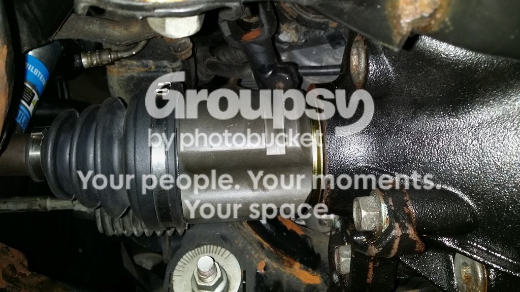

Also can someone please please please tell me this driver side Napa Maxdrive CV axle looks seated properly!?!?
20151014_235348_zpsxka0wxug.jpg~original
I spent a ton of time getting it in there, and I am pretty sure I had my new OEM Toyota oil seal properly placed, but it wanted to stop where it was. I have only had a chance to drive it a few miles but nothing is leaking so far! Although I hope I have enough gear oil in there. It was 11:30pm and I couldn't get the diff fill open for the life of me. That is another project I guess. I really didn't seem to loose hardly any fluid when doing this replacement though, but I know I have lost some from the previous leak.
an 06 with 60k is a true find. good for you. Anyway, there are bound to be thing to do on a used car. I think whoever sold you that car did that to the cv seal to hide the leak.
Wow. That sealer crap on the differential seal is really odd. Why would you go to the trouble of pulling the shaft and putting crap on the seal when you could have just replaced the seal in 10 minutes for less than $10? All of the actual work is in removing the axle and they obviously went at least that far. I'm from the Ozarks and am used to 'redneck engineering' but that's just dumb.
Also, yes, the axle looks seated properly.

Yeah... I really can't figure it out. To do ALL of that just to put some weird sealant on there. After doing the work myself, I can't imagine going through all of that and not just put a new seal in there! Maybe they didn't know about replacing the seal???
And thank you. I was pretty sure the it was seated right. Still not leaks on day two. But seeing that "gap" just made me nervous even still! I was dreading going back in there.
Thanks! I couldn't believe it, there were two sport V8s that popped up within 500 miles with under 65k on them. I missed out on one and ended up with this one.
I just can't believe they went through all that trouble to hide it! This is the first time I have done this repair, and I wouldn't be able to let myself do that much work just to hide it and not fix it! That thing was a PITA to get replaced!
