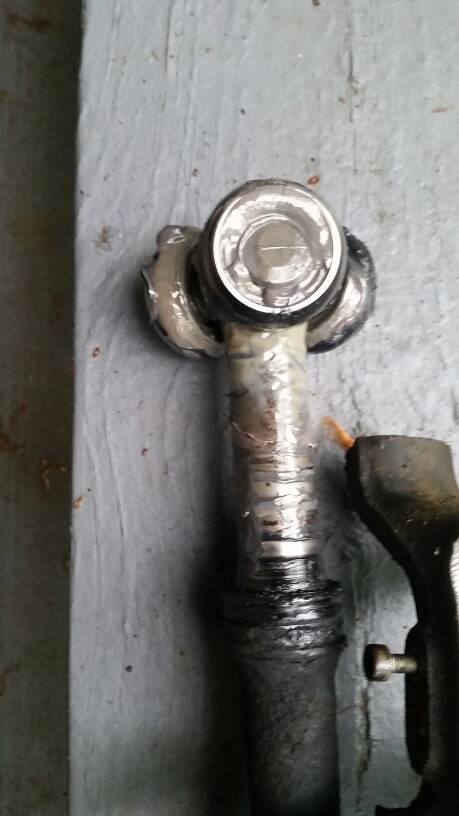

So my inner boots have been busted open for a while now and I just took the axle out. The grease on the inner side was very white and there was not much grease inside... most of it came out of the boot and from my neglect I kept driving with it like that for about 10k. Should i replace the axle due to the wear the inner joint probably sustained during this time? or should i just repack it and reinstall with new boots?
Here's a pic
I think the answer depends on mileage, whether you were having any issues/noises with the joint, how bad the boot tear was, driving conditions, and how long it has been this way. I can tell you from my experience, reman cv axles can be worse than your own OEM axles. Best option is buy new cv axles, but it a cost/risk decision. Rebuilding your self takes time to do properly. I would buy new or rebuild, but test and inspect your existing cv axle bearings after cleaning.
I have to disagree and rather strongly. Find someone that sells quality reman OEM axles. If they are inspected and reconditioned properly this is the way to go.
NAPA has fine reman axles and my local Toyota Dealships had the same reman axles as NAPA (some company) for 2x the price. If you want to be same get a good of micrometers and check the dimensions vs new and also check the spines and threads. For the price of a decent reman it's not worth the cost to repack and replace the boots, especially when replacing other misc. hardware.
If you are willing to use an aftermarket cv axle, then new is definitely the way to go. There is not much price different. NAPA in my area sells new for $81 (no core) and $62 for reman (after core). For $19 you don't have to worry about how good the rebuild was only to find out at home or the road it is worse than the originals you just pulled out!
