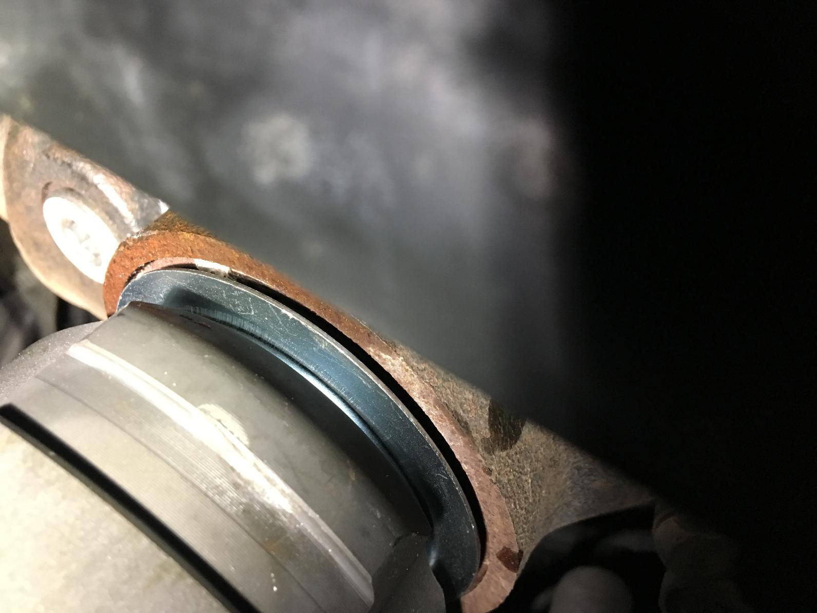

Hey guys so I finished the job today thanks to all you wonderful people. I drove around and no noises or anything weird. But after I drove it, i got out to check it out and noticed that the dust cover on the axle on the diff side, was not completely flush with the diff housing so o tried pushing it and it did the job but just curious for some other opinions. Also do you guys know if a little loss in diff fluid would affect rpms in any way?

...But after I drove it, i got out to check it out and noticed that the dust cover on the axle on the diff side, was not completely flush with the diff housing so I tried pushing it and it did the job but just curious for some other opinions. Also do you guys know if a little loss in diff fluid would affect rpms in any way?
If it's any consolation my '04 is the same way, there's a little bit of play that allows the axle to move in and out of the diff just a little. Fully pushed in, the outside of the dust cover is flush with the diff housing and if pulled outward it moves 1/8" - 3/16" and looks just your photo.
Not sure about the RPM / diff fluid level. I can't think of any reason the engine RPM would be affected unless the level was waaaay out of whack.
