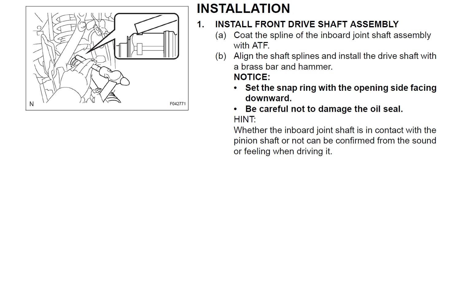

Me, I'll stick to applying impact forces to the FSM recommended spots, which are the machined grooves on the inner housing.
From the FSM...

Maybe we're saying the same thing a different way, but this might be your issue. The opening in the C-clip should be on the bottom of the axle. This lets the meat of the "C" stay tighter to the axle due to gravity pulling it down in the groove. The smaller profile of the C-clip in turn means less resistance going in.
#2, did you lube the splines before inserting into the diff per the FSM?
For me, it was just a couple of light taps using a pry bar on the inner housing notches as shown in the FSM.
From the FSM...
From the FSM...
