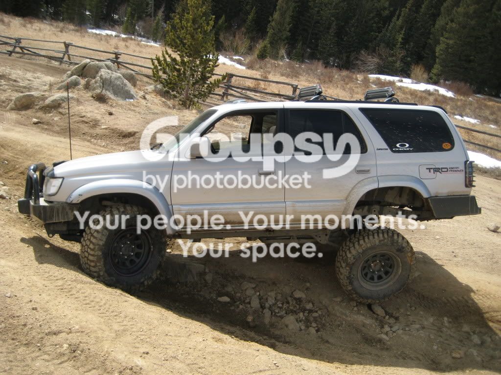

The limited flares on a Sr5 are going to look goofy unless you put the limited siding on the doors as well because the flares are tied in with those. Was that your plan? If you get the sr5 flares it will look fine, just like LINY's.
IMG_1691.jpg~original
My SR5 4runner came with the limitied style flares and I don't think it looks goofy.
