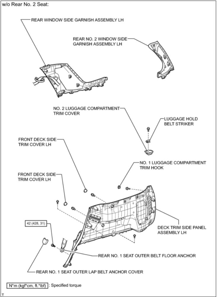

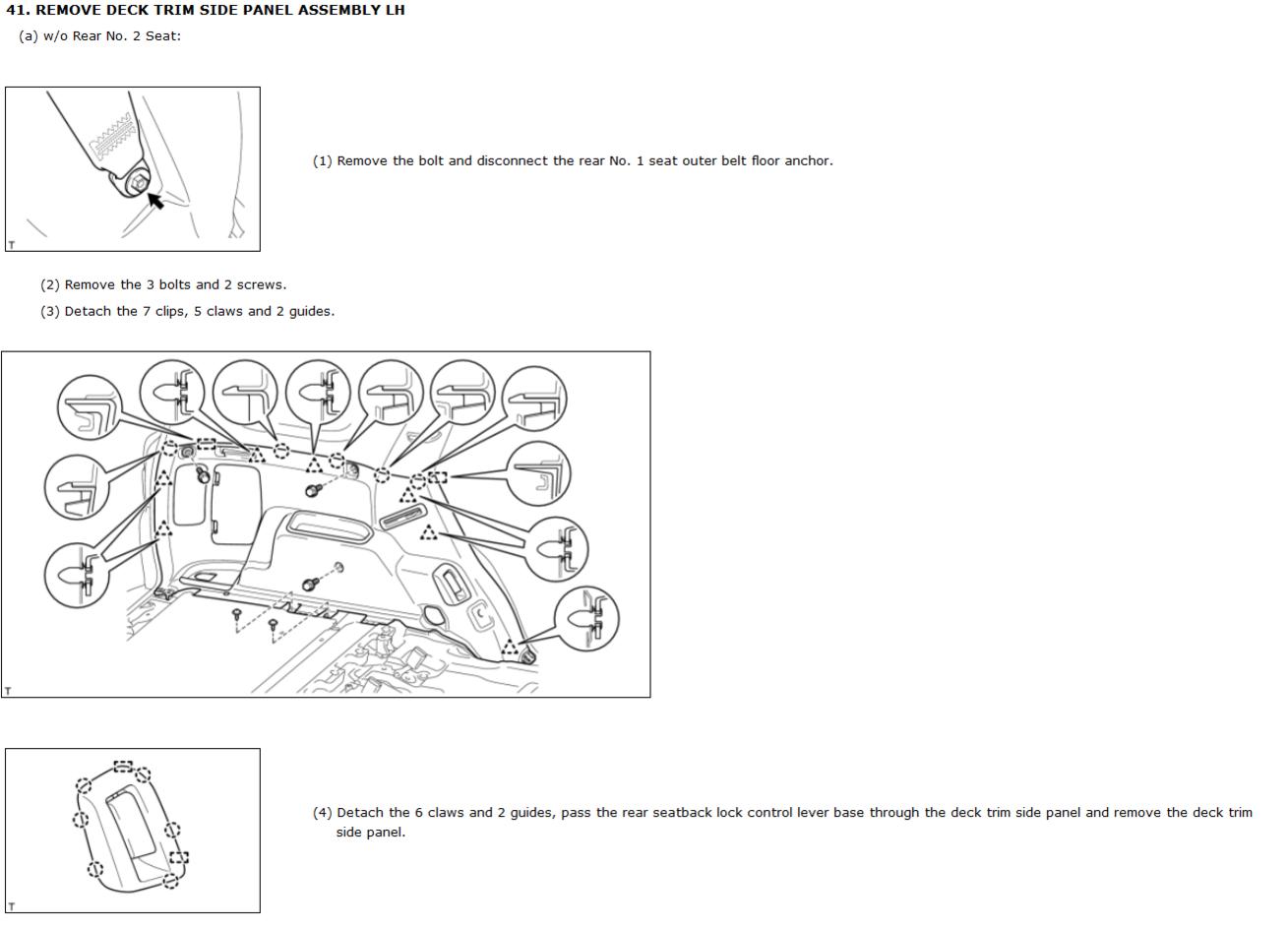

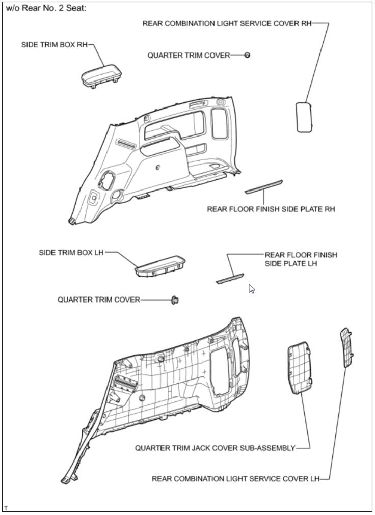

This is what I see in the manual, but really I do not understand that. Anyone can decipher it for me?
Anybody? With all clips holding this thing what is the correct order and pull direction to not break anything? :help:
You will break clips, that is a given. Unless you find a screw or bolt holding a panel then the proper method is to pull firmly. Once you take one panel off then you will understand. My advice is to go get a bunch of new clips because, even though you won't break a majority of them, just by the action of removing a clip, will stretch them a bit and might not be as good as before when you reinstall them.

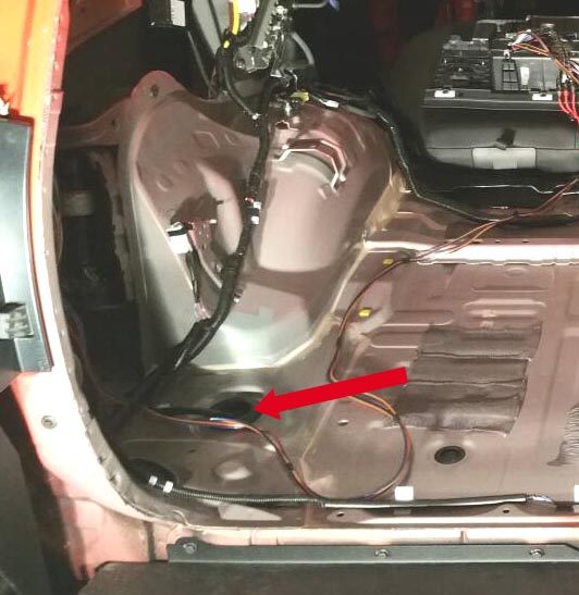

See the rubber grommet in the back there (your red arrow in the pic)?
Get a metal fish, tape your wiring to it, grease the wire/tape lightly and push it through the rubber grommet. It will self-seal good enough to keep water out.

I've done this or something similar on my last two 4Runner's and Tacoma. Going through the firewall is the hardest part. Running the cables lengthwise is relatively easy, just pull up the door trim panels and feed it through the pillar between the front and rear seats. I'm unsure of what you're hooking up, but I've got a fuse box mounted in back with 4awg marine cable powering it. I also have a 4awg grounding cable going from the fuse box, through that rubber grommet in the back, and to the frame. What I did was unbolt the cargo tie-down, that way you can access the grommet. I then drilled a hole in the plastic cover for the cargo tie down for the grounding cable to run through. I can take pictures later.
Either way, just unbolt that cargo tie down and you'll be able to access the grommet. You'll probably need a coat hanger or something to feed whatever wire you're running through.

Second step is to remove all bolts and screws holding the side panel.
1. There are two screws holding the panel to the floor (at the wheel well). Philips screwdriver take them out (Ref.7).
2. One bolt is under the rear upper tie down (plastic hook looking like a T). First turn the "T" clockwise 90 degrees. After that it will pop out exposing bolt under it. This is long bolt with Philips head. Take it out.
3. Two bolts are under the round plastic cover. One is on the side of the wheel well, the other is on the all in recessed plastic (Ref.8). First remove the round plug. It has a slot at the bottom. I have a screwdriver with the end bent 90 degrees. Pull the round cover by the bottom where the slot is. It easy pops out exposing 10mm hex head bolt. Remove both.
4. Finally the rear sit belt anchor. Remove the plastic cover - spread it from both sides and it will be easy to remove it exposing 14mm hex head bolt. Undo the bolt but remember how the sit belt is oriented so you don't twist it when installing back.

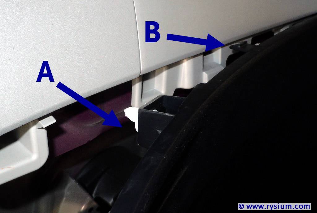

Now all clips. This is very intimidating part. Some clips release easy some require a little force. It will be easier if you remove tire changing tools cover and plastic cover to access tail lights. This way you can put your hand under the plastic and pull it from behind.
Work slowly from the rear to the front (Ref.A). When you try to pull the black plastic and you see the upper trim is following, there is a hook in the bottom part grabbing the upper part (Ref.B). Use the trim tool to unhook these two parts.

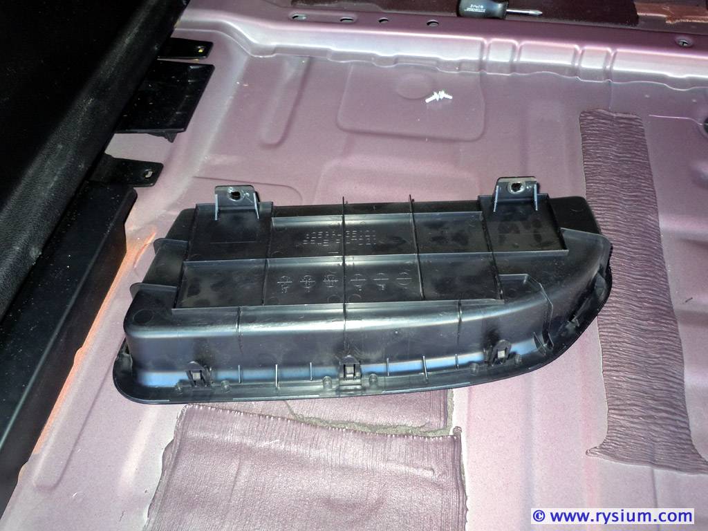

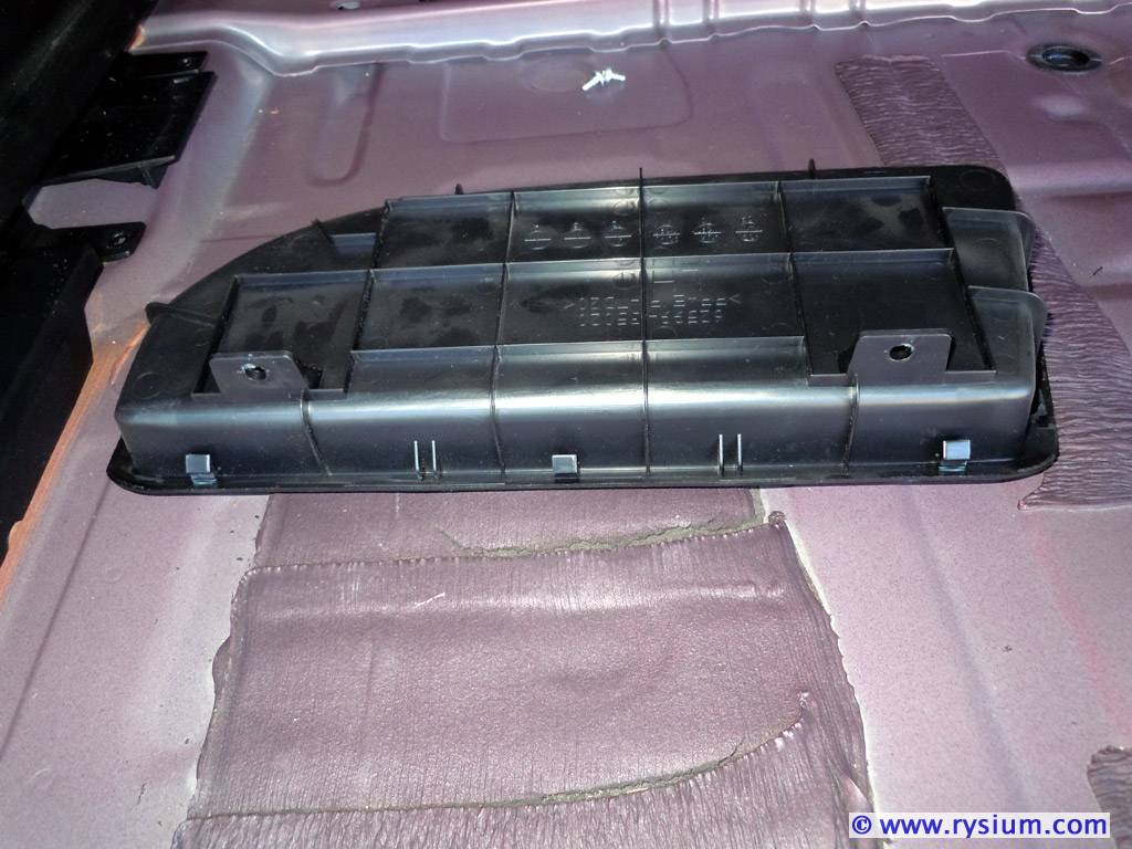

At some point I had the rear side of this panel away from the metal that I could put my hand behind and using short philips screwdriver and remove two screws holding the "tray" on the wheel well cover. When these two screws are removed there is no need for "brute force" to remove the tray.
When trey is out you have more access to behind the panel which will help with pulling clips at the front part of the trim.
I did not take the whole panel out - three front clips were very stubborn: one near the bottom of the door opening and two near the door around the rear sit back "hook". I did not need that as like Antman I could access behind this panel after partially removing the rear door weatherstripping.
When I was installing everything back I did not put these two screws to "tray". As you can see on the picture below the tray has small hooks all the way around so I thought these two screws are just overkill. This way I have easy access to the space under the tray (like Antman did, just without breaking tabs).

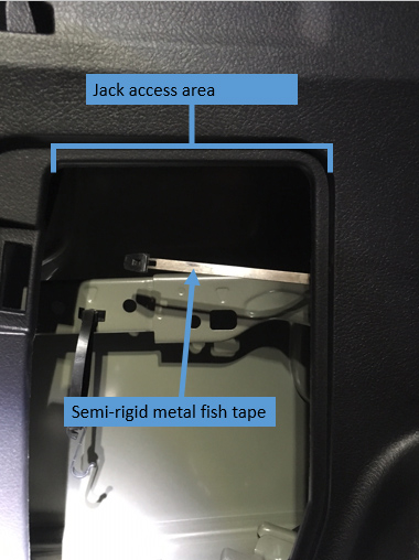

Step 1: Remove the plastic step panel at the bottom edge of the driver's side rear door.

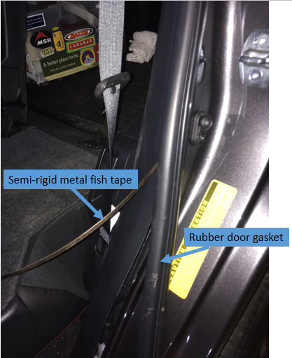

Step 2: Pull back the rubber door seal gasket. This will reveal a little space between rear plastic trim panel. See picture 1 below.
Step 3: Insert a semi-rigid metal fish tape into that space (also in picture 1). It will run into the rear wheel well space that everyone takes apart to get more storage. I didn't want to remove the little cubby that is there (the one shown in the last few pictures of post #16 of this thread) because I didn't want to break anything as mentioned by others earlier in this thread. Keep pushing the fish tape. It will eventually appear in the jack/tool access area just behind the rear wheel well (picture 2). You might have to stick your hand in the jack access area and feel around for the fish tape so you can grab it and pull it through.
Step 4: Tape your wires to the end of the metal fish tape.
Step 5: Pull the wires through the jack area, through the wheel well, and out of the rear door gasket gap.
Step 6: Run the wires to the front of the vehicle through the rear door step panel and the front door step panel.
Step 7: In the cargo area, remove the bolt that secures the tie-down hook. You can now reach under the cargo floor and access the rubber grommet that leads to the trailer wiring harness under the 4R. I taped the wires to a coat hanger and shoved it through the grommet.
