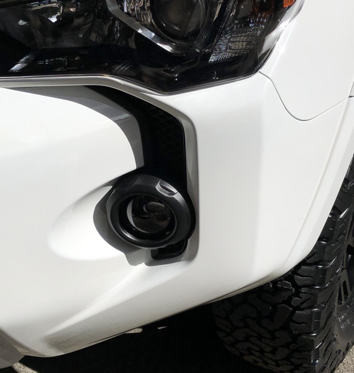

Nice write-up. I went with Morimoto XBs in true amber color. Had a hard time with removing old one on passenger side and decided to drop the bumper, much easier. I had to raise mine a lot. Both factory ones and new ones were way to low compared to heights shown on aiming procedure.
As someone else asked above did you have an issue with them fitting up correctly in the mounts, like a big gap. If I put the mounting feet into the slots I have a large gap. If I put them in front of the bracket and then put the screws they fit perfectly. Ran them last night but the beam pattern was very low and way off to the sides. Probably due to the way they are mounted. Working nights so I haven't had a chance to call HID Pros to ask about this yet.
I just installed the Morimoto XBs and ended up using the stock brackets. The brackets that come with the Morimotos is off by just enough that the inside tabs do not fully seat into the tabs on the bumper. Only thing I modded when using the stock brackets was to remove the plastic adjustment screw and replaced it with a longer M5 button head screw and a 1/2 nylon spacer to take up the space since the spring that came with the Morimotos was to short to create the tension needed.
Any issues with a gap from lens to housing frame?
Yes, it is not even but it doesn't bother me that much. I did notice Morimoto mounting tabs are a bit bigger and thicker, this is what cause the gap around to be uneven. I may try to shave them a bit down the road. I was thinking about reusing brackets from original fogs but decided to mount them as they came.
I remounted my Morimotos today by modifying the feet that slip into the factory slots. HID Kit Pros actually sent me a link on the forum on how to do it. Basically just grind down the outside edges of the feet about 1/8" on each side and they slipped right in. They fit much nicer now. They still have some gap between the lenses and the trim but it's at least even and my OCD self should be able to live with it. I'm working nights so I'll be able to tell this morning when I leave if the beam pattern has improved. I'm sure it has since they are centered in the opening now.
I didn't really have any. I had to adjust the angle of the bracket a little to screw the two mounting screws in, but other than that, there wasn't really an issue
LOL We were posting at the same time. If you read my above post I got my fitment issues resolved. Thanks.
