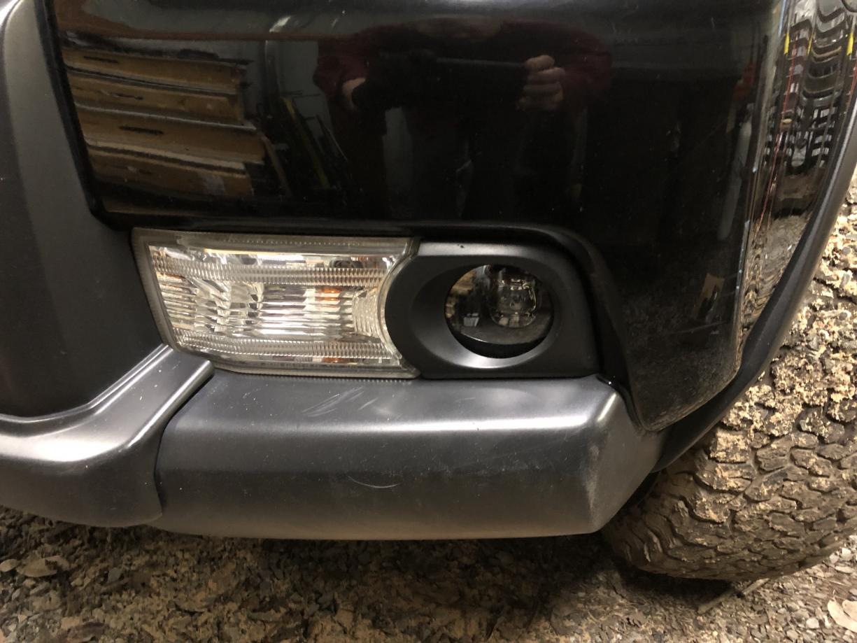

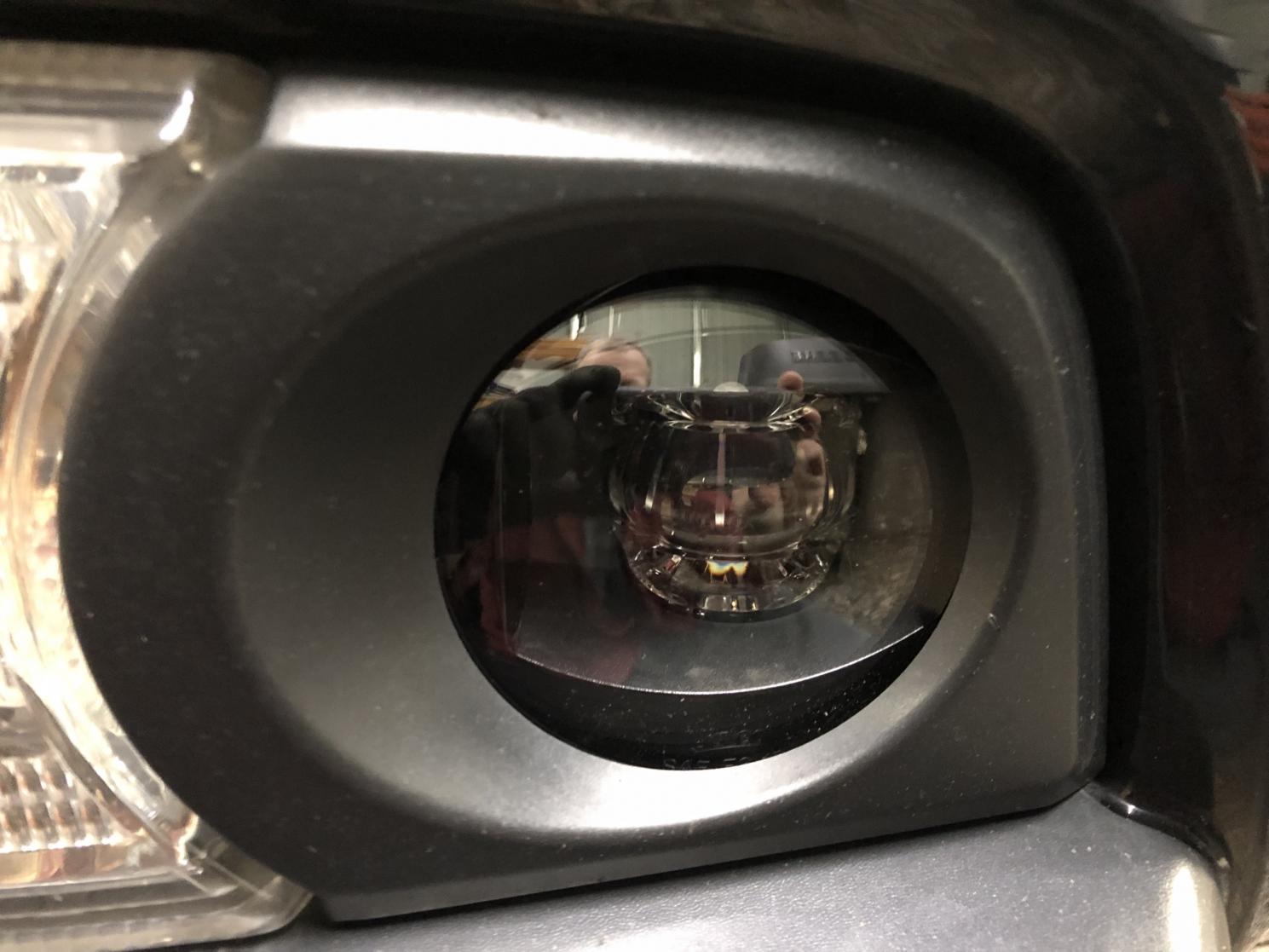

I ended up ordering the chrome ones. They just arrived. This is what they look like.
I can confirm that these will fit a 2011 Trail. (Not perfect fit but they fit close enough)
Probably the same for all 2010-2012 models before the snout change.
I can confirm that this can also be done WITHOUT removing any part of the fender liner, reaching up from underneath.
I can confirm total install time of 30 minutes or less which includes taking 12 before/after/comparison pictures.
Your mileage may very on this depending on your mad skillz...
Tools needed one (1) short Phillips Head screw driver. These are held in place with 1, yes ONE 3/4" long Phillips screw on the outside edge.
The 2 tabs on the inner edge tuck into the bumper plastics.
They are made very similar to the original fog housings, but just a tad different angle, so you might need to wedge them in a little bit to get them in place.
Front glass doesn't fit as close to bumper plastics due to the slightly different angle, but no one will notice but you.

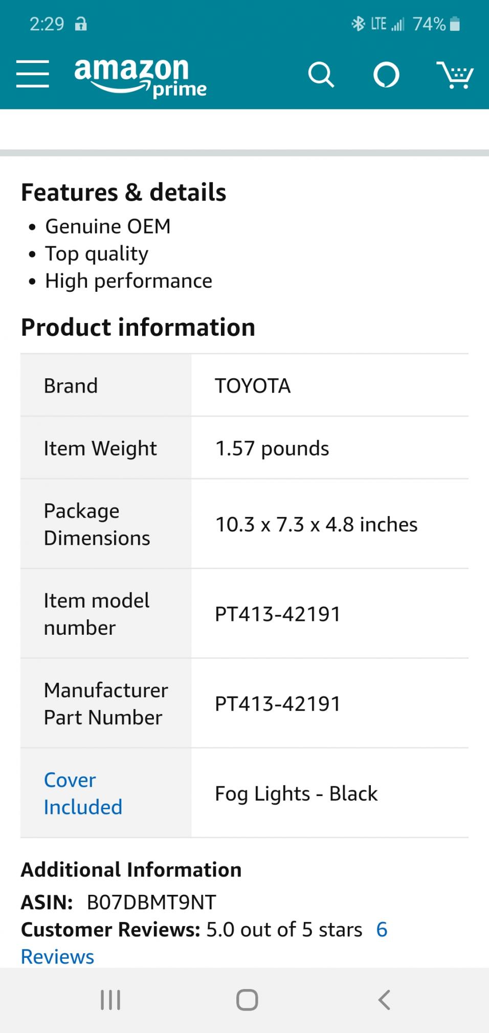

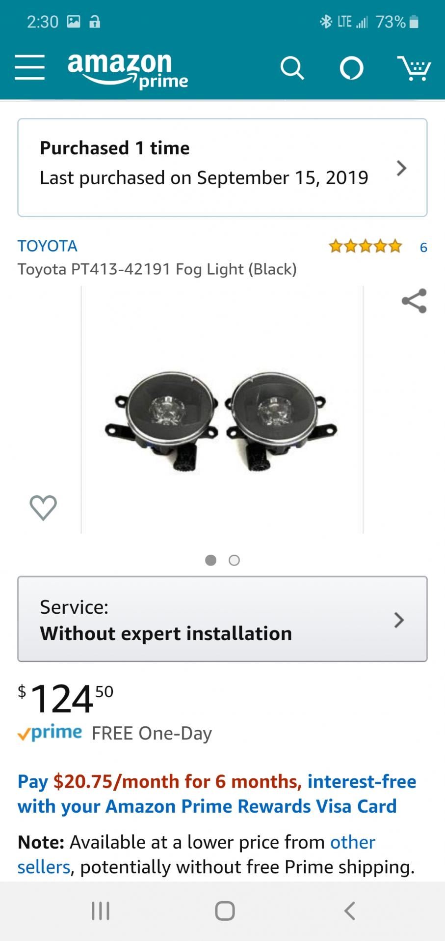

Unfortunately, the LED fog lamps in your Amazon link are not OEM Toyota. They are aftermarket replacement parts made by Brock Supply.
Amazon sells OEM. Dealers run sales around holidays for 90 bucks, I didn't want to wait
Those aren't OEM. You won't get as good light with those.

I should have known that price was too good to be true. They will be returned. Now I need to decide if I want to pay the high price for the real Japanese lights, or go with Xenon Depot Xtreme LED pros. These are the two options I was considering.

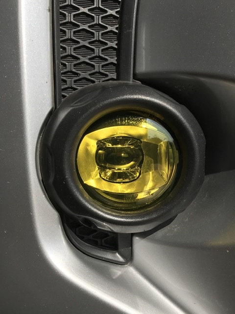

For my 18 ORP I got the Toyota OEM LED foglights from Amazon, PT413-42190 Fog Light (Chrome). They look like the ones pictured in post #42. Before installing I applied yellow lamin-x, purchased directly from the manufacturer, sku:T147. It’s a little larger than the lamin-x covers for 4Runner and fits these light perfectly. The fogs and lamin-x both were described as intended for Tundra.
