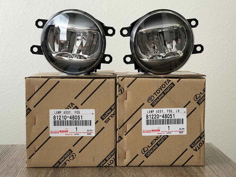

After taking way more time than it should have, I have mine installed. I thought I'd share what I learned and the steps it takes.
I really like them. Great cutoff and noticeably brighter than the stock incandescent fog lamps. Plus, being OEM parts, they are SAE compliant.

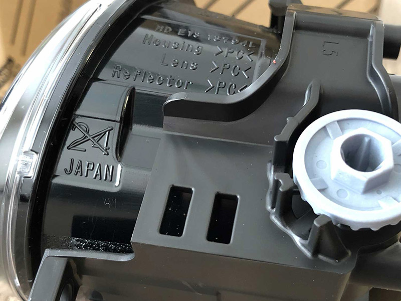

It appears you can buy a kit (made in China) in chrome or black, or individual replacement parts (made in Japan). It looks like the Japanese ones are original equipment on 2016-2018 Land Cruiser, 2015-2018 Prius C, and 2018 Tundra. While they cost significantly more, I installed the individual, made in Japan ones. I paid $284 total from an online Toyota parts dealer for both lamps.
Also worth noting: the kit ones are not the same design as the individual Japanese ones. They are not simply a cheaper version that are produced in China. The design is noticeably different. Nonetheless, you have a few options for OEM LED fog lamps.

81220-48051 (Left) - Made in Japan
81210-48051 (Right) - Made in Japan

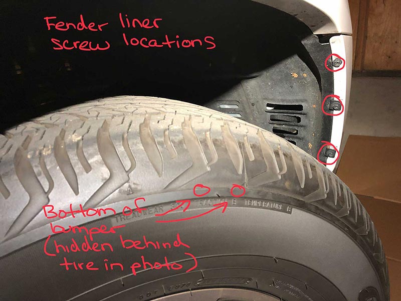

  1. Partially remove the right front fender liner. Do this by removing two bottom front screws (bottom of bumper) and the three front fender liner screws. Then bend the fender liner back to gain additional access to the fog lamp. Keep track of which screws go where!

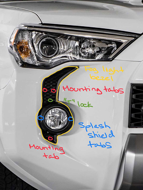

  2. Partially remove the right fog lamp bezel.

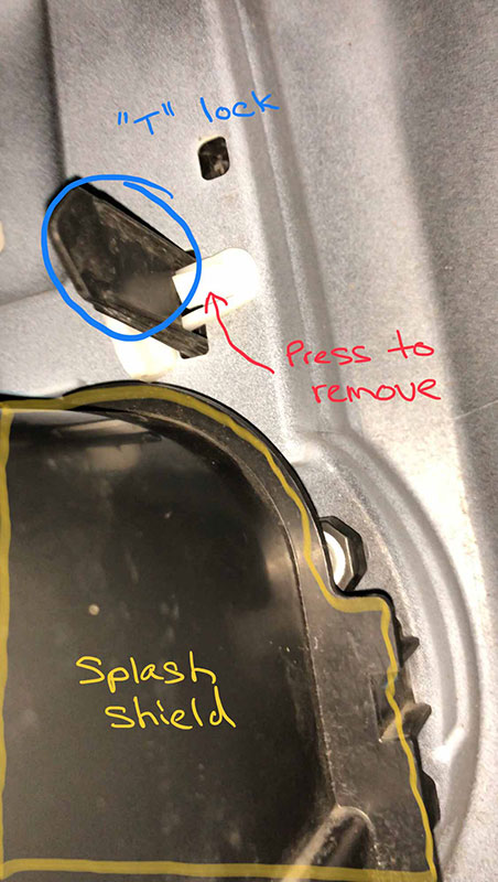

  3. Reach up behind the bumper and remove the white “T” lock from the large mounting tab above the fog lamp splash shield. It removes by pressing on the release button and sliding it to the left (toward driver side).
  4. Next, release the two upper mounting tabs (above the “T” lock) and one lower mounting tab by squeezing the release tabs. The fifth, very top mounting tab is inaccessible, but that’s okay.
  5. From the front of the bumper, carefully bend the fog lamp bezel back and up, exposing the fog lamp splash shield mounting tabs. It will remain attached at the very top.
  6. With the fog lamp bezel now allowing access, there are two mounting tab release buttons directly to the right and left of the fog lamp. Press in on the mounting tabs to release and remove the fog lamp splash shield. The splash shield must pivot upward to separate the upper tab from the bumper.

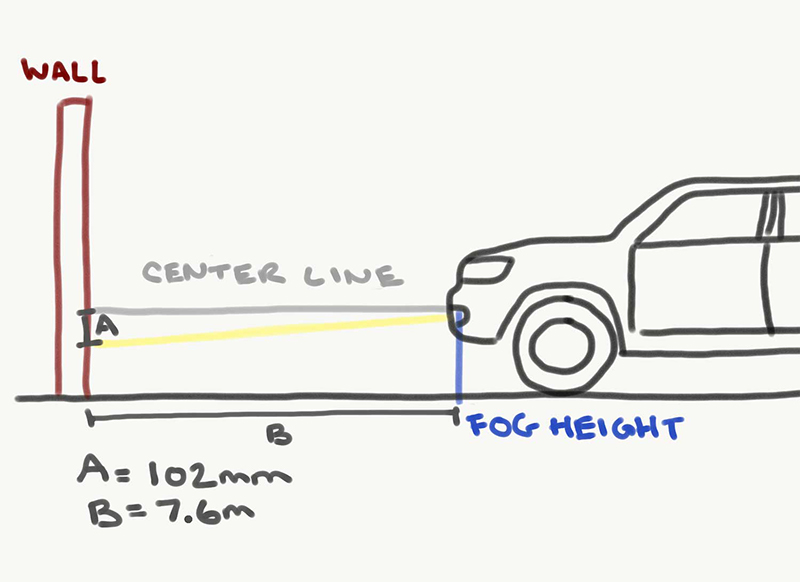

  2. Position the vehicle on a flat surface in front of a flat wall. Be sure the distance from the fog lamp to the wall is exactly 7.6m (25 feet).
  3. Measure the distance from the center of the fog lamp to the ground. Make note of this measurement. This is the fog lamp centerline. Mine measured 722mm, but yours will probably be different.
  4. Turn on the fog lamps and adjust them so the top of the beam cutoff is 102 mm (4 in.) below the the fog lamp centerline height. In my example, I took 722mm minus 102mm. Therefor, the top of my beam cutoff needs to be at 620mm from the ground.

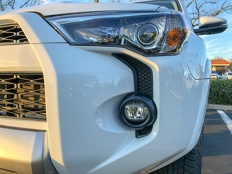

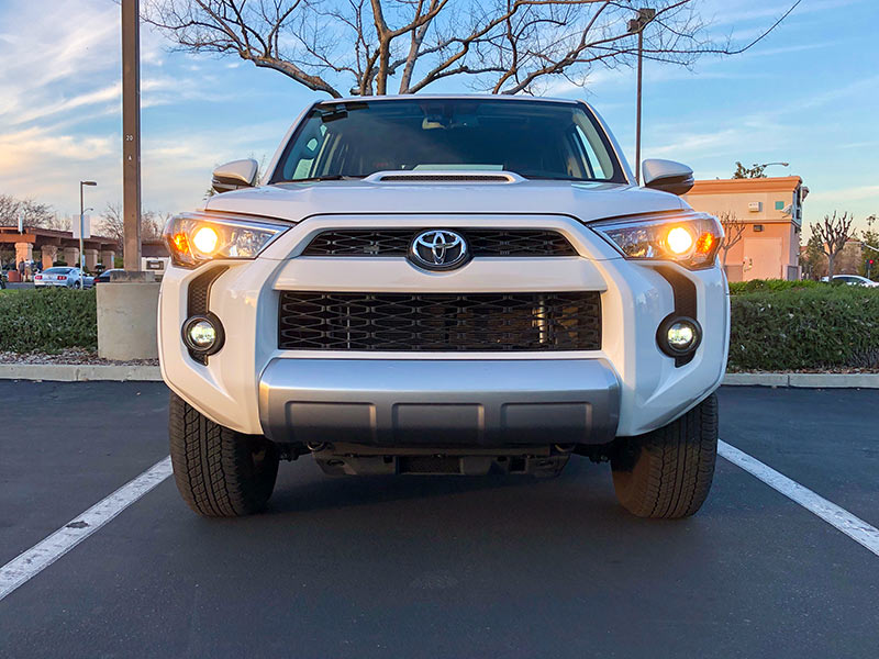

Any comparison before/after pics? Or pics after install?
Sorry, no before and after.

Anyone that can confirm this is the "Rigid LED Fogs" that the TRD Pro comes with in 2019?
Definitely not Rigid. They are 100% Toyota. I don't believe the 2019 4Runner TRD Pro comes with Rigid either (unlike the Tacoma). In fact, I've been looking very closely at photos of the '19 TRDP, and they look just like the Chinese "kit" ones. :eek:
There is a good photo of the '19 TRDP LED fog lamp in forgerunner's post here.
This is mostly speculation on my part, but I think the Japanese ones might be higher output or have additional LEDs in them. Here's why I think that... the Japanese ones look like they are using two multifaceted reflectors that together span the entire width. The Chinese ones look to use a smaller optic (projector) in the center. Additionally, the heatsink on the back of the Japanese ones looks to be significantly larger. This could provide for additional cooling for the LED(s).
I've added a couple after photos to the original post. I'll try work on some night photos soon.
