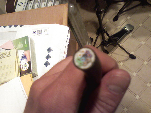

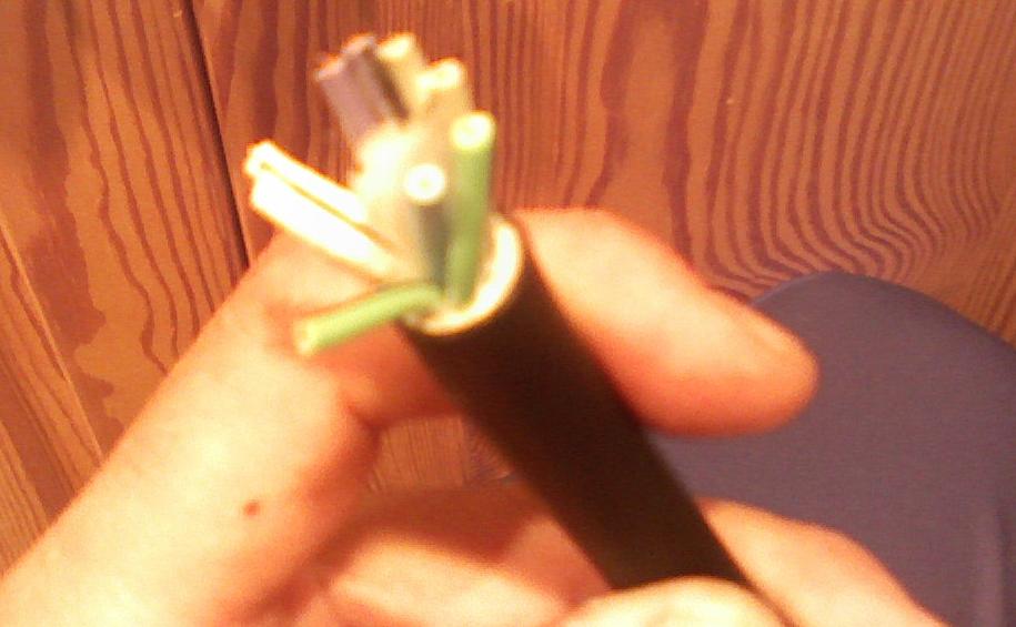

Well...I saw this 16 guage monster cable in the store for $.99/ft, so I bought 10 ft of it. I figured it would be much easier to just go this route. I'm only running 75 watts rms. Sorry for the camera phone pics. I thought 16 guage would be ok because the speakers are more than 50 feet away.
the wire also has a remote wire running through there. its pretty legit.
