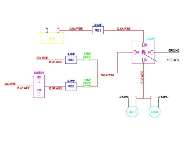

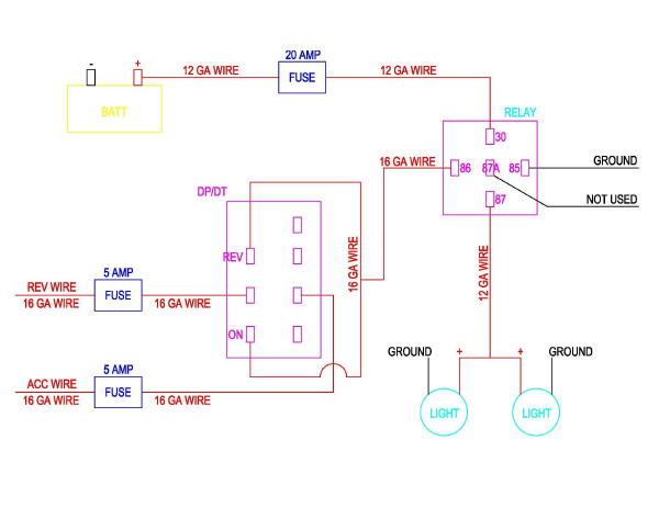

Well, from the diagram, the DPDT switch is a 'OR' gate, in a sense. The switch (if it is the right type) will allow the relay to 'turn on' with either the back up lights or with the ACC power. With this type of switch, there is no worries about power back feeding from one source to the other. The relay sources the battery power (via fuse) to the lights. I'm not sure what the diode in between the relay and switch is for. Since he is running LEDs, he probably doesn't need it, but it is good practice to keep the control source isolated from the power source.
I had a spdt switch initially. Then I was told that I needed a double pole double throw switch instead as the spdt switch was wrong. So I changed it out to the dpdt. The first drawing shows, what I believe, is what you [MENTION=93434]gshadow325[/MENTION] are telling me to do. The second drawing shows what others on here are telling me to do, now minus the diode per [MENTION=3958]jwyshrek[/MENTION].
Thats correct. That's what I am saying to do.

Ok, here are the two options that everyone has came up with. Sounds like both will work just fine, just a matter of preference. Let me throw another loop into this discussion. If I were to decide to run majority of this to the back, besides the switch, do you feel I would just need to increase the size of my power line from the battery?

like i said before, i dont know what the second diagram does.

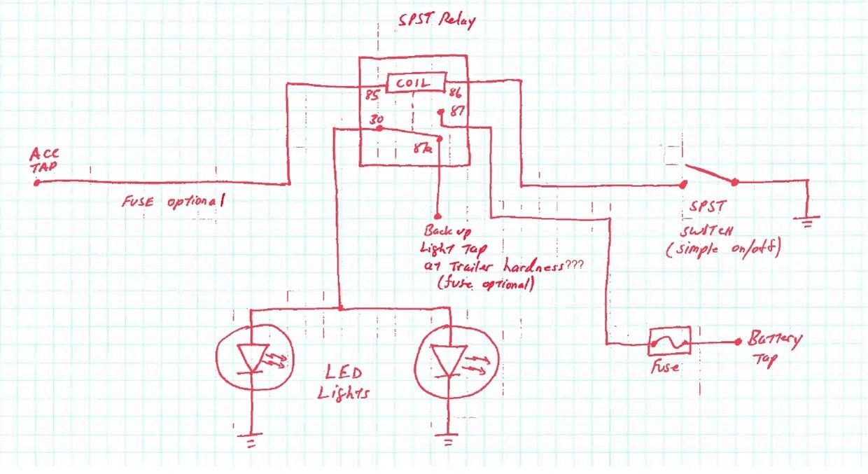

Not sure if you have started this or not...but either in your diagram should work. I would do what is simplest to wire up.
Having said that, I have the following that is the simplest, I believe, electrically based on the criteria set by me and others on this thread...now, wiring it up...maybe another issue...
So, to confuse you even more (or not) :decision:
Sorry for the crude sketch, but was busy at work...
I have not started this as I have been searching out the correcrt parts I need. This seems like an easier way to wire everything than the previous 2 sketches I had. Just to clarify though and pardon my ignorance, the way you have it shown will have the flood lights always come on when in reverse since the NC will be that, then once I flip the SPST switch the coil flips it over to the NO position and the lights will be constant on?
Yes...when the relay is 'off'...power to your LED lights will be sourced from the backup lights...whenever backup lights come on...your LED lights will come on.
When you toggle the SPST switch to complete the ground circuit path...it will turn 'on' the relay and allow the LED lights to come on when the ACC is on (power sourced from battery).
So, in summary...switch off...LED lights = backup lights
switch on....LED lights = ACC on...lights will be on as long as ACC is on...if ACC is off, lights will be off (as long as you are not in reverse)...well, if I remember right, back up lights only come on if the ignition switch is on the 'ON' position (above ACC)...So, if ACC is off, lights will be off.
There should be no issue of mistaking leaving the LED light on with the vehicle off.
They look ok...however, if you intend to use the indicator light on the switch...you'll have to move the switch from pin 86 side of the relay (ground) to pin 85 side of the relay (ACC on hot)...in order to have power for the switch indicator light.
