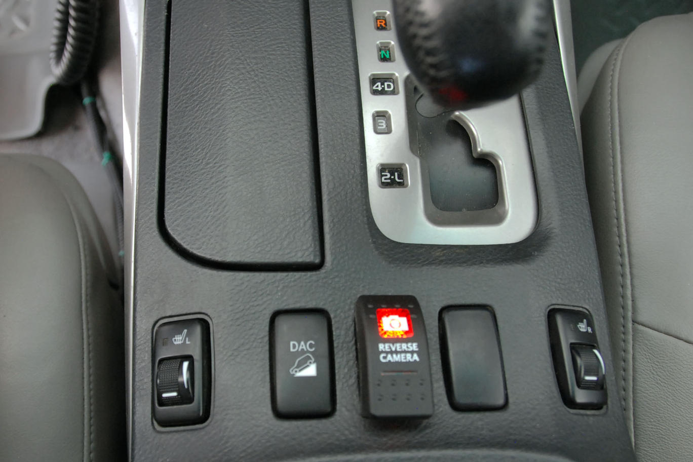

I used a Carling SPST lighted rocked switch. Mounted on the center console next to the down hill assist switch. The camera is an Eclipse BEC 106 I'll try to send some photos in the next few days I can't believe it is in the 4 runner and working great. I would never had figured it out without your help.
dwinev

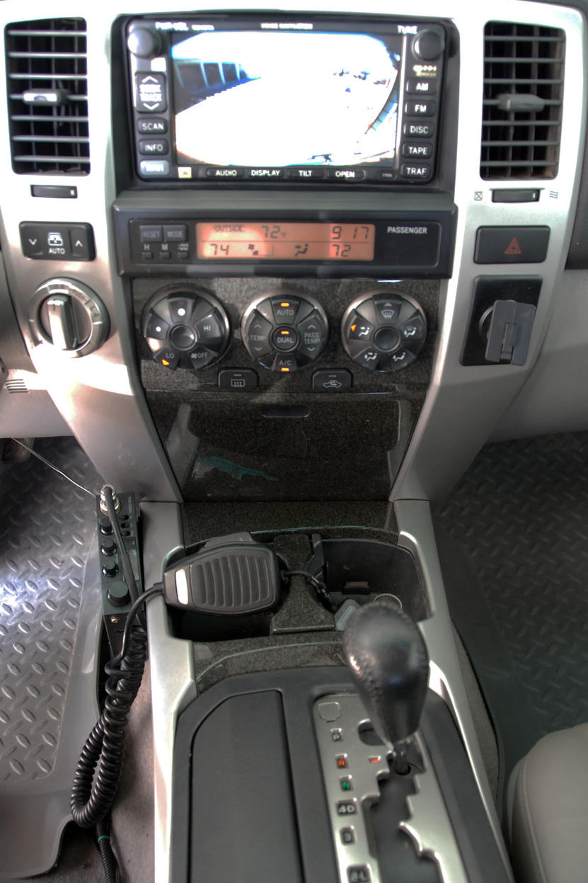

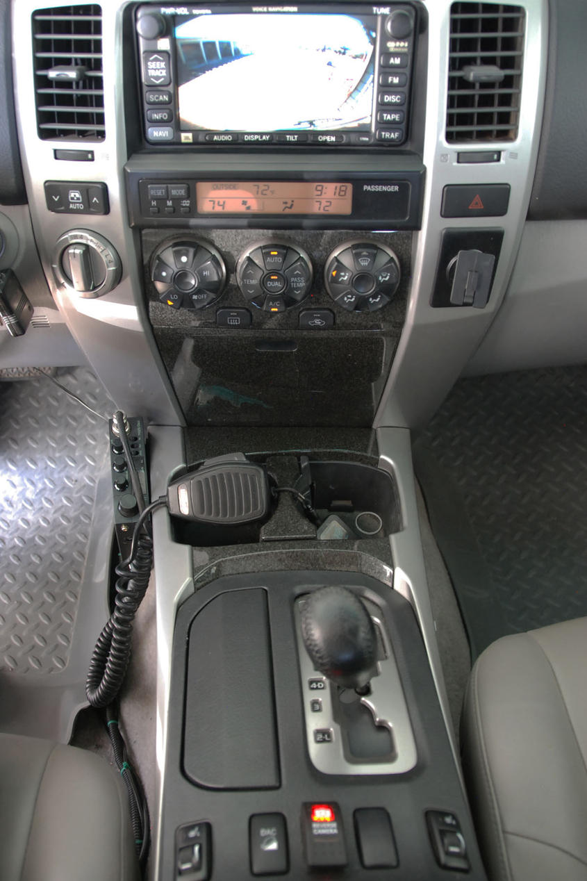

J A, A few photos of the switch location, one photo of camera on when in reverse and one of camera on when in drive. Of course I think that Snesley's switch look more factory like and I may got to that later, thanks all that heped with this.
dwinev
