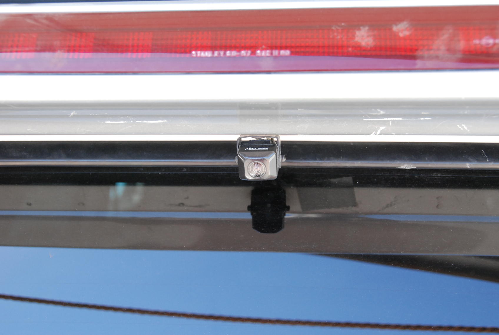

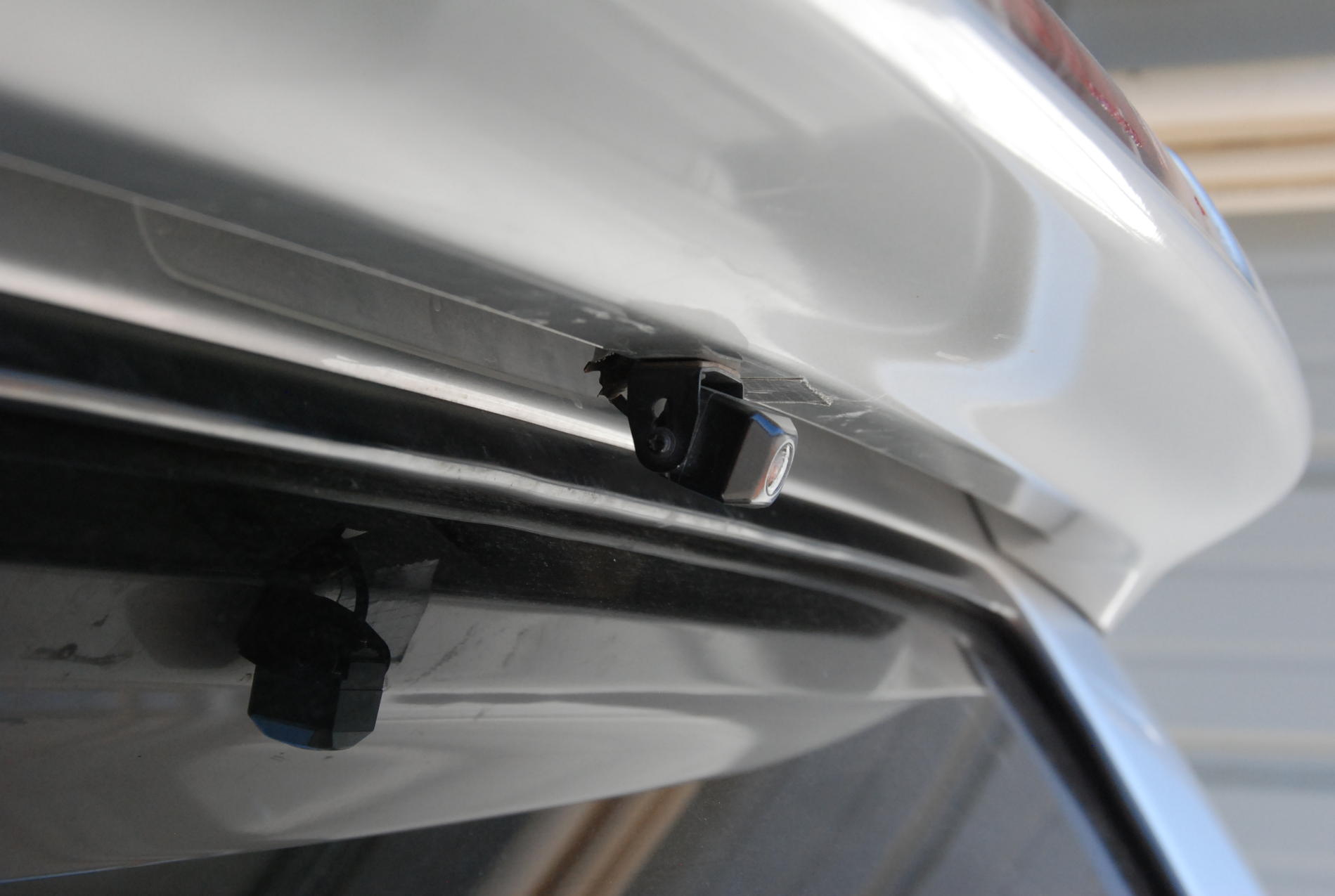

From what you say about aiming your camera I suppose it is at the license plate area. I placed my camera on the rear window air spoiler, in the middle on the spoiler behinf the spoiler tailight, this places the camera gight above the rear window The BEC 108 camera came with a long power cord that reached and plugged into the back of the factory nav unit.

Interesting, I have the stock camera by the license plate as you stated. I had remounted it to a swing-arm with the extra gas, spare etc but found that set-up too inconvenient. Since I have the additional wiring I might try relocating it. Do you have any pics?

CXS here are the photos of the BEC 108 camera on the rear window air spoiler,

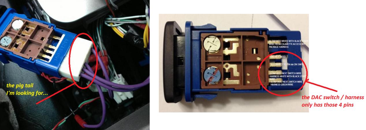

I have just received the same OEM parking switch, coming directly from Thailand !! Very nice ! My idea is to activate 4 front parking sensors using the same raisoning (and the same relay+switch), while the backup camera and the backup parking sensors will automatically work when I'm in reverse.
However, the "pig tail" (the white connector/harness to put at the back of the switch, with the wires) wasn't included with the switch... I don't know yet what i'm gonna do, because the switches and connectors you can buy from Totota are smaller : they only have 4 pins (exactly like the DAC switch actually). Whereas this OEM Parking Sensor switch has 5 pins (well, actually only 4 are being used, as you wrote)
Could you tell me where I can get the dedicated pig tail or white connector/harness ?
Thanks a lot for your help.

This white connector was purchased from the toyata parts counter in my area. I simply brought the switch in and the parts dude pulled out his book and turned to the pages that had the whaite connectors and we just matched it based on shape. Was really easy! Sorry but was a while ago so dont have the part number but like i said, was super easy to match.
The pigtails you can find online or better yet, go to a salvage yard and cut a bundle off any switch. Those pigtails are everywhere on pretty much any Toyota in the past 15 years. Think i bought a bundle for like 5 bucks.
Hope this info helps good luck!
Thanks a lot for your reply !

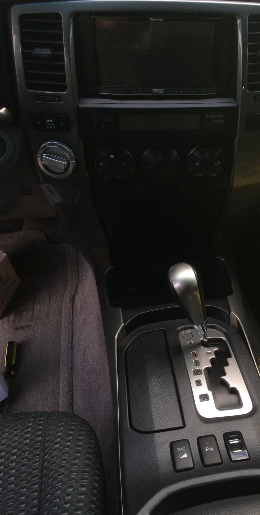

While I was playing with the dashboard trim yesterday (to plug the RCA wire for my rear camera), I've noticed the "rear-window" switch has exactly the same shape : there's a white harness/connector at the back, with the same number of pins than the OEM parking switch. I'll ask the parts department of my local Toyota dealer if I can order one. Shouldn't be too expensive.
I really like the stock look as well ! I'll try to find some black matte spray for the shiny USB plugs.
