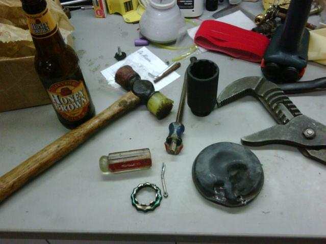

Anyone got a good suggestion on removing the hub dust cover without destroying it?

WOW! i just use a small flat head and a hammer to get it start off, then you can step up to a bigger one and just go around the edge with the screw driver and pry it off. How did you manage to do that?
That's pretty much what I was doing, but it wasn't budging.
Eventually I put the screw driver through the cap.
Using a bigger screwdriver didn't help, especially when that one broke.
I ended up using that large pair of channel locks on it and it just got worse from there.
I'm hoping some one has a different method than the one you & I used.

I use a screwdriver and a hammer and work it along the edges...make love to it, dont gorilla it hahaha
Just takes patience

all I did was a used a very small flat screwdriver to get it started and then use a bigger flat screwdriver.... I took (Trailmix) advice. I worked just fine......
Don't feel bad , same thing happened to me , it's meant to come right off like a lid on a, paint can but after 200k mine wouldn't budge , ruined the bloody thing trying to get it off and really are you going to buy the specialized tool for this , lol, I'll buy new caps from the jy as opposed to a tool...too many tools and a waste imo...I sprayed some lube in there now it comes out easy every time, glad I'm not the only one who struggled with what seemed like a vet simple task , lol
Mine came off for the first time in 17 years in the rust belt using a hammer and wood chisel (old one) gently, just going around and getting it to move a little bit at a time. Went back in none the worse for wear.

Using a small hammer to tap the end of an all steel butter knife (non plastic handle version) or a putty knife to get the dust cover loosened up then using a flat head or chisel to continue working the edges until it pops off has worked for me.
Never underestimate the power of penetrant and time! Kroil, PB, acetone/atf!
Dribble a few drops on there, tap the outside of the hub a bit bit a hammer to break up the dissimilar metal corrossion bondings an voila!
Remeber the hubs take a beating daily and see most of the road and trail crap you ain't going to break a hub from beating on it, but that thin stamped cap is weak.

Using a cheap harbor freight screwdriver I modified to act like a custom wedge. Biggest flat head screwdriver in my crappy HF set broke off the tip awhile ago and was sitting in my tool chest just waiting to be modified for a purpose. Worked like a charm. Took a grinder with a 24 grit flap disc and professionally contoured it, ahem *burb* garage beer, into wedge shape the provided enough lift to get in there and loosen it before going back to other tools. Worked pretty easily and cleanly after dinking around with various screw drivers and chisels.
Hope this helps someone else out in the future. I was flummoxed for a bit. I was calculating replacement part cost and the cost of my time. Nearly just cut the damn thing off and bought a new one. Ain't nobody got time for gently banging on a $15 piece of metal for an hour.

sounds like your new tool is a champ. i almost wonder how a paint can opener would work, if one were to hold it with the claw just right, and tap it in with a hammer.
when i did this as part of the front-end extravaganza the other day, after a screwdriver to start, i used progressively larger chisels and just worked round and round, babied it for a few revolutions and then it clanked on the floor. it was clearly the first time it had ever been removed, since everything back there was factory-clean.

I think my truck was in the same factory pristine condition as yours. Thing I hate about wrenching the most is when you watch everyone else just take parts off easily, and then you're sitting there struggling on what seems like should be a simple task.
I tried a few chisels I had, too. Also, a pry bar used to remove framing nails (flat bottom, sharp chiseled edge). Small screw drivers. Bathed it in penetrating oil. I even yelled at it with my loud, serious outdoor voice. No dice. I took one whack with my modified HF screwdriver and it just popped open, but not off, instantly. I sat there in amazement thinking to myself, "that just happened? Really?"
