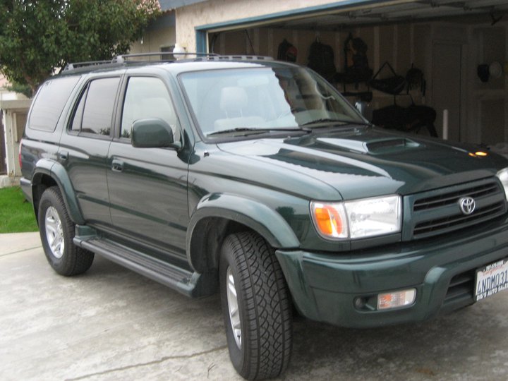

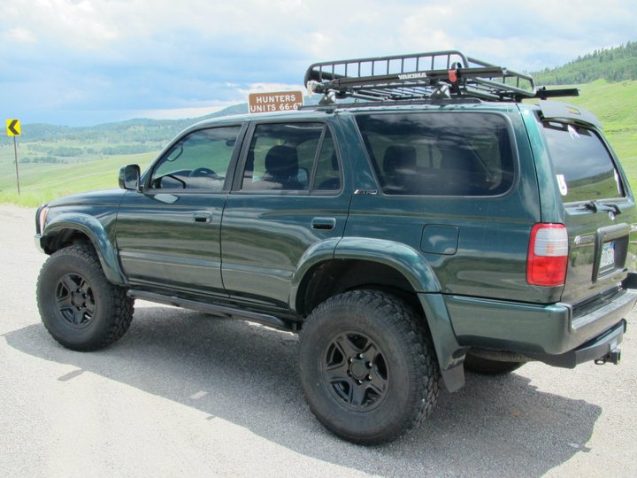

Since I prefer to see posts with photos, I figured it would be timely for a good before and after.
First is BEFORE EVERYTING
Second is CURRENTLY, of course the photo happens to have the sign lurking in the background of the unit I hunt elk!
