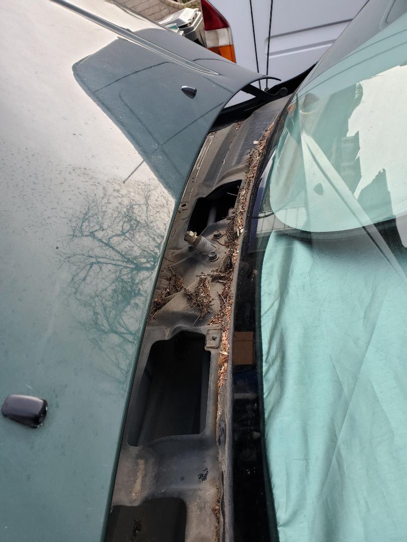

I think the inlet vent is under the wiper cowl on the passenger side. I think if you turn your HVAC to recycle air instead of fresh air it will close the HVAC door to the outside vent. But if a mouse is in there it might have chewed a hole in the foam that seal the door.

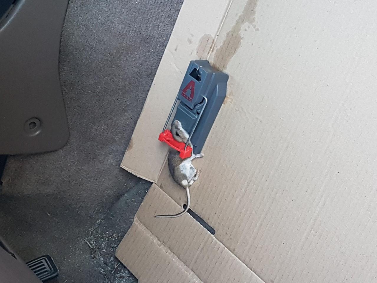

Set a trap last night ( peanut butter ) , going to go out in a bit and see what is in it . I'll update later , thanks for all the replies , much appreciated .
Bam !!!

That's the picture right there. The main air source is right there at the base of the windsheild (screened normally). From that cavity, air goes to the passenger side (below where it is solid at the 'top' of this picture), then down into the HVAC system. On each end of the wiper cavity, there are also water drains. That is how the mouse would be able to easily get into that area, then the vehicle interior. The only way you will be able to mouse proof is likely from below with the fan motor removed.

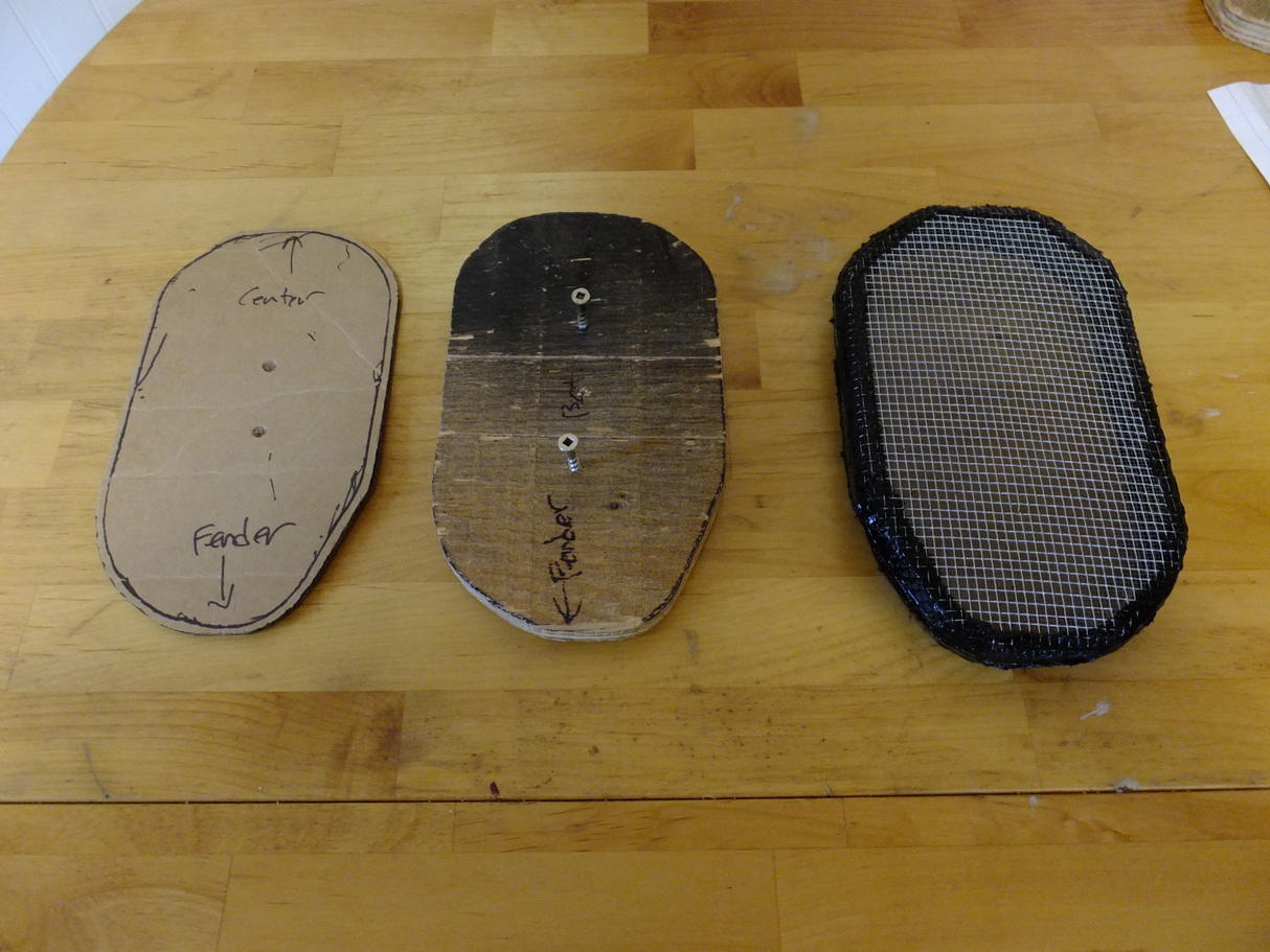

Yup, that's what I had to do. Worked upside down on my back to make a screen to cover the inlet. Bit of a pain but only 4 or 5 hours work all in. No mice in the interior since.
See Thread: No more mice!
