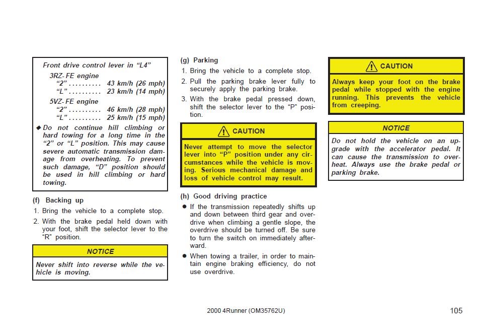

Did we confirm if you have an auto or manual?
If it's an auto, I am boggled as to why this would be possible. GM's HydraMatic transmission...in the 1940's prevented this from happening. Design flaw, or is something wrong with OP's tranny? I'm not about to go test it on mine. Lol.
As it turns out, it appears this transmission does not prevent this in 'R' or 'Park'. I'm gathering from the warnings in the user manual. Interesting indeed.
Now that's kind of confusing (manual).
I thought L and 2 are for steep grades going up or down.
Yea true but heats up trans like crazy. Toyota says this to cover they're ass. I try to get out of 4lo asap to cool trans on long decent.
