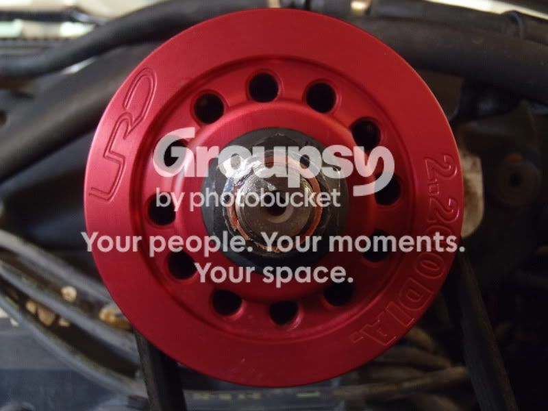

The pulley nut was a little tough. I used a Strap Wrench to get it off. I used a basic model w/a rubber strap and doubled the strap over twice on the pulley for a better grip. I set a metal bar across the engine bay from front to back, then spun the pulley until the handle of the strap wrench hit the bar (kinda like bracing a breaker bar on the frame to spin off a crank pulley via a starter bump)...Then I took a breaker bar and an 18mm socket, and torqued on it and it came right off.
After I started it, I was getting A LOT of belt squeal from the new pulley. I let it idle for about 10 minutes with a couple extended trips to 3000 rpm's, stepping down to 2000, then 1000, then back to idle. After that the belt cut-in to the pulley and the squeal went away. I also repainted the silver line you see on the pulley nut across the input shaft so I can keep a close eye on whether or not the pulley nut is holding it's torque.

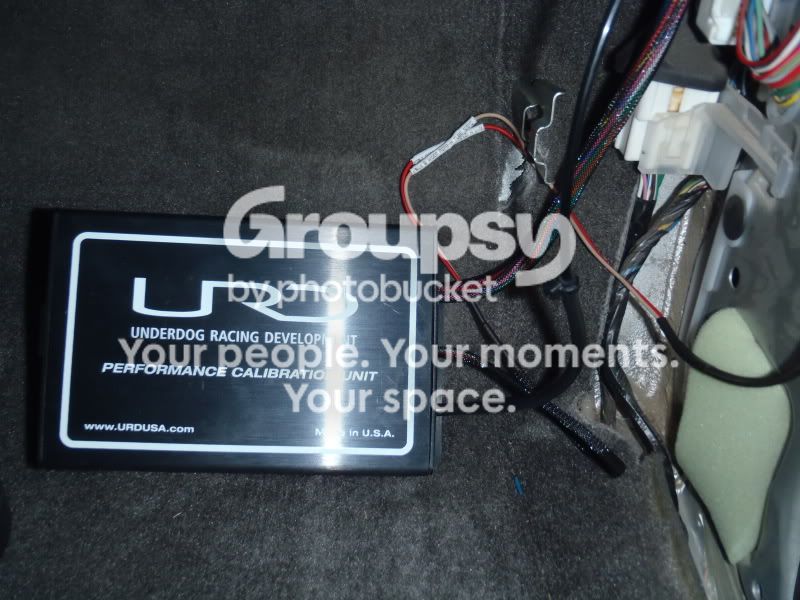

URD AIC & FTC Installed!

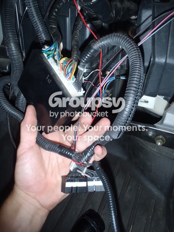

I got a little time, mixed with a little motivation, so I decided to yank the TRD 7th Injector electronics and install the URD electronics.
It's an intimidating install, mainly due to the fact that you have to cut up your factory ECU wiring and tap/splice several wires to install the URD kit. After having owned both setups, I would say that the biggest benefit of the TRD 7th Injector is the comfort factor. It is all plug and play, and while it is adds a TON of wiring behind the glove box, it is easy to install/reverse. The URD kit, not so much.

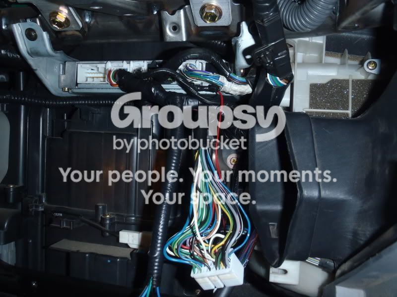

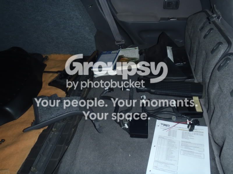

To start, a picture of the TRD 7th wiring. In this picture I have already removed the 2nd box, and visible are the plugs on the lower RH side of the pic...
65409617.jpg~original
I took one more shot to show the interface between the factory ECU and the TRD 7th ECU, along with the wiring that feeds the TRD 7th Injector itself...
533d05c6.jpg~original

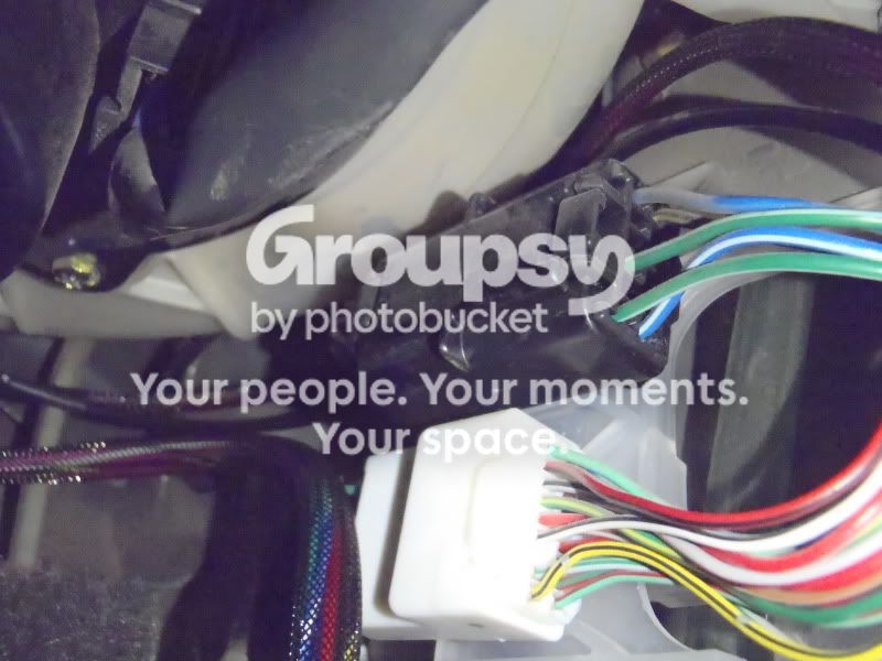

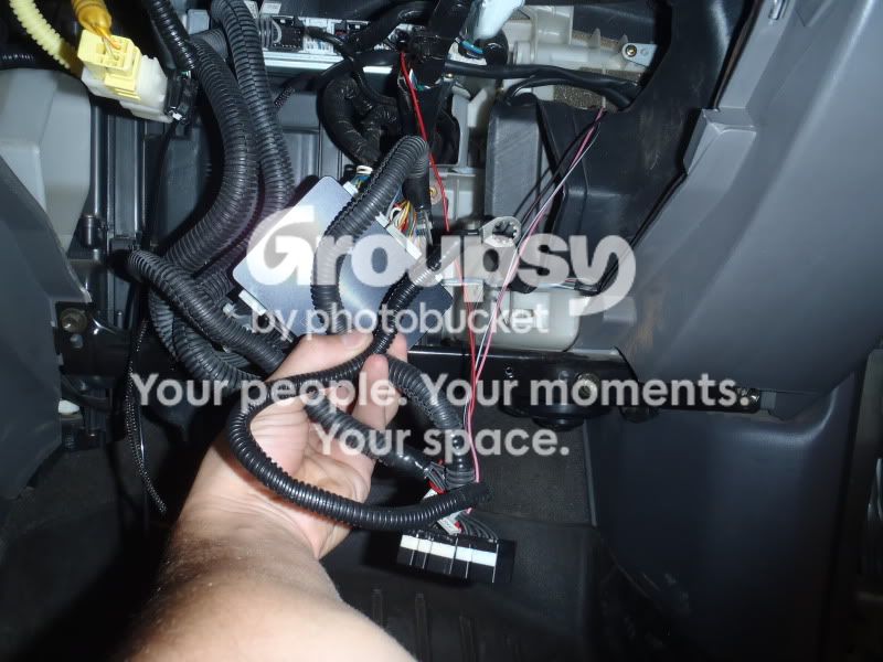

After a bit of unplugging and cutting the injector wiring, you start installing the URD kit. It includes instructions that are specific to each model year, because the ECU wiring changes from year to year.

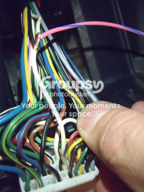

First, you splice in the ECU power and E1 lines... if you come from old school Toyotas, you should be familiar with the E1/T1 ECU interface, which gives you ECU trouble codes on older Yota's.
9ae82e77.jpg~original

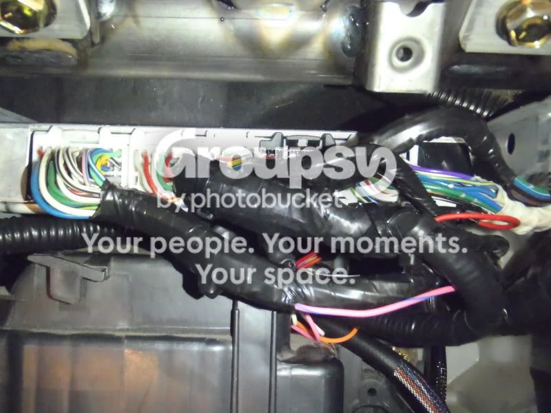

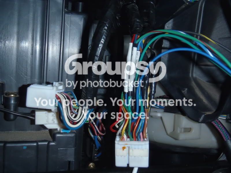

Next up, you splice/tap in the Ignition, Crankshaft Position Sensor, and Camshaft Position Sensor wiring. Most of the wiring for the URD kit occurs on the "B" ECU plug.
7b69d29f.jpg~original

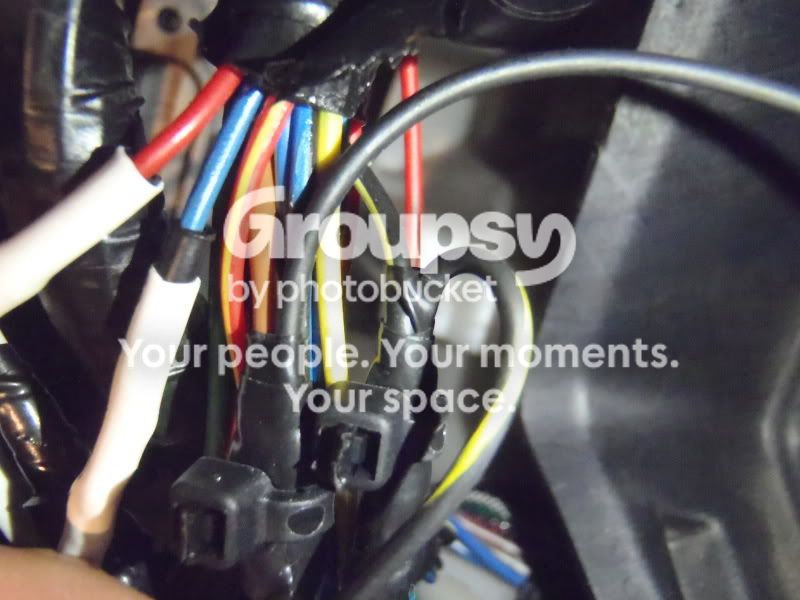

It's somewhat nerve racking to hack into your factory ECU wiring. Eventually you end up at the last connection which occurs on the "A" ECU plug. See that white wire that is pulled out from the bundle, that is about to get cut...
707e6614.jpg~original
And tapped like so...
f3a4ce6b.jpg~original
A little bit of solder later, and all the plugs are re-installed into the ECU...IMHO, the URD install looks much cleaner than the TRD electronics finished product....

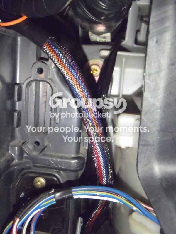

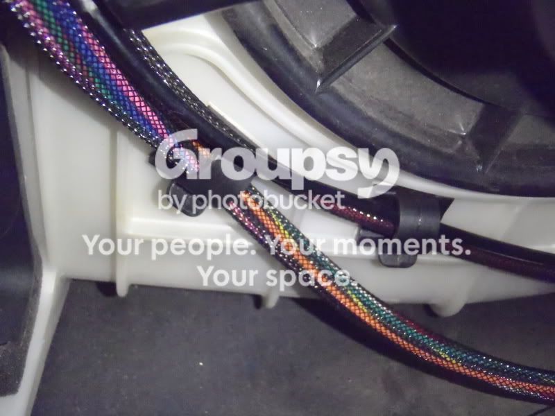

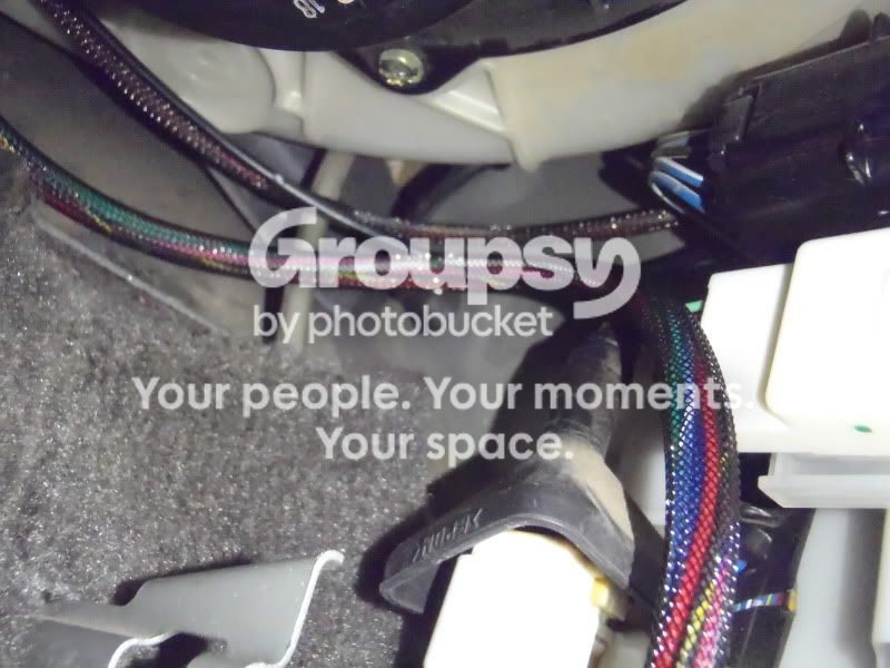

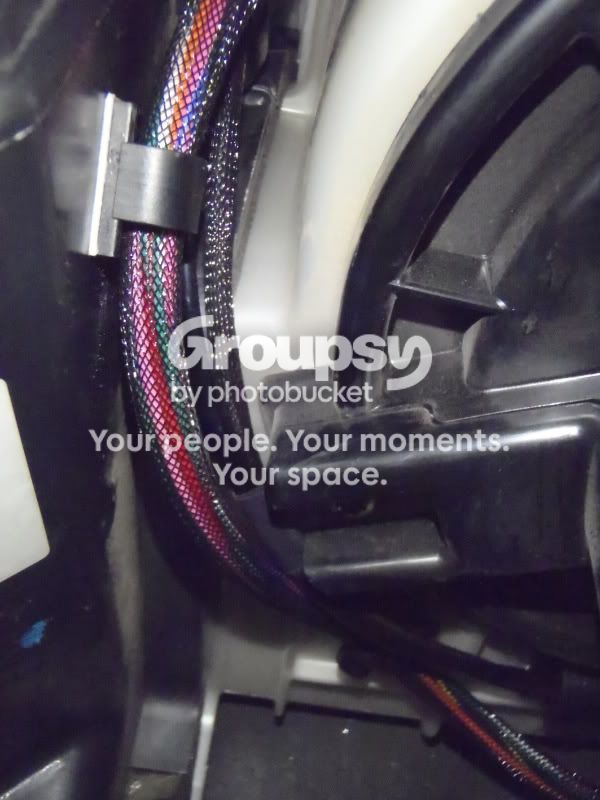

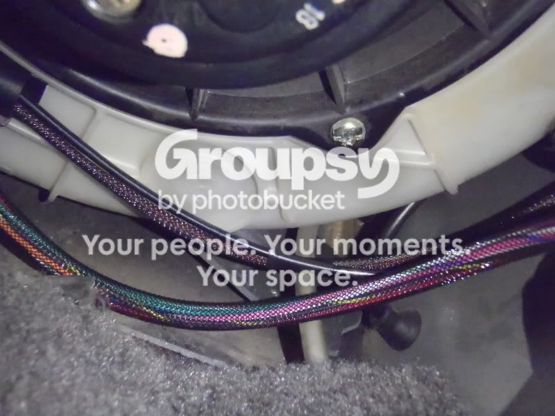

These pictures show my choice for routing the URD Computer wiring, Injector wiring, & Vacuum/Boost line... if you don't follow, don't worry... you WILL if you ever install this system.
a69407e2.jpg~original
7d40261c.jpg~original
3a2fd655.jpg~original
efe09819.jpg~original
52bf2b12.jpg~original
d35f5870.jpg~original
9a432f62.jpg~original
1ec5f12b.jpg~original

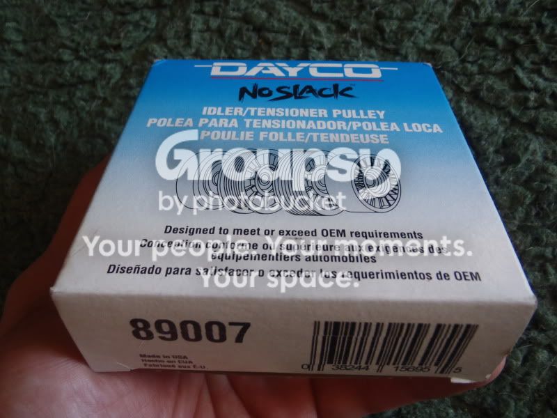

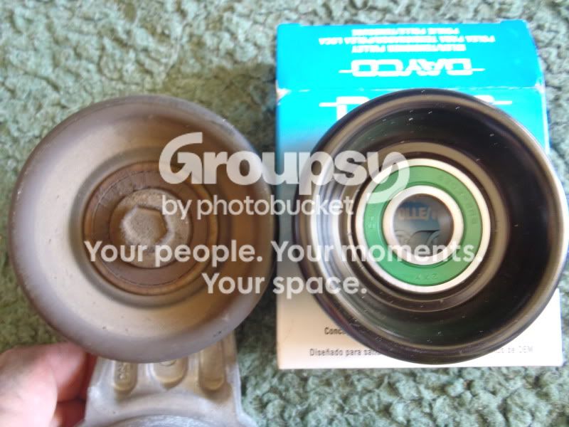

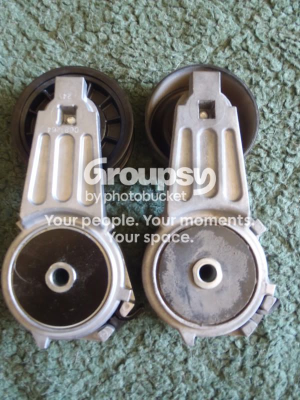

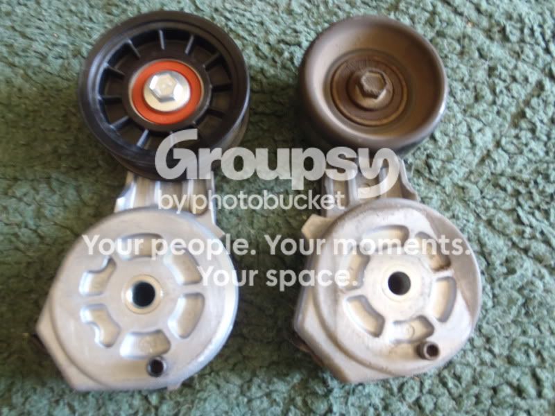

Ever since I installed the 2.2" URD Pulley, I've been getting some belt slip. The belt has been leaving dust on the pulley and I've been feeling significant power loss when accelerating from a start. I've been watching my boost gauge closely and I usually can't build more than 3-4 lbs of boost off the line and 6 lbs max due to the pulley slipping.
To address this problem, I decided I'd first take a look at the dynamic tensioner. IMHO, they do wear out. There is a spring in there that provides the tension, and like any spring it will eventually become fatigued and lose some of it's tension.
I did some research on replacement options and found out (via a thread on YT) that Dayco makes a replacement tensioner that is nearly identical to the TRD part.
The tensioner itself can be found on Amazon.com (sold by amazon.com), for $31.90 Shipped. It is Dayco Part # 89241 (Link >>> Amazon.com: Dayco 89241 Automatic Belt Tensioner: Automotive )
e031517b.jpg~original

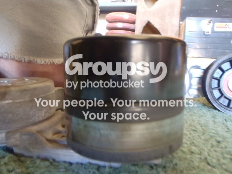

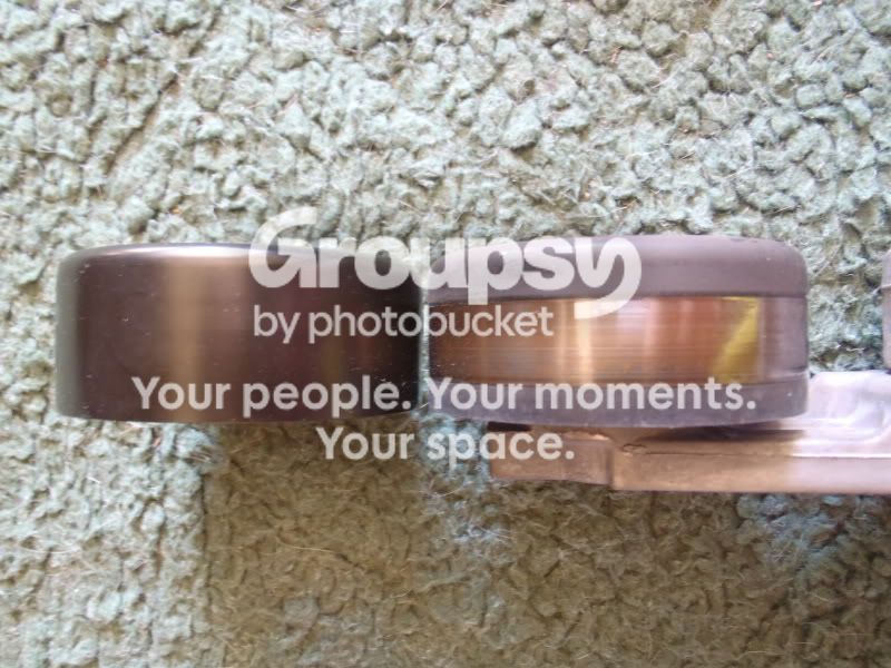

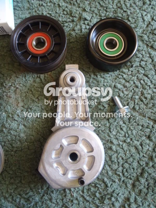

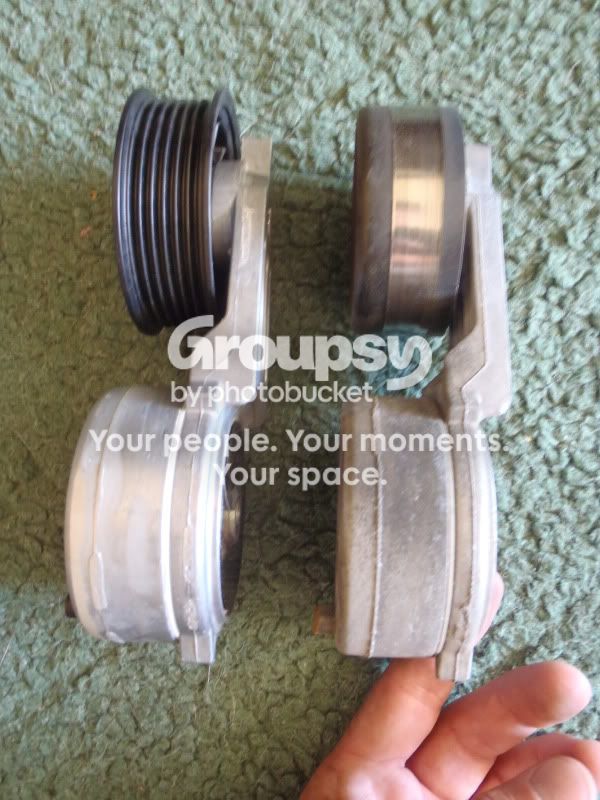

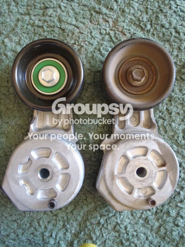

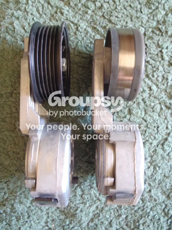

When compared side by side to the TRD Part (TRD Part # is PTR30-35041, by the way), the Dayco tensioner is identical except for two things...
First, it comes out of the box with a ribbed pulley.
34346fd7.jpg~original
520976f3.jpg~original
2b436b57.jpg~original
And second, there is an additional "Stop" cast into the body of the TRD tensioner. Notice in the picture below, the additional stop is near the top of the body, close to the pulley. I didn't see any particular need for this additional stop because the one near the bottom is in the same spot on both parts.
dc5c0ee0.jpg~original
The pulley issue is solved by purchasing Dayco Part # 89007, which is also available on Amazon.com. The pulley sells for $12.68 shipped.
e2d65fca.jpg~original
Some comparison shots of the Dayco Pulley next to the TRD pulley...
c5a8c209.jpg~original
I placed it right on top of the TRD pulley to make sure they were the same diameter...
cdb3ba19.jpg~original
1d3d04aa.jpg~original
I took a 13mm socket and removed the bolt securing the ribbed pulley, and replaced it with the flat pulley. I torqued it to 40 ft. lbs which is the torque value that TRD recommends for the bolt that holds the tensioner to the engine. They are similar bolts w/a similar purpose, so I figured that value should work. I couldn't really find a spec for the torque value.
0ebe1f3c.jpg~original
Bada bing, bada boom... you just made a TRD Dynamic Tensioner...
10e3b4ff.jpg~original
Total cost for the replacement tensioner going this route is $44.58. I thought this was a screaming deal until I checked TRDParts4U after the install.
They sell the TRD tensioner w/the correct pulley pre-installed for $49.20 + 11.64 shipping for a total of $60.84. ( Link >> Click Me)
So... You save $16.00 by going w/the Dayco setup. After reading the thread on YT, I was under the impression that the TRD part costs upward of $100, but knowing now that it's only $60, I'd probably buy the TRD part next time just to have an OEM part.
Conclusions: My old tensioner was definitely getting weak. As soon as I fired up the engine w/the new tensioner, the belt squeal was gone. I took it out for a drive and found that it is now making full boost off the line and feels alot punchier when I step on it from a light.
I'm now seeing full boost almost instantly and maxing out around 7 PSI. :lookout:

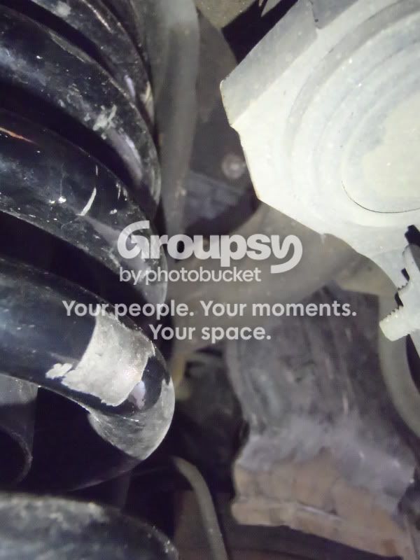

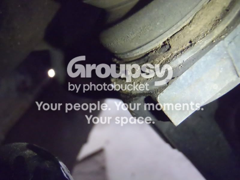

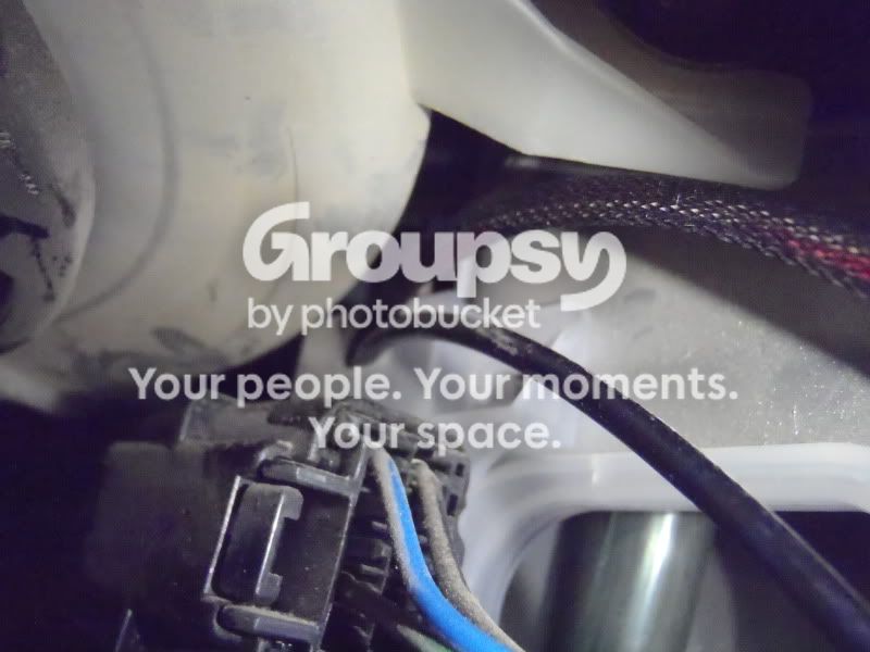

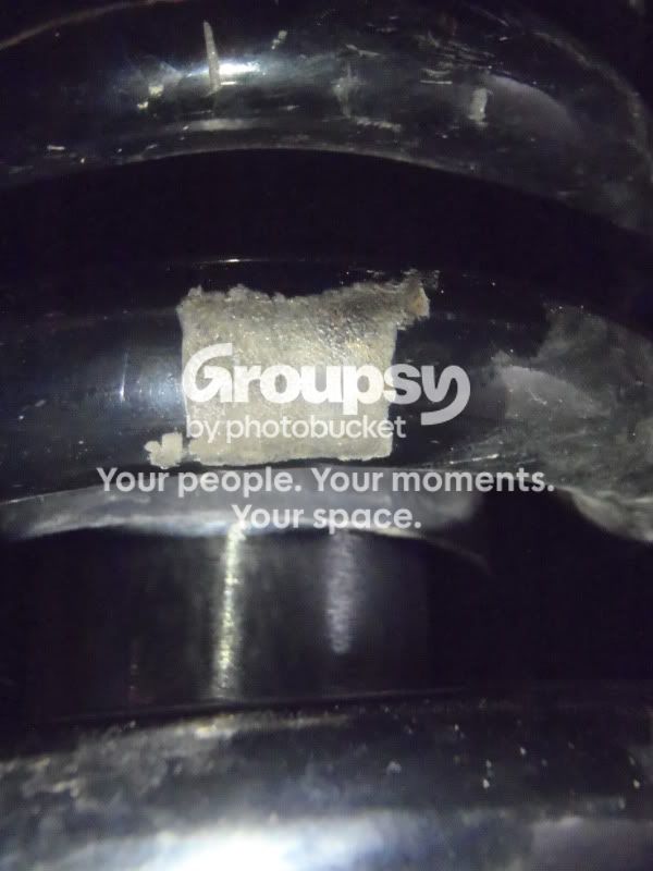

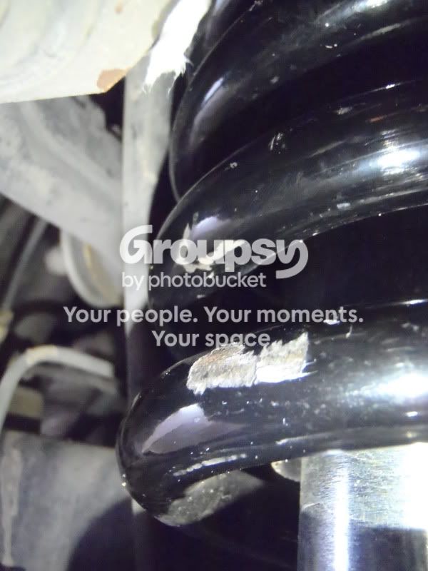

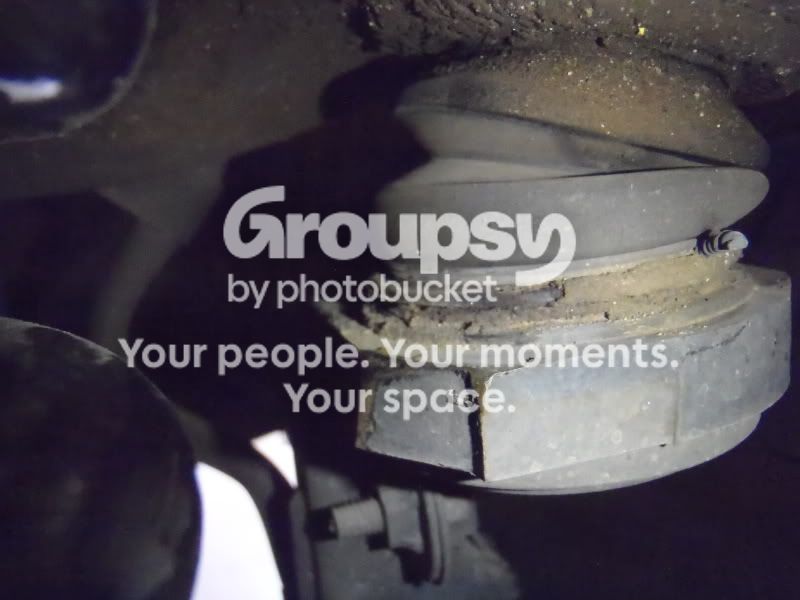

The last thing I wanted to get posted here in the build is that I've been running into a little problem with my front suspension. I'm running a SS 1.2 w/the adjustable bilstiens & Tundra coils up front.
The problem is that the spindles are contacting the coil springs when the suspension unloads. This results in a LOUD chunk-clunk kind of noise as the spindle drags across one of the wraps of the coil on the way down, then again on the way up...
Driver side...
26661839.jpg~original
5b4f3d26.jpg~original
Passenger side...
2138754b.jpg~original
And check out the driver side spindle.. it's actually getting rounded off from hitting the coil... Also, notice how the caked on grease is getting knocked off by the coil hitting the boot around the U.B.J.... not good.
fb571ede.jpg~original
You can see a metal shaving hanging on in this pic...
53ac137e.jpg~original
I've been looking at several options and it looks like I'm going to end up installing limit straps on the front suspension to keep this from happening, so look for a write up on that down the road.
For more information on the issue, check out this thread:
