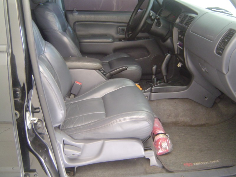

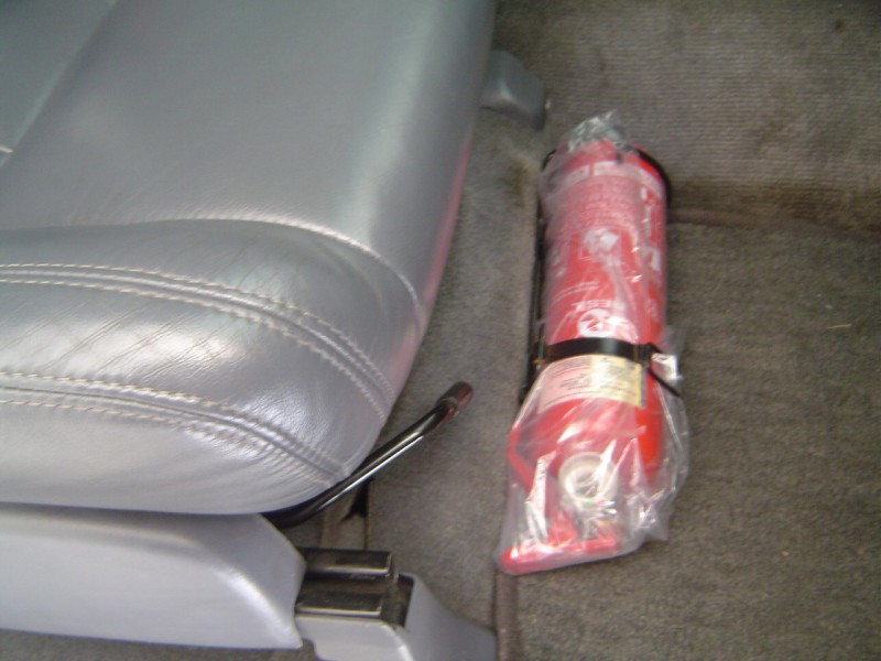

Just for kicks, I put it in a tupperware and I'm going to bake it in the vehicle for a couple days to be sure. If it bursts, it'll burst inside the tupperware and keep my cleanup to a minimum.[/IMG]
BigFish, all cars sold in Brazil, either manufactured here or imported, come with mandatory fire estinguishers, just like that model of yours. They are installed in front of the passenger seat. You should not be worried about them going off by themselves.
Regards,
Gustavo.
Gustavo, thanks for the reassurance. I was pretty confident about it after my research, but it's good to hear from someone with first hand experience on the subject. I sure wouldn't want to get into my 4Runner only to find it covered in fire extinguishing chemicals. :eek:
Yeah. And they have a 5 years lifespan (at least over here). I have just replaced a totally good one for a new one. Cops like to check that, and since it is mandatory equipment, if you don't have a valid one it means impound...
