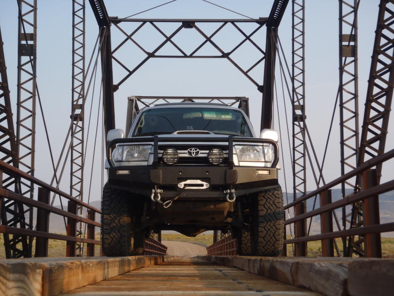

Amazing truck, and best wishes on your new arrival!
This is a really cool picture man. It would make an awesome poster, or post card, or something like that
I see that you saved it, being that you re-posted as an attachment versus a quote, so you must REALLY like it. I thought it turned out well too. When I work up that morning I knew I'd get a great shot on that bridge.
