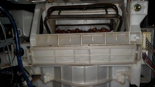

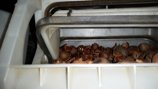

I had a squatter living in my 4Runner! The S.O.B. made a mess, and even took a crap in it! I have no idea how he got in. I didn’t leave any windows open, doors weren’t unlocked, sunroof was closed, and the alarm didn’t go off.<?xml:namespace prefix = "o" ns = "urn:schemas-microsoft-com:office:office" /><o:p></o:p>
<o:p> </o:p>
Fortunately, I was able to evict without violence, and there doesn’t seem to be any permanent damage. I don’t know of any legal action I can take now as I can’t find him, and never got a good look at him. I didn’t even call the authorities. I guess I was just too pissed. All I can really do now is maybe set up a camera, and set up a trap or two so if he ever comes back, I’ll catch him red-handed.<o:p></o:p>

Here are some pictures of the mess I found: <o:p></o:p>
<o:p> oh nuts 2.jpg</o:p>
<o:p> </o:p>
<o:p> </o:p>
<o:p> oh nuts 3.jpg</o:p>
<o:p> </o:p>
Again, I didn’t get a description of the culprit, but I’m betting he had a pretty fuzzy tail! No idea HOW he got in, but I sure as hell hope it doesn’t happen again. I’m assuming he decided to make it his home while it was parked out in back of my house under a tree while I was recuperating from a couple surgeries I had recently. I unfortunately didn’t have the room in my garage or it would have been parked there.<o:p></o:p>
<o:p> </o:p>
And btw, I don’t park near that tree any more!<o:p></o:p>

Yeah, I hear ya about the little chewers. After staring at it in disbelief, I proceeded to clean the cabin air filter area, the whole time inspecting everything else around it for chew marks. I did the same thing in the engine compartment.
So far it looks like I got lucky. :biggrin1:

The area you are showing is above the heater core. The critter is getting in to the vehicle through the fresh air intake, which is located under the windshield wiper cowl on the passenger side. There is no screening covering this intake, so once they figure how to crawl up inside the fender well to this intake, they have an easy path to get in. Once they find the path, they will store their winter food stash there, and set up housekeeping, and throw the occasional party for friends. I used to work at a Honda dealership, long ago, and this was a common problem with customers who parked in areas where these critters run rampant. The only fix we found that worked, was to remove cowl, and fashion a screen cover from 1/4" steel mesh to cover the intake opening. I installed one on my '03 years ago, when I found the first mess in the cabin air filter. Never had a problem again. I call it my anti-chipmunk mod...:biggrin2:

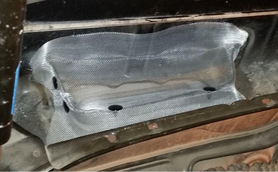

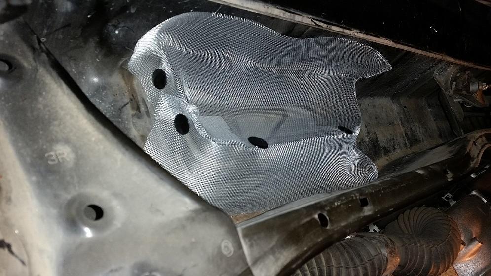

So I got some wire mesh at Lowes to create the ANTI-CHIPMUNK SCREEN. I drilled some holes in the sides, and there were already two holes at the top, so I used some plastic retainers to hold the screen in place.
Before doing this, I completely cleaned it out again with my shop vac, as I noticed after looking at the pictures that the piece that selects inside air, and outside air wasn't moving properly. So after clearing the obstruction, I installed the mesh. After taking these pics, I also ended up creasing, and folding the aft side down some as there's nothing to attach to. I think it'll be ok.

Thanks!
I didn't trim it up after the install either. I left it long around it so that if any vermin try to get in again, they have to work for it! LOL
Thanks!
