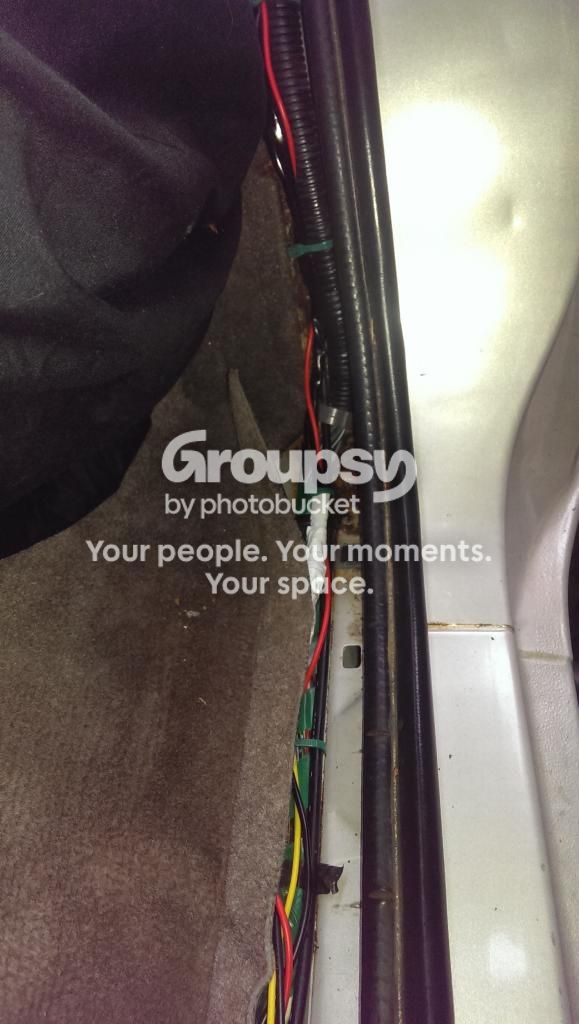

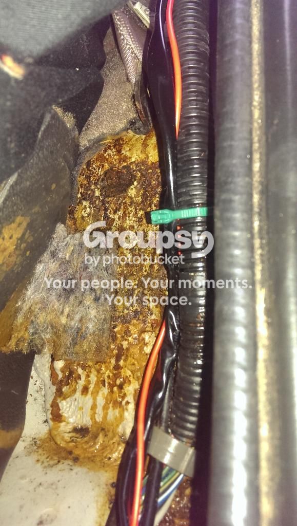

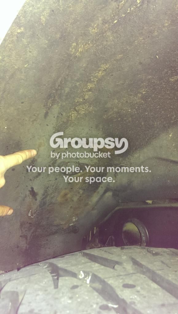

. Today after installing my rear led bar, while running the wires on the driver side I noticed very bad rust in the rear fender. When I removed the plastic pecieses and pulled the carpet little right under the rear driver seat next to the wheel fender there was rust. And moisture. If I push hard enough I can probably poke my finger through :( I sprayed wd-40 inside and outside of the fender. I believe the cause of this is, I sprayed 3M rubberized undercoat in the rear fenders. Thinking it will protect from salt and rocks. And I believe the water got behind some cracks and just sat there. Although the other side seems good. Any input , advice please.

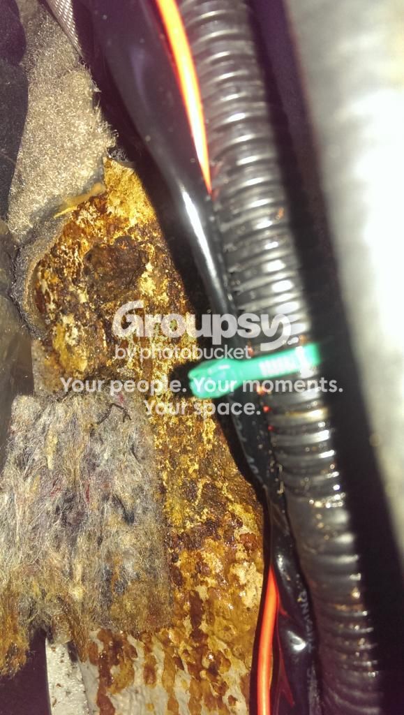

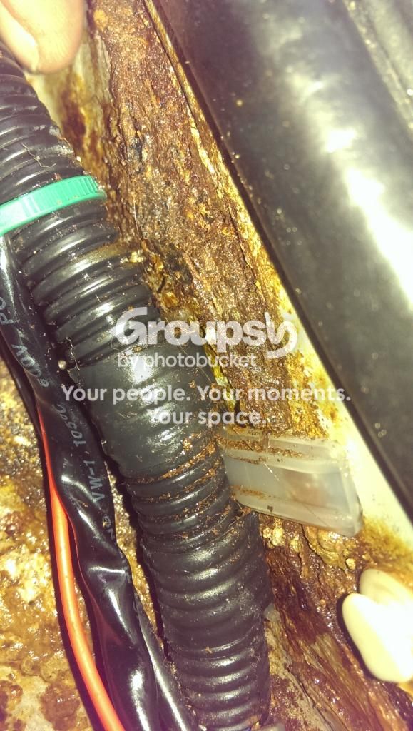

it looks relatively significant... enough to address it very soon. cutting that area and replacing with a metal piece would be nice since it can be covered up with the carpet... but preventing it from getting worse is important....
rust converter might be an option... would love to hear from some east coast folks that have to deal with rust frequently and often. definitely plenty of threads on here that address rust on the undercarriage.
I would be interested to see what a wire brush and some cleaning would do for the interior first and then treat accordingly. Notice bit of moisture in the interior so kinda wondering if that door seal is holding up or some gromit letting some water come in under your carpet.
I notice few areas where the gromet seal is ripped Nd the water sits there, mostly on the outer part of the door. It would be probably a good thing to replace the door seals.
I'm thinking that me and my.buddy will probably.end up cutting that section out and welding new piece. It doesnt really have to be the best looking since you don't really see it. Does anyone know if they actually sell the fender ? So you could cut a section out and weld it ?
Think I'm actually going.to just bring it to body shop and get a quote. If it's reasonable I'll let the body shop fix it. What,do you guys think is a reasonable price for this fix ?

I am curious on what melted the carpet? An acid spill?
What ever it is, remove the eat and carpet.
Wire brush it, clean and paint it. Don't install the carpet and on a rainy day, look for the leak

Could easily be bad door seals after I went back and looked at your pics better but I would pull that panel in the rear if you end up replacing those door seals and still get moisture.

Someone said if it's that bad in that area it probably has rust somewhere else. But I know for fact, that the frame is 0 rust and solid. The whole body is clean !! Besides this one area !!! I checked other areas of body and see NO signs of rust but that one area !
