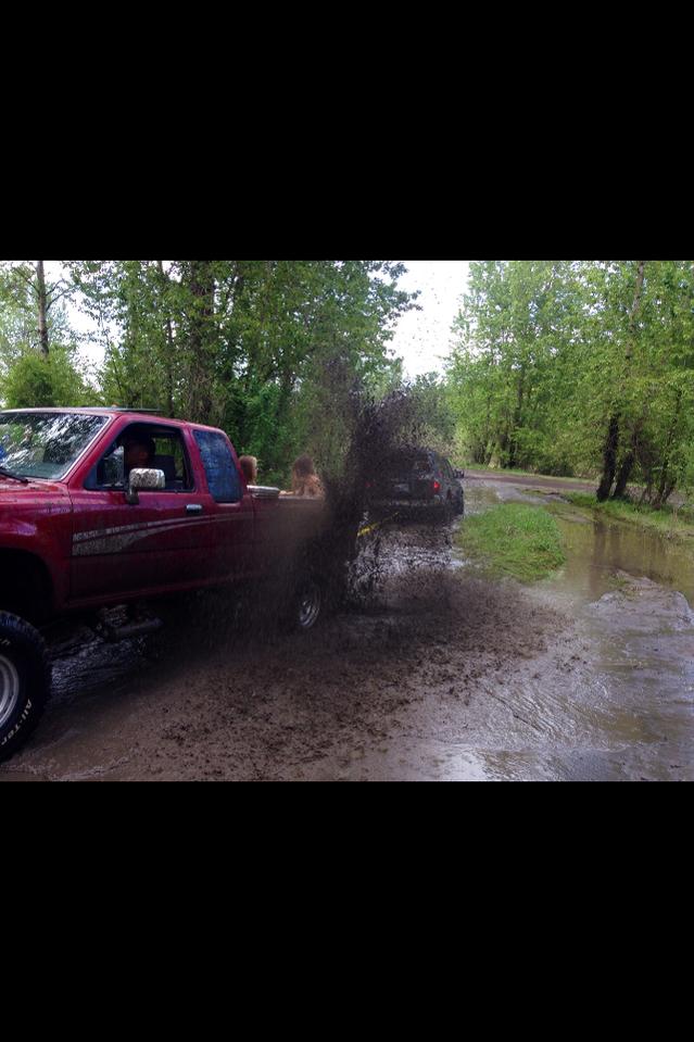

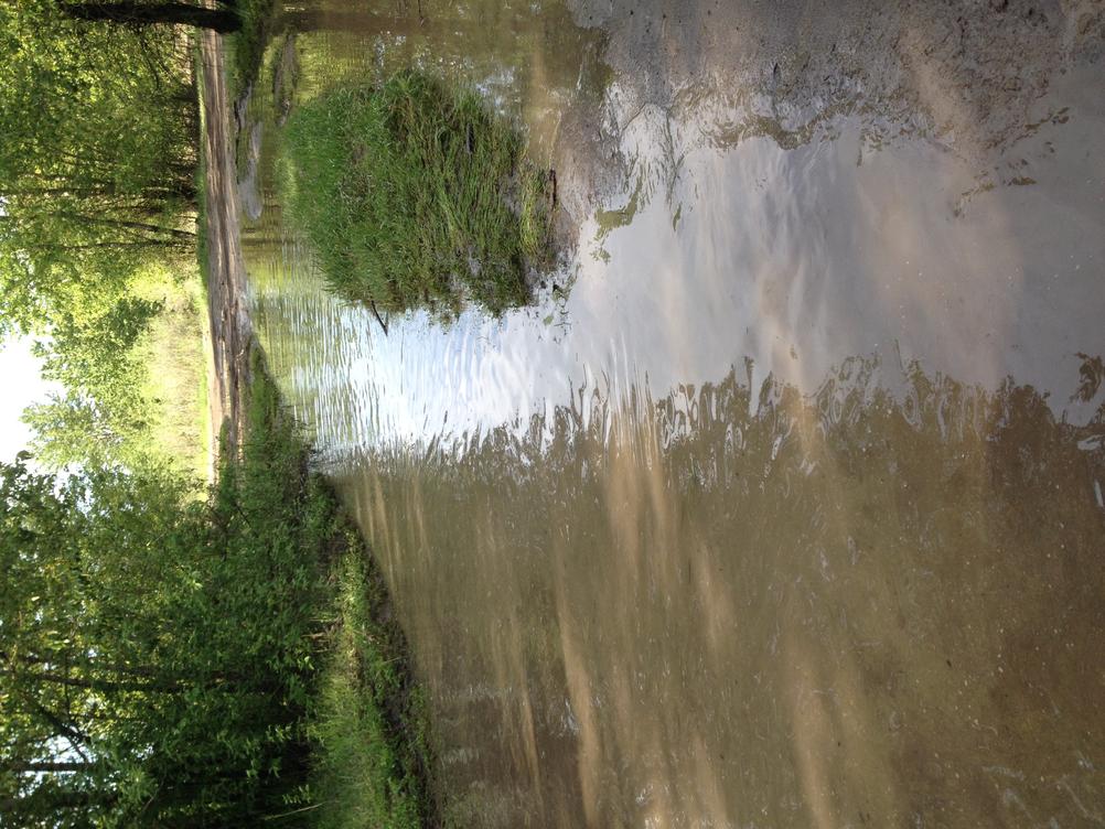

hit a hole. hole won. water got in the doors. Kept coming.. and coming.. I was freaking out right now. Adrenaline really was pumping out of my body. too bad I couldn't hulk it out of there with my mighty strength!
I got out probably after 4-5 minutes. The horn started going off while I was still stuck so we were working with that too. felt like forever to get out.

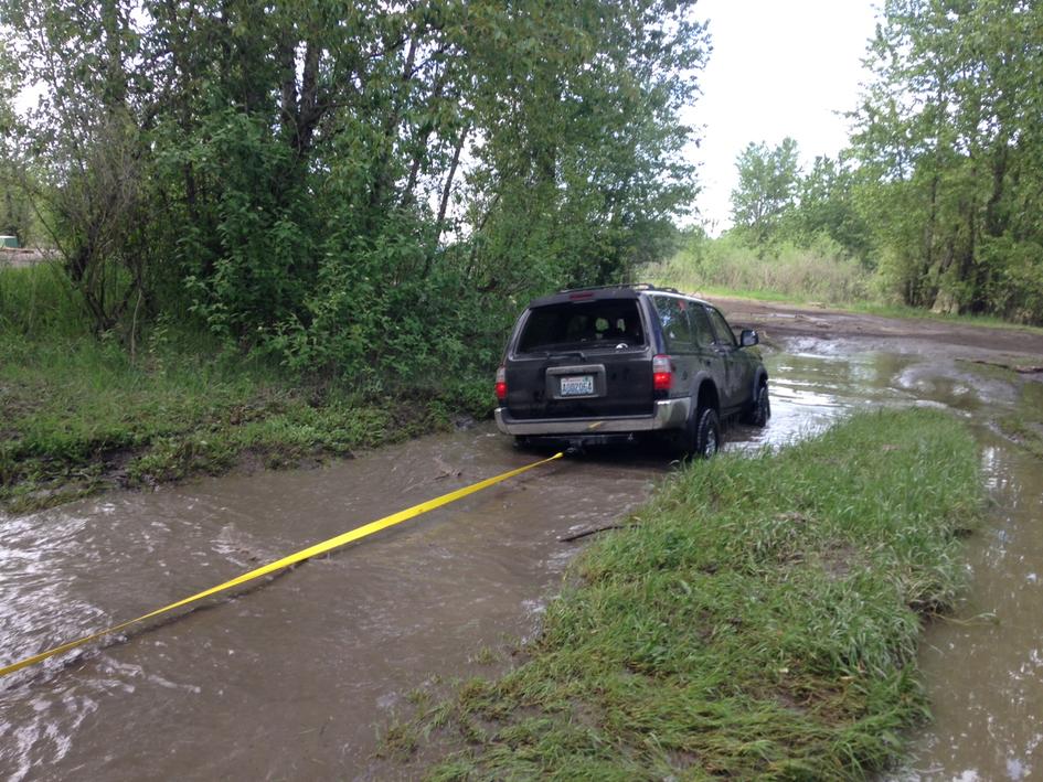

truck died by this point. my friend got me out and towed me in the sun. we unhooked the horns because damn.. annoying!
Some rednecks helped me out a bunch showing me what to do.

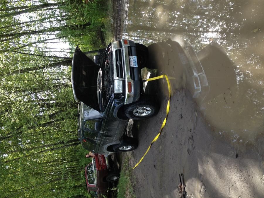

After it dried for 2 hours we tried jumping it and i'd turn the key and it wouldn't make a sound. got towed out of the sand by sunset by a ford excursion, he had a tough time getting me to hard sand but once I was on the wet sand it was easy. called mom and her fiancé, he come and it started right up. must of needed to dry more...
I think everything is fine right now except one thing. I'm so lucky water didn't get anywhere else.. the alarm computer under my seat is pooped on. My passenger fender was way in the air and deckplate was in so no water went up there. and exhaust was over the water. I'm very lucky..
