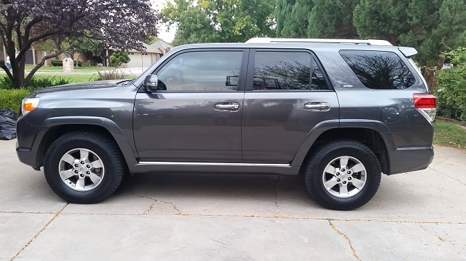

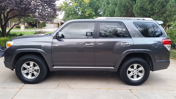

It's done. And personally, I think it looks freekin' great (at the 1.75) setting. I'm not at a spot where I can do a full post with before and after comparisons, etc. But I will post an after pic here in a few mins.
This is about the best I can do guys on quick notice... IPhone for now.
I'm betting once I do actual measurements, there MIGHT be about 1/4 (in) negative rake... But coming from one seriously OCD a-hole, I'm telling you from flat ground on a visual perspective, you cannot see it at any angle. If anything, the eyes play tricks on you and still seem to sometimes show some normal rake exists (tho I know that's not accurate).
Well, the deed is done and I like! Thanks to [MENTION=65614]Antman[/MENTION] and [MENTION=85467]BobsTrail[/MENTION] for all your helpful advice. Thanks to [MENTION=51725]mybabydaddy[/MENTION] for blazing the trail. So as expected, the net gain in the front is 1.5 inches according to my measurements. The rear increased by 1/4 inch, so basically the same. The overall rake is one inch compared to the original 2.5 inches. I have not driven it long enough to fully appreciate the new ride, but I like what I feel so far. I would post some pics, but the truth is... I don't know how.

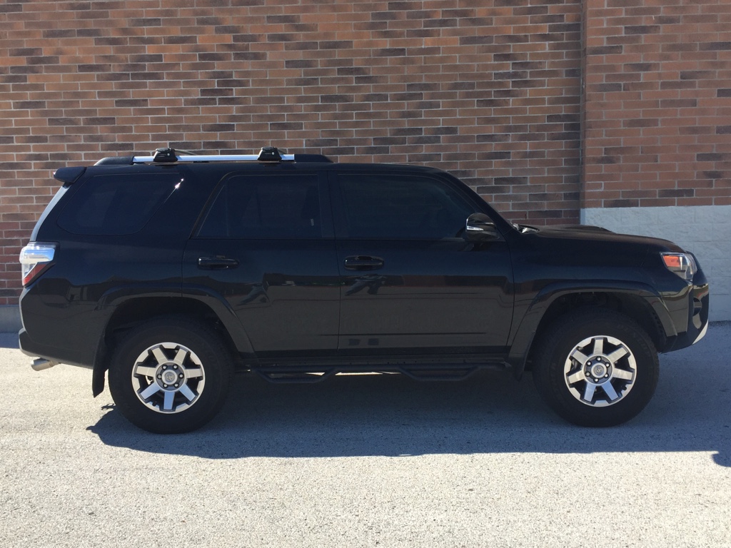

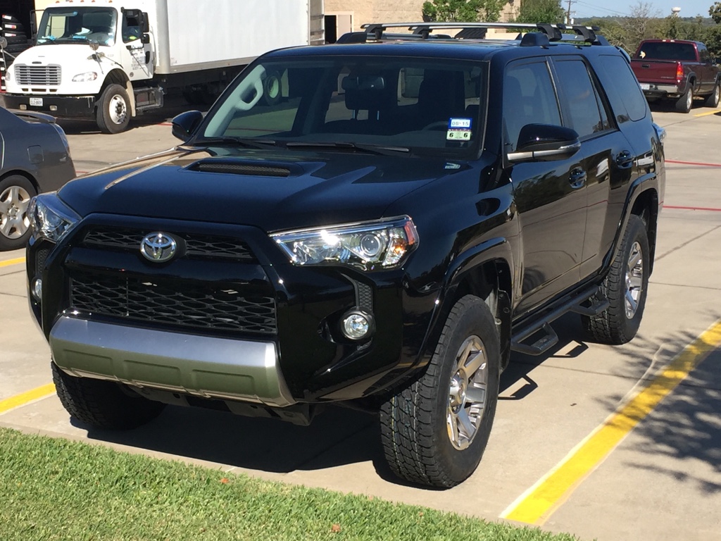

have you got your spidertraxx on in any of these pictures? And who did the install of your 5100s?
Hola. No, no Spidertrax in those... And since then, I’ve gone back and added 1 inch Cornfed spacers to the rear as well. My profile (the post links) have some newer pics with the spidertrax and 1 inch rear spacer lift... but they are all from the side, so you can’t really tell/see the spidertrax difference. [MENTION=127657]codyHTX[/MENTION] has some pics/links that show & compare a stance difference. But I’m here to say, every comparo pic I’ve ever seen really doesn’t do the (difference) true justice. You have to see a Runner with them on in-person to really understand the look/difference.
Also, in 100% complete honesty, I love the spidertrax look/stance; it’s so much better especially running stock rims... but I’m still not sure I’m leaving them on permanently. Just going to keep mulling it over for the next several months...
Sorry (edit)... All installs were done by All Out Off Road in N. Richland Hills TX. They just opened their shop up here about a month ago. Good peeps. I would love to do all this stuff on my own... but my free time is few and far between these days with my job and two young kiddos.
