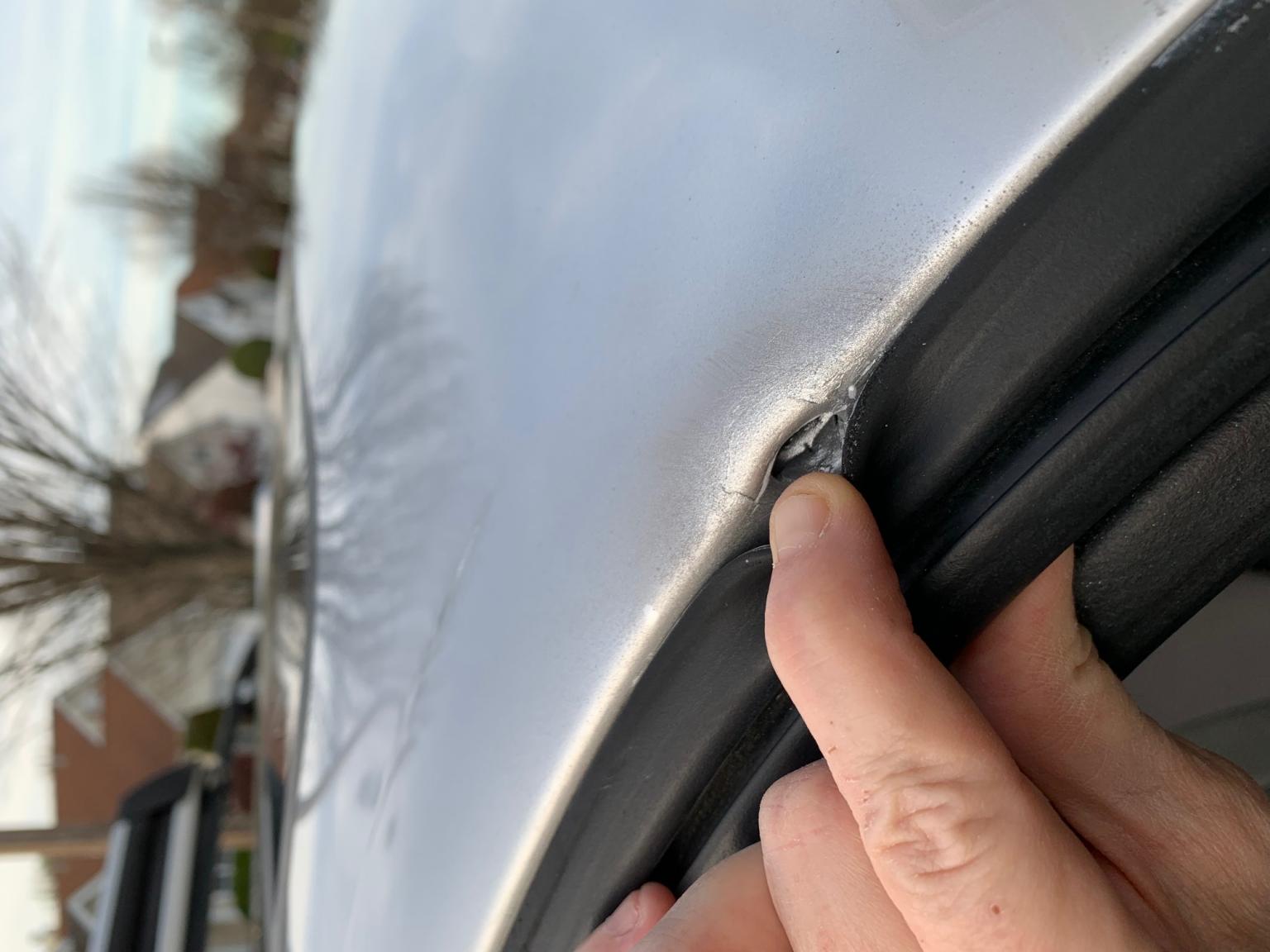

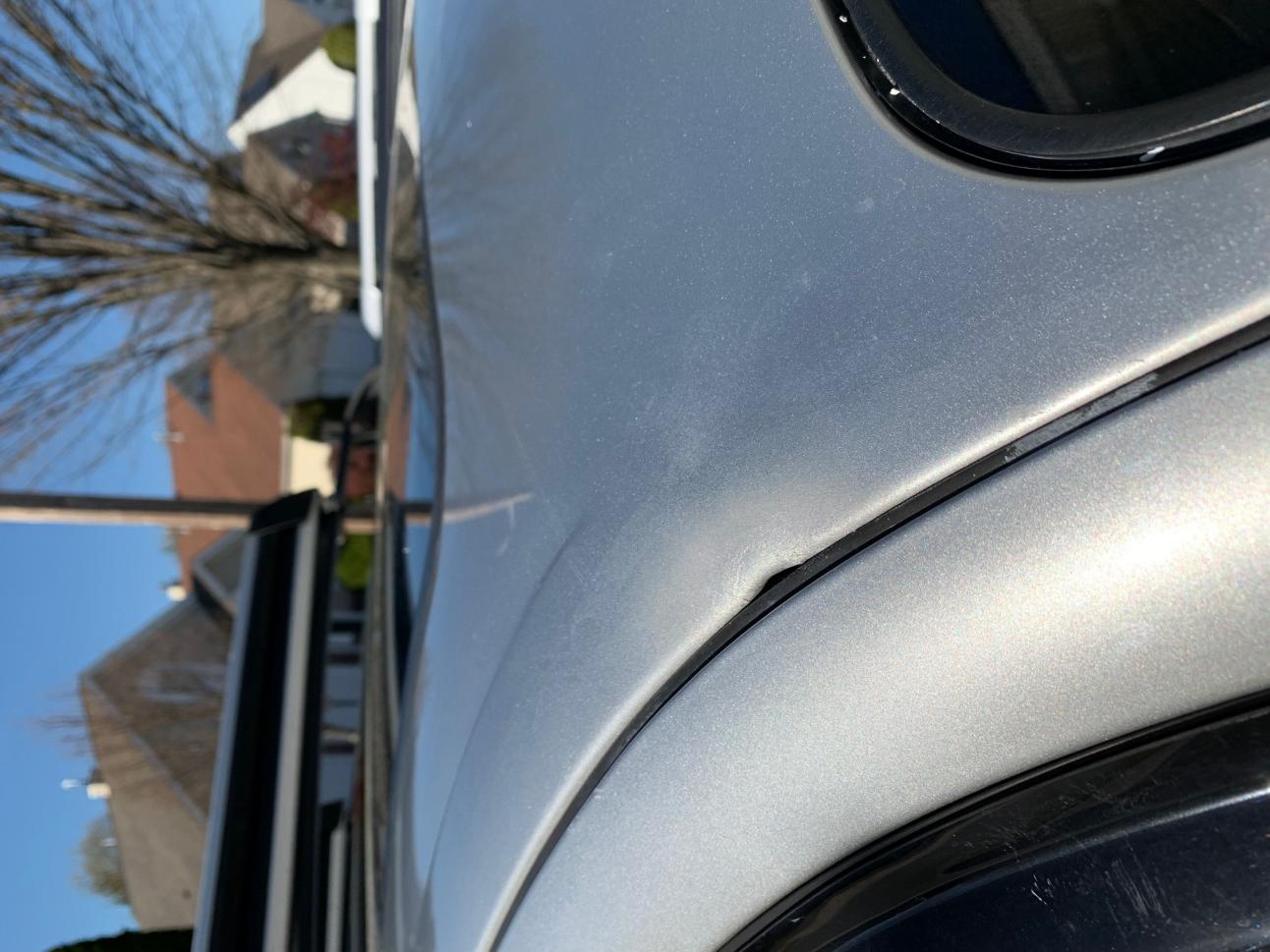

I thought my heart was in the right place. The guy seemed honest up front, his truck, wrap job with Paintless dent repairs looked legit on his shiny new Bronco. This happened last Friday, I was at Costco, saw him driving around the parking lot while he claimed his wife was shopping. I asked about a price quote for 2 dents, one on the hood and one on the roof. He then said he'd do it for cash since he was driving his bosses truck. I gave him 80$ cash, came out ten minutes later and he was done. He put a white putty all over the repairs and told me not to remove it for 24 hours. When I took the putty off the damage was worse than before.

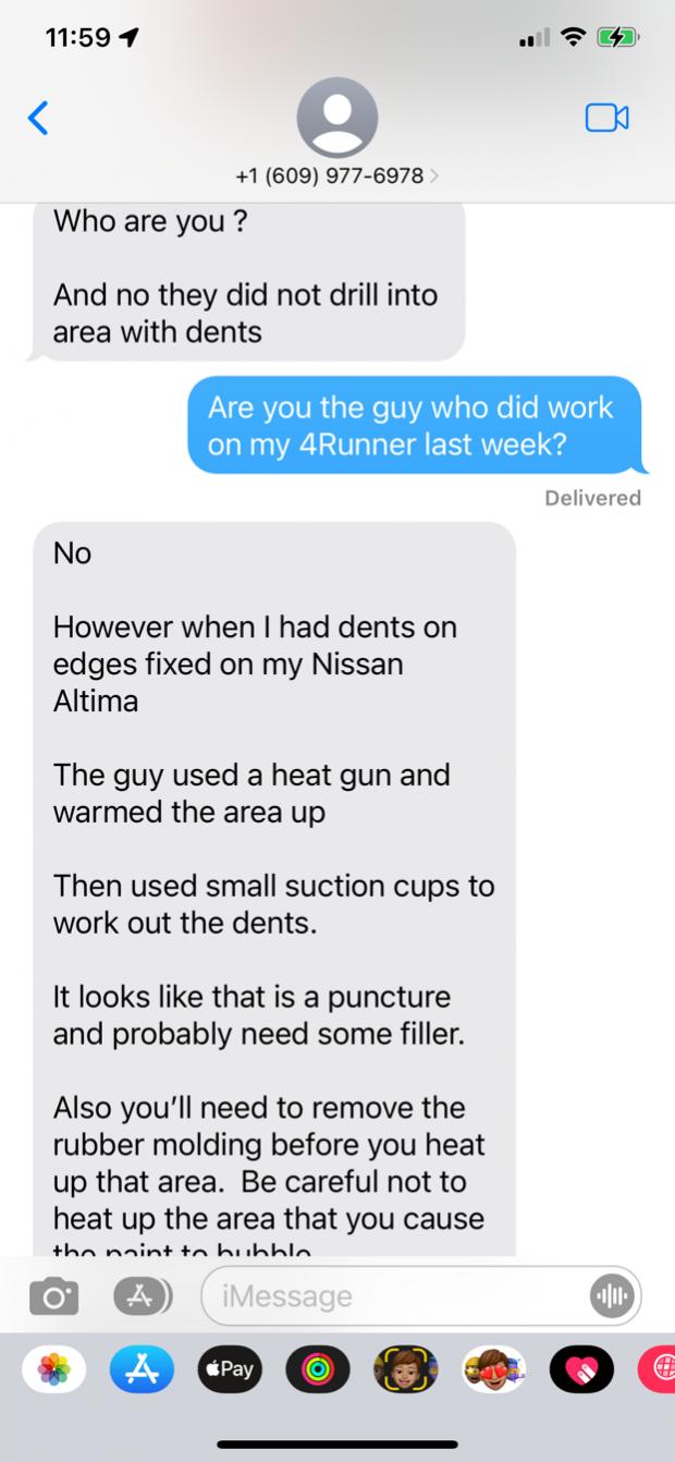

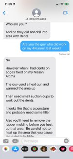

With all that being said, since I paid him in cash, no receipt....am I screwed? I took pics of the damage and texted him. He ghosted me for 3 days and texted me back today saying he never did work on my truck, but as you can see from the text he clearly knows what I'm talking about. I have his name and address. I don't know what steps to take next, if I even have a leg to stand on. Is it worth asking Costco for video footage if it's even possible they have it? I'm at a loss as to what I do next to get this rectified. Again, I know this is MY mistake by trusting someone. The dents weren't huge (to begin with) I'm sure all third gens have some dings but the damage now seems excessive on the roof. From his text, he seems to know a lot about this for a guy who claims he's never worked on my truck. Any advice is appreciated.

My buddy has owned a super successful paintless dent repair business for over 20 years and I have never seen or heard of him putting putty over his repairs and no amount of heat could fix that body damage. Paintless dent repair guys don't fix dents/body damage like I see in that picture. He should have refered you to a body shop. Sorry for your losses but I'd stay the hell away from this guy.

It sounds like you don't have a leg to stand on because you really don't, honestly. You paid him to do an amateur attempt, which he did; he made no promises and from what it sounds like, did not mislead you whatsoever. And without very clear documentation to show they worsened the damage or anything to prove the transaction even took place, you might as well accept it and move on, as nobody will take this seriously as a legal case. My advice is to just ignore it as that's extremely tiny and in a very inconspicuous place and by no means worth the few hundred someone would charge to properly pull and fix it. Let it be a lesson that with body work, you absolutely get what you pay for - zero exceptions.

Thank you Devbot, with what you said about it being tiny and inconspicuous, I can live with. Do I need to worry about any further damage it may cause, rust, oxidization...anything of that nature I could band-aid up before things get worse, if they do.

It looks like it's a little punctured, so if it was me I would squirt some black silicone in there to plug it and call it good. Weatherstrip adhesive would probably work decently and hold up to the elements, and help keep that flap down. But that's just how I would address it

On the body work side of things. Silicone does work. Also any hole in metal that goes through the sheet metal. You can scuff up and seal with fiber glass. Then put a little body filler on top of it. Body filler can not take water. It's only used for leveling basically. I have used both. :)

Thanks Dev, any thoughts on the JB Weld metal filler putty? Or do think silicone will suffice? I don't need it perfect, Ideally I'd just like to close the hole and cut my losses.
