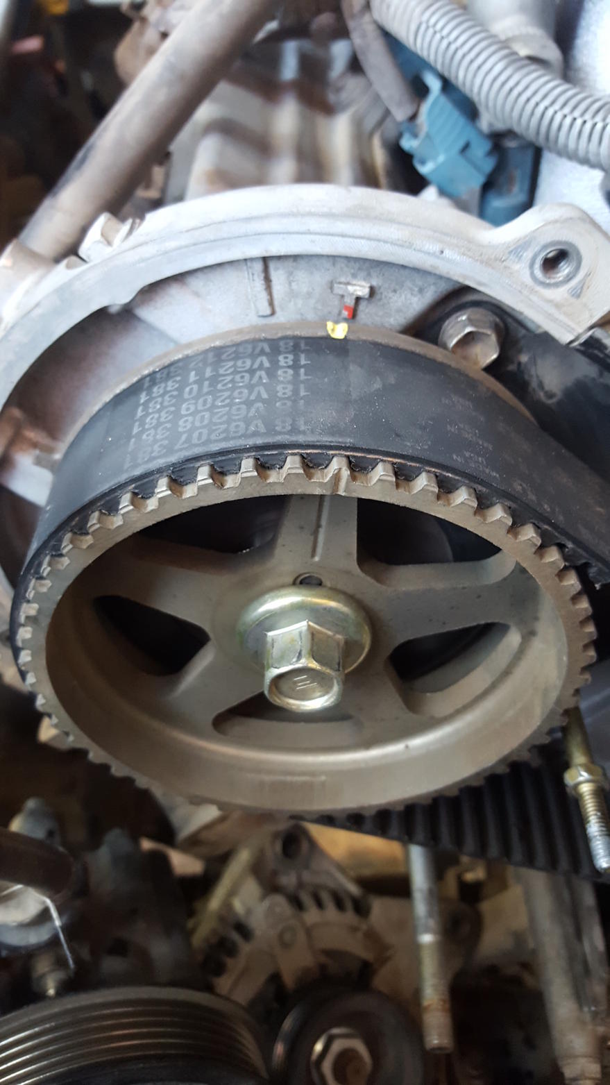

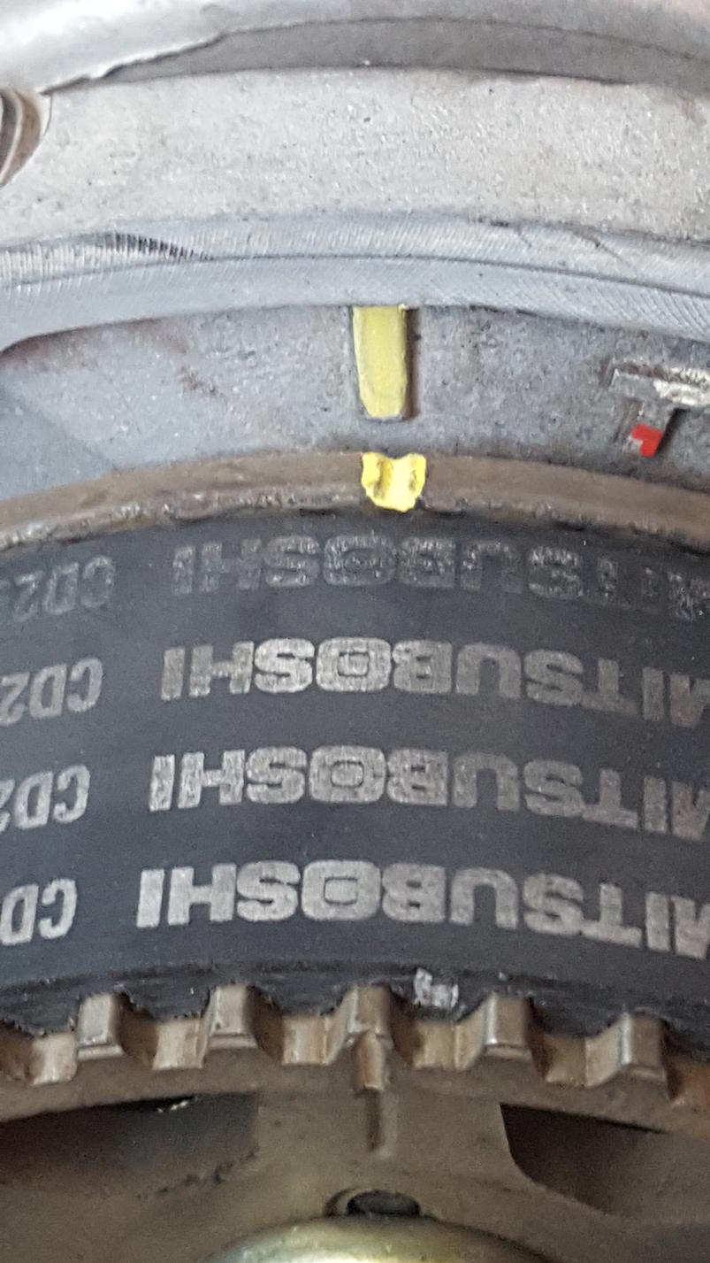

Well, she is purring like a kitten again. When I did the timing belt, I used the wrong indicator for cam shaft timing. Once this was corrected, she got her power back and no more of that funky sound coming out of the intake.
Even though I read the threads, watched the vids, don't know why I saw what I wanted to see vs what I should've seen when it comes to the timing marks. The downside to re-doing this project was that all of the nice arrows and marks on the timing belt wore off since I've been driving the Runner. But, with some careful tensioning of the belt over the two cam sprockets and tight around the crank sprocket, all is good now.
Don't use the "T"
Do use the "I" mark for camshaft timing mark
