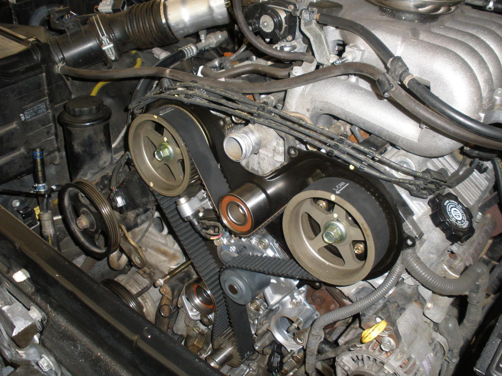

Well, The weather's finally improved enough for me to start multiple projects. Beside the much anticipated Supercharger addition and the timing belt, etc, replacement, after a couple wheeling trips, I decided that I needed a winch. Since I'm planning on working only a few hours a day, it may take me a while. As a matter of fact the Timing belt, etc job was a ..... PAIN, took about 10 hours, a lot of which was trying to get the crankshaft pulley off!!!
This is why it's a good idea to have the first timing belt change done by the dealer/mechanic. That way they can break the factory torque loose. Then the owner does it the next time around.
BTO, wish I knew that before starting the project, ended up taking the radiator out in order to use air tools, no go, finally got the bolt off with a 4' pipe on the socket, then the pulley wouldn't come off, needed a steering wheel puller
Glad to see an update from you Four Flusher, I was wondering what's been going on w/your rig lately. Great work on getting the timing belt done on your own.

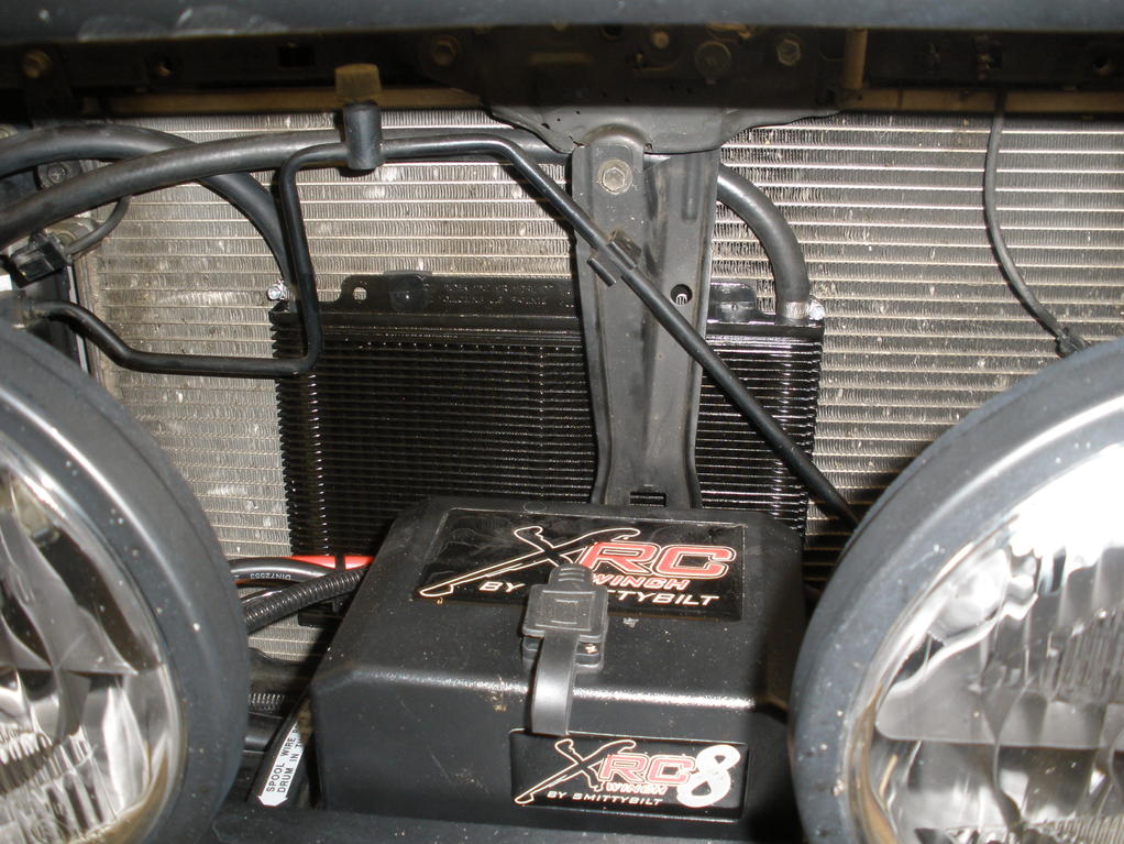

A couple of weeks ago we started installing the SC and it was going smoothly until stupidly we tried to force the main tensioner bolt without chasing the treads in the block, bad idea, the hole in the motor cracked and it was over for the SC install, after days of being bummed we finished the timing belt, so I'm happy my ride's back in action, we got the winch mostly installed today, oh well!

I installed a B&M 70268 tranny cooler today, and as you can see I installed my winch a couple of weeks ago

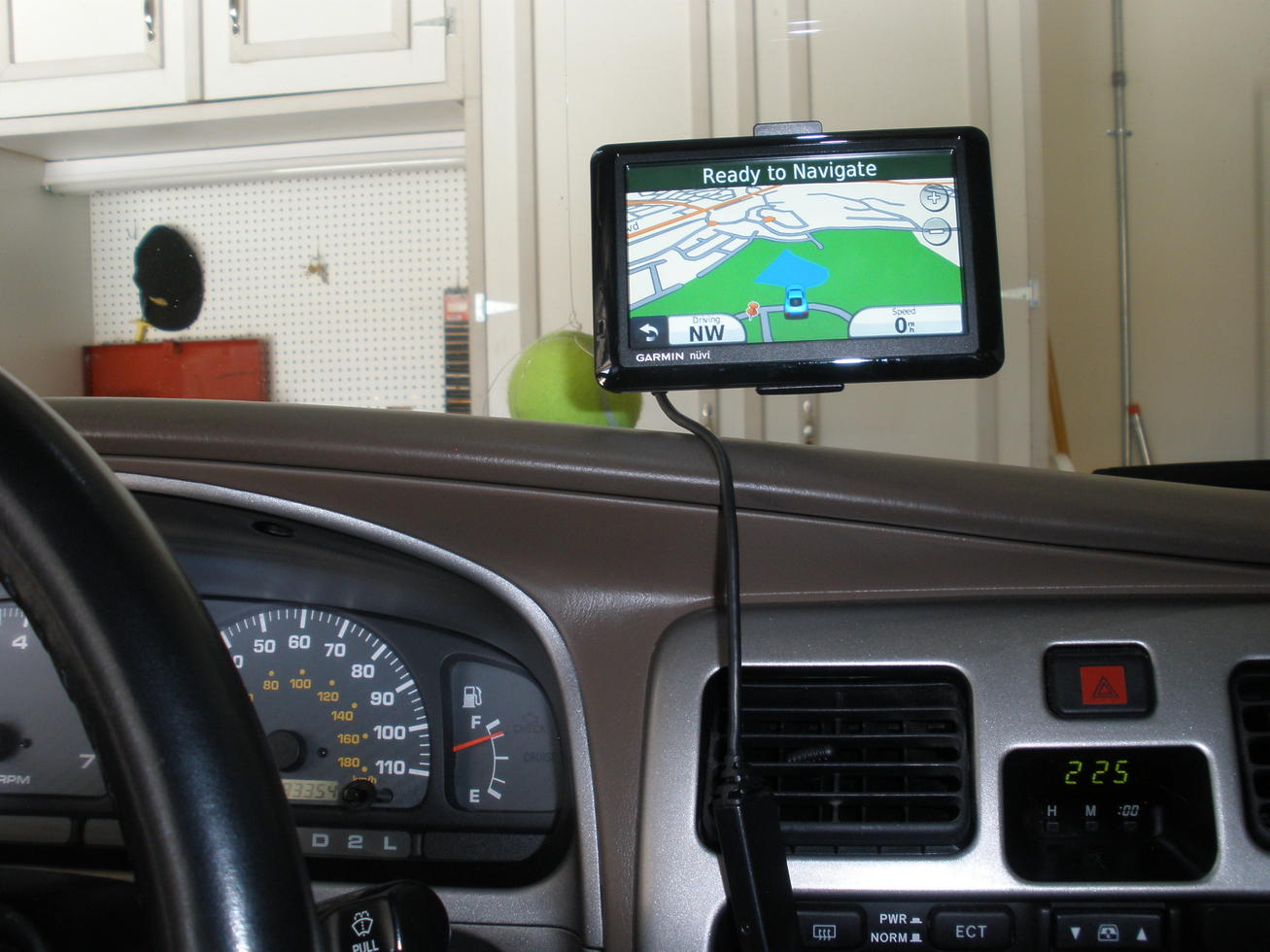

Nevada's a "hands free" state on October 1, so I purchased a Garmen-Nuvi1490 (from their factory store for $189 shipped) a very sweet unit, but I hate the hanging wires, anyone done an install that looks good? I'm thinking about mounting it above the left vent by the clock and running the wires behind the radio and the plugging it into the cig plug, ideas?

Nevada's a "hands free" state on October 1, so I purchased a Garmin-Nuvi1490 (from their factory store for $189 shipped) a very sweet unit, but I hate the hanging wires, anyone done an install that looks good? I'm thinking about mounting it above the left vent by the clock and running the wires behind the radio and the plugging it into the cig plug, ideas?

And I do have a solution to the wire problem. it was the same thing about my radar detector that caused me to do this mod. I added an extra power socket under the drivers kick panel. Then ran the cord down the door jamb and under the dash.
See here!
It looks a lot more complex than it really is, let me know any questions!

i put my gps on the left lower corner of the windshield and there are areas you can hide the wire all the way to the outlet. everything is looking good man!
I have a Garmin Nuvi 500, and I hate having the cord hang down in front of the stereo too. I just ordered a Garmin Nuvi Hardwire Kit off Amazon for like $12. I plan to run the wires behind the dash and connect to the cigerette lighter wires.
