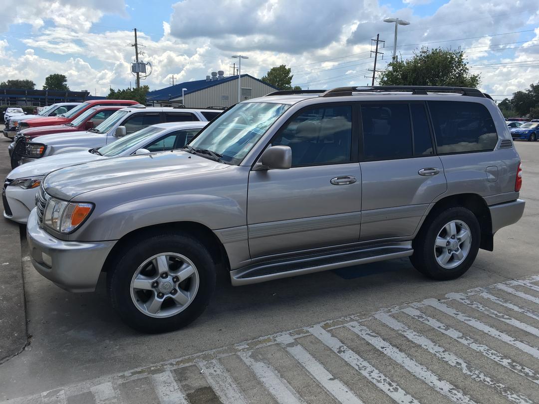

I sold my wife's 2000 4Runner 2wd and got her this
fblainen11
2005 Land Cruiser 4wd today. Actually I'm selling, it's not sold yet.
If you look in the background you can see her silver 2000 and my red 2001 4wd.
Incidentally there's a new FS thread in classifieds.
Momma likes

Nice!
I just recently bought my first 4Runner, and I'm hoping to get my fiance a 90s Land Cruiser as well, but I'm not sure she'd be game for that.
Nice find. got more pictures?
I also got a 2000 cruiser 3 months ago. Register at forum.ih8mud.com to get great information about cruisers.
These 100 series cruisers have loose front-end drive train. Currently, I have lowered the diff and found nothing wrong. It is the old CV's and flange at the wheels (no 36 mm nut at the end of the CV so it is moving and wearing out the flange) that seems to be the issue.
Also get two new T-fittings on the heater coolant lines (located by the firewall)
You have VVTi engine so getting the cam oil seals is not fun. The motor is interference so get the timing belt done if not done in last 100 K miles. I went with AISIN kit that has Mitsuboshi timing belt, AISIN water pump and Koyo bearings.
Other than that this thing is a beast! Lots of power!! Enjoy!!!

Just started lurking and bookmarking there.
There may be an issue with the driver side CV the dealership said. I haven't noticed it, but I'm brand new to the platform. I think I want to tackle the fluids first.
Listen to the front of the vehicle while shifting between R and D. You may hear a loud bang when seated inside. That is the loose drive train. The fange is about $52 a side and CV OEM is $350ish, aftermarket at Advance auto with a discount is $59 with free shipping.
