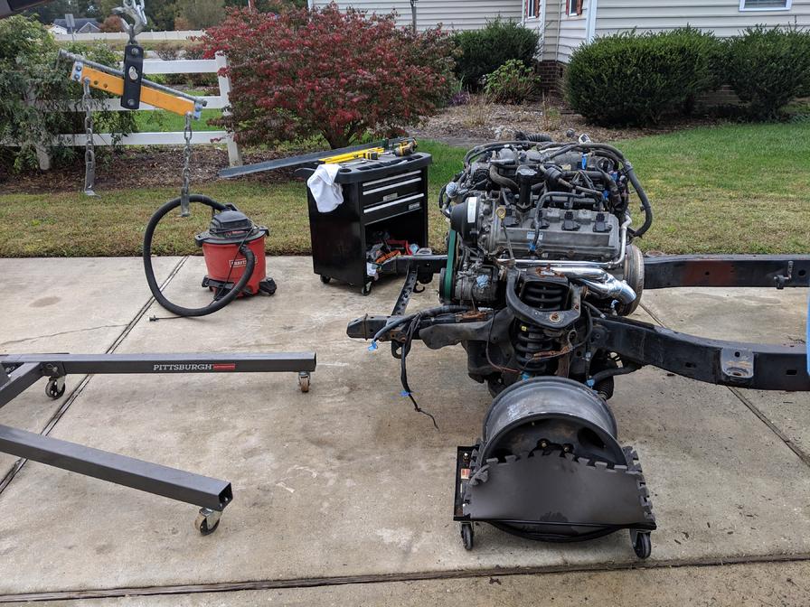

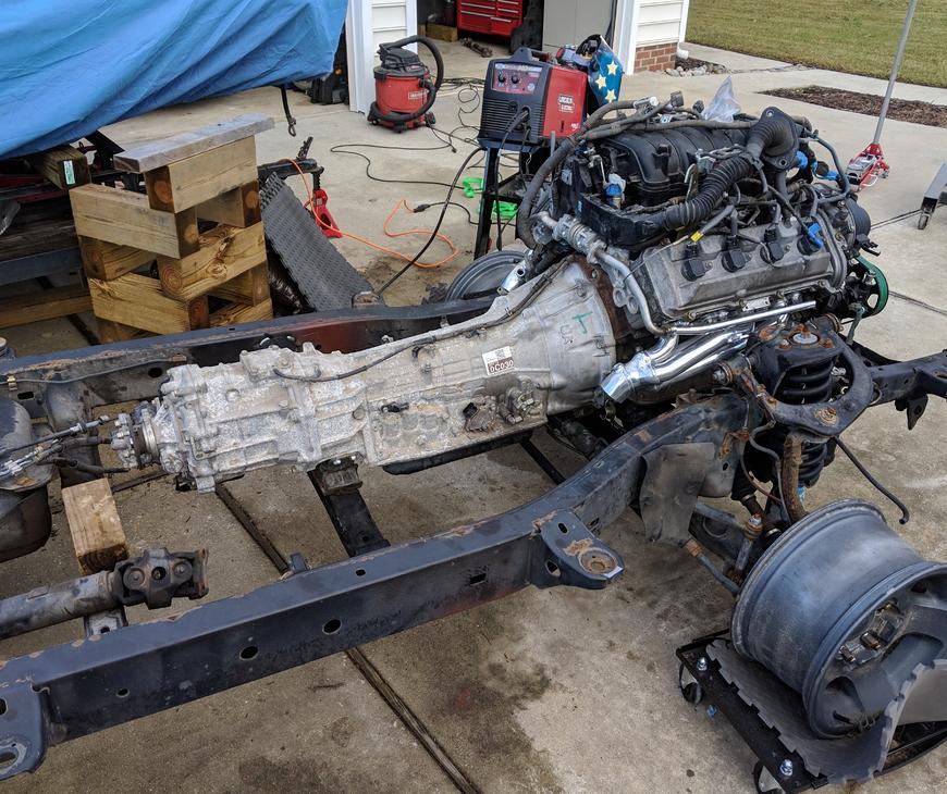

Welp... the SC has been removed and the 5VZ is starting to be removed to make room for the 2UZ.
SC is being shipped today so no going back now.
Slowly but surely I will finish
