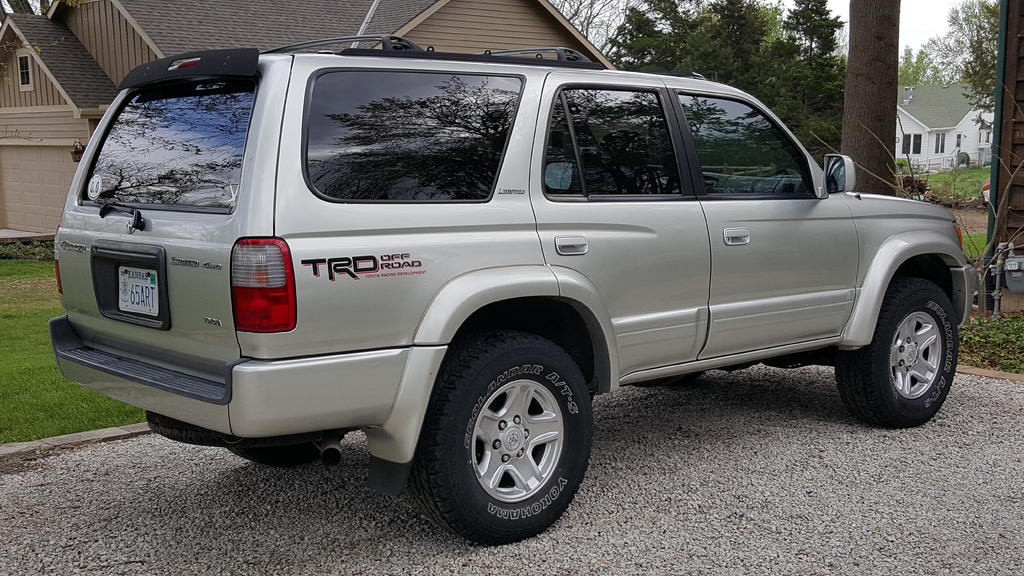

As some of you know I just picked up my very first 4runner!!
1999 limited.
I am NOT a mechanic by anyone's definition!!!!
I had my mechanic do:
*Lower ball joints
*Water pump
*Timing belt
*drain flush tranny and radiator
I replaced the air filter :high5: maybe I AM a mechanic!!
I bought plugs, and wires, sway bar bushings, and two sway bar bushing end links, as the one on the passenger side was in need!! * I hope they aren't specific to either side, I just ordered 2 of the ones recommended!
QUESTIONS.....
I am going to be taking it MILDLY off road in October for an antelope hunt in Wyoming. In the name of reliability or suspension and drive-train what would you be checking if you were in my shoes?
Are coil packs something that is a maintenance item or just wait til it breaks item?
ALL of the fluids are new to include diffs.
Doesn't appear to have any sag, but I'm not hauling any weight for my hunt (hopefully a cooler full of speed-goats on the return trip).
Frame is good.
I just don't know what I don't know.
Thanks guys!!
Don

Well this is the joy of owning a Toyota. You dont have to really worry about much but general maintenance. Research pink milkshake where the radiator fails destroying trans. Lower ball joints like to fail which I see you have done. Rear axle oil seals like to leak but if you brakes are dry I would not worry abou t it.

Good question. Yes, this is a place where bypassing the trans-cooler in the stock radiator can benefit you under normal driving. But, I would say that, if your radiator has been replaced any time in the last 50,000 miles, it doesn't need to be your highest concern.
Lubing the drive shaft joints is another area that would be good maintenance.

That's a great looking truck. Looks very clean. Where in wy are you pronghorn hunting? I live in Cheyenne.
Your coils don't appear to be sagging, like you said. And it looks like you've covered the necessary maintenance. As long as the shocks are good you'll be fine off road. A stock 3rd gen will do mild mountain trails no problem. I've done many of the trails in the mountain range near Cheyenne and my truck is basically stock.

I'd take off the side TRD decal... I had one but then realized it was dumb because it's not a TRD so why have it and it just looks a whole lot cleaner
