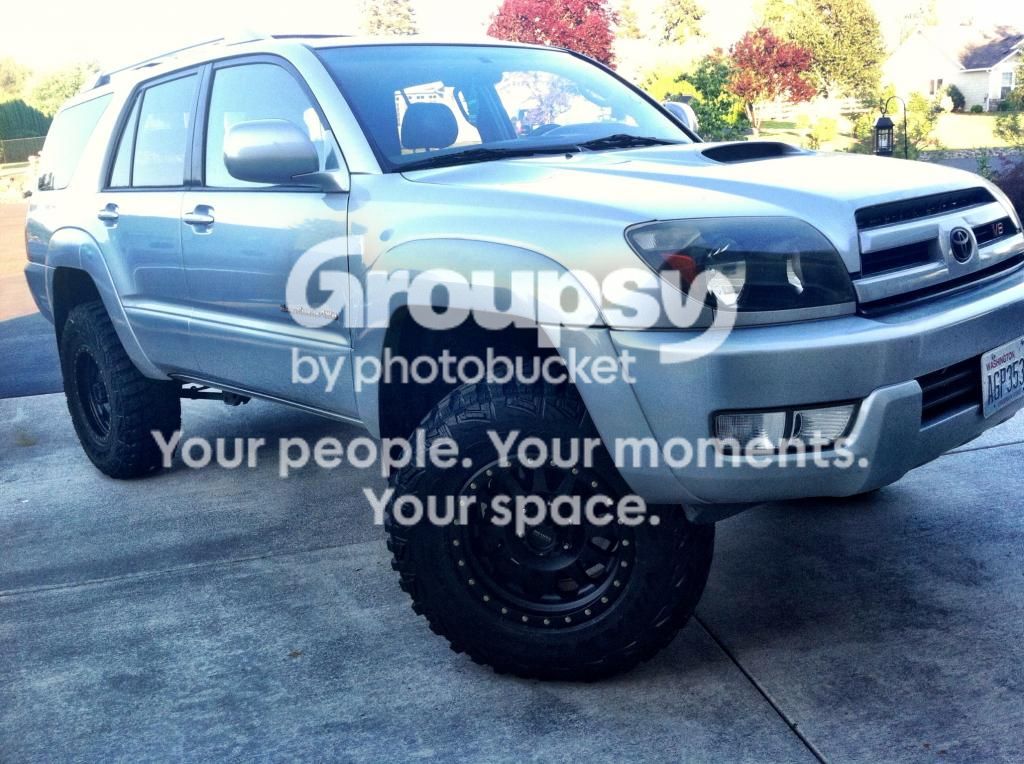

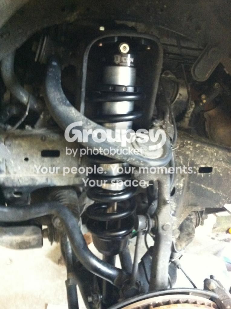

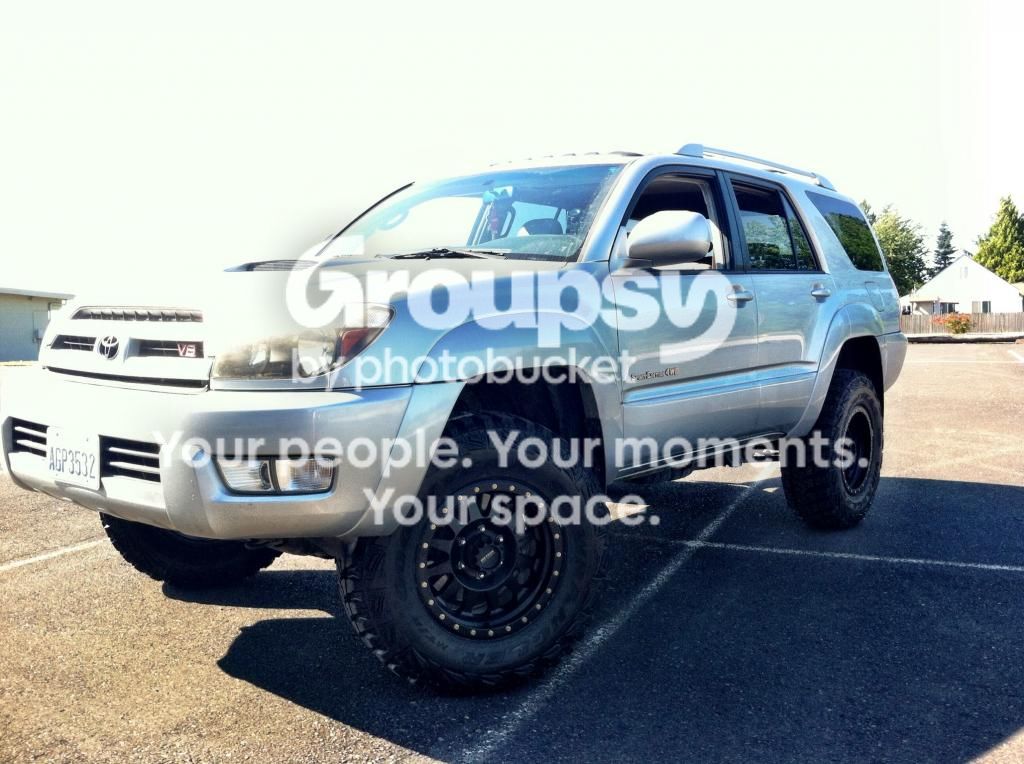

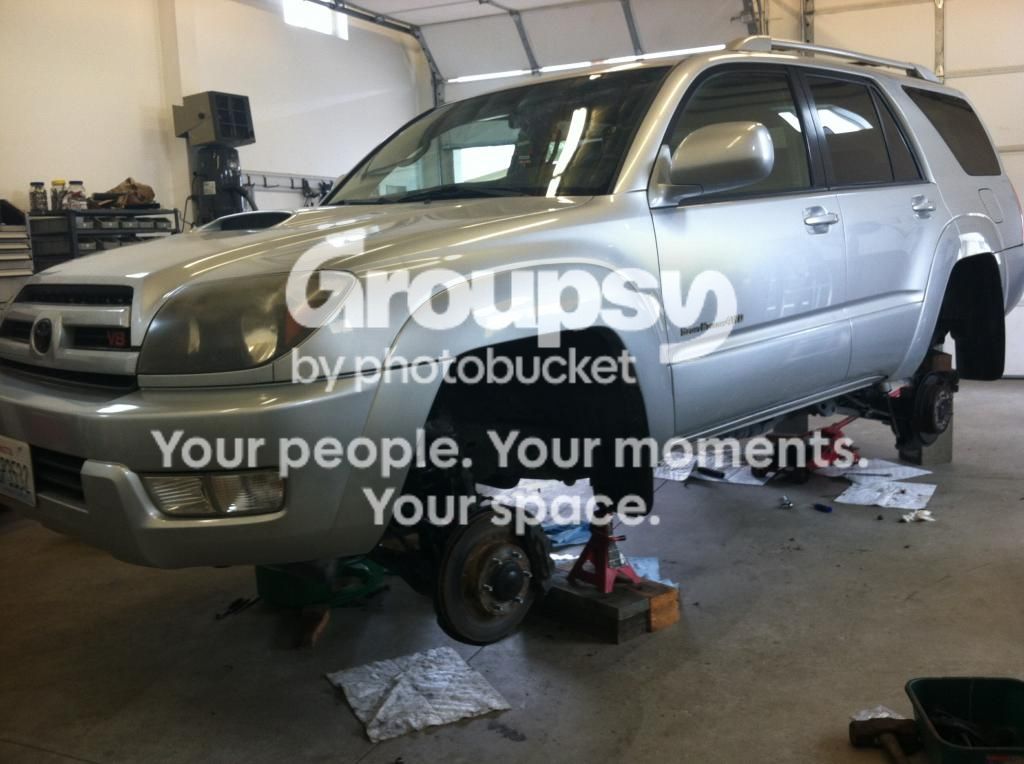

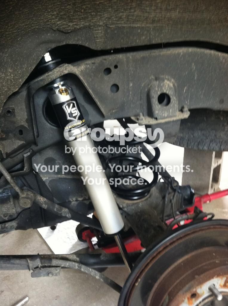

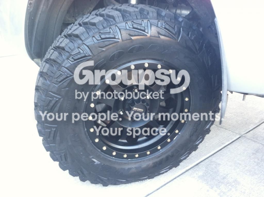

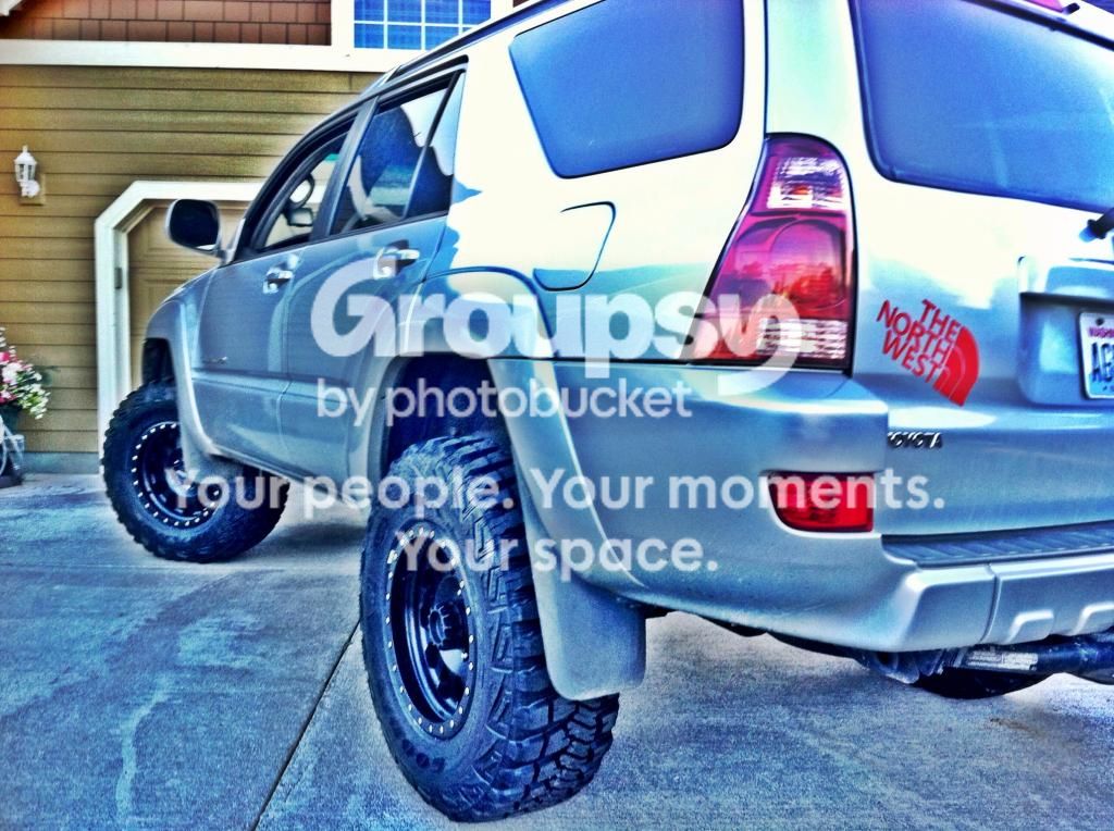

I have had the lift installed for a couple months now, and im loving it. Tires are Goodyear Wrangler MTR w/ kevlar, 285/70 r17. Wheels are method double standard in the 17" variety. So far I've had one little snow run on the setup and really liked it, theres a little rubbing, in flexed situations but nothing to bad. Any how heres some pics!

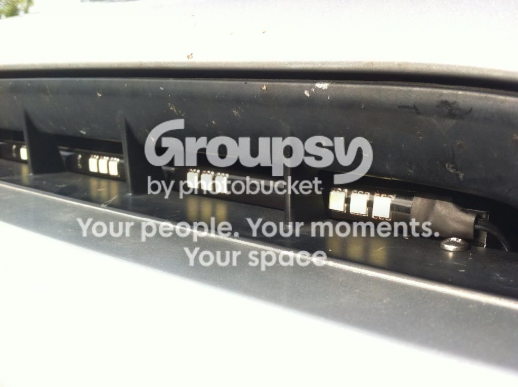

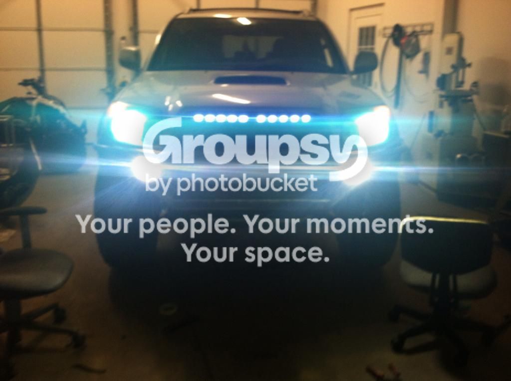

i am also interested in the light bar in the grill if you'd like to elaborate:cheers:
Great looking stance though, good choices

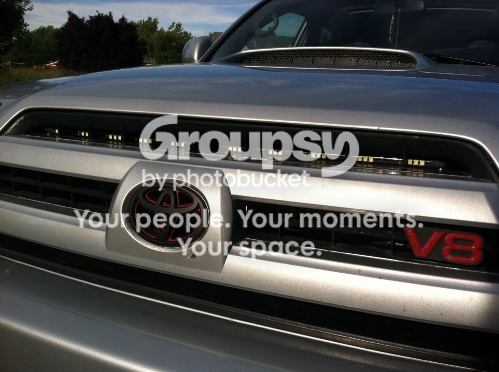

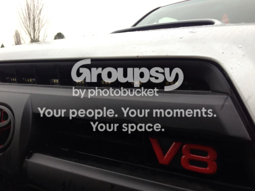

the lights in the grill are just two led light strips that just so happened to fit perfectly between the spaces in the grille. I just mounted them onto a small piece of angle then screwed them into the grill, and spliced into my running lights. I like how they worked out, almost give it that raptor look. heres the few little pics i have.

they hide real well since i blacked out the grill.

Nice! I just installed same kit today. Too tired for pics, but I'll get them up soon.
One thing. I noticed in your pics that the fronts MAY be installed differently than the instructions recommend. The spacers on the lower mount are two sizes. The big one is supposed to go toward the front side of the vehicle. This gives a little more space between coil and sway bar.
Your pic makes it look like you have the small spacer in the front. I wouldn't have noticed if I literally didn't just finish mine an hour ago.
