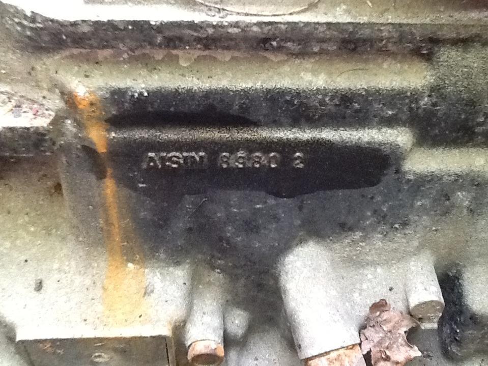

Hey
Which one?
Which one what? You're looking at obscure part numbers most of us don't pay any attention to because it isn't that hard. GSGALLANT already told you how to ID your transmission - one pan and an integrated transfer case is the A340H, two pans with a separate transfer case is the A340F.
I'm fairly certain that it was the A340F that came behind the early 22RE motors, but if you're unsure, count the oil pans.
