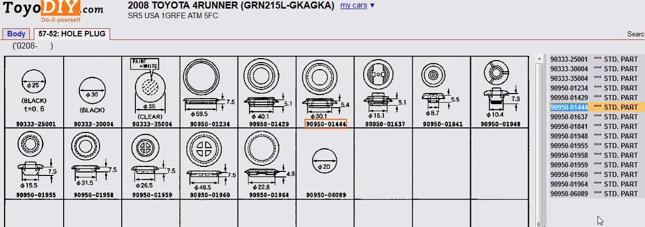

I think this is the plug you need. I agree, it's difficult to find. It's not shown on any parts diagrams for the lift gate or the spoiler. On mine, the plugs have Ø30 written on them which I'm assuming means it's a 30mm plug.

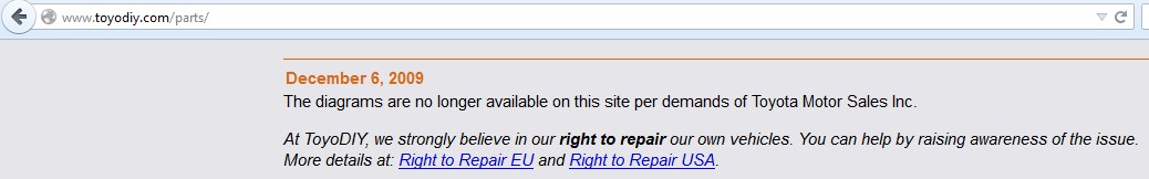

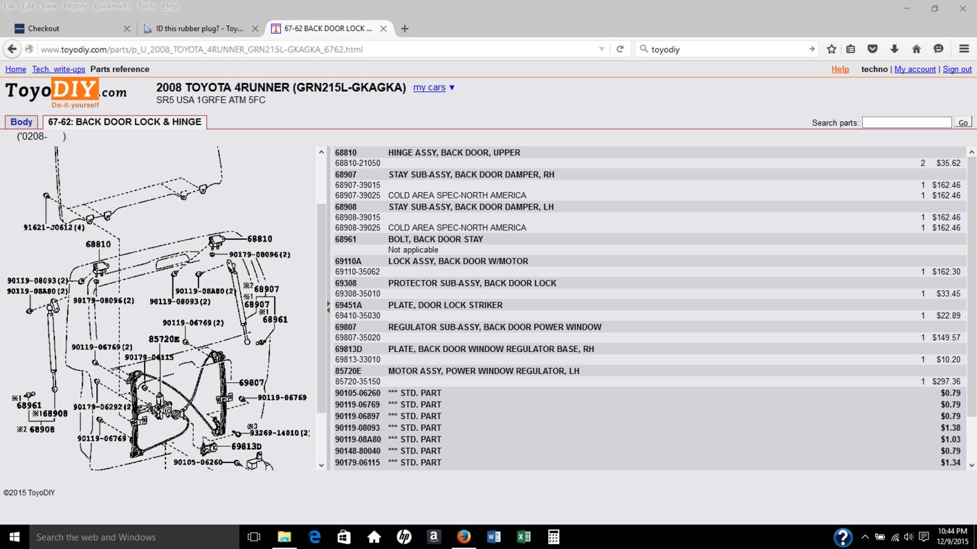

I see full diagrams on toyodiy. They also link the descriptions to the diagrams.
Are you sure? It's weird because on Toyodiy I can only see the lists of parts with no diagrams at all. This info is taken directly from that site:
Yeah, I've always had diagrams, but I joined before 2009 so maybe that's why.
Bullseye! Many thanks! Now I hope it costs less than $30 ;)
