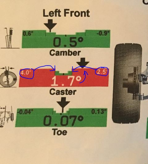

The alignment sheet says where it is at and which numbers it should be between.
For Caster it says between 2.5 and 4 and the black arrow pointing down shows where you are currently at in comparison to those numbers. You are actually at positive 1.7 degrees.
So ideally you should be at 2.5-3 degrees caster but if you are trying to stuff a large set of tires (35s) for instance, you would want a higher number (around 5.5-6) to push the tire away from your firewall but that has the effect of wearing the outsides of your tires when you turn.

Thanks guys, and good eye. For some reason, I thought that I was at a negative caster. I'm going to have them max it out & if it's still floaty, I'll look into some ucas.

Thanks man. So I'm guessing that it's between negative 4 and positive 2.5, because if the arrow shows where I'm at, it doesn't make sense if both outer parameters are positive. I guess I had that backwards. Also, if the arrow shows where I'm at, it doesn't make sense if both outer parameters are positive.
I thought the same thing for a little while too. The min and max are not at the far sides of the bar (where the numbers seem to indicate). They are actually located at the little steps inside: where the green zone is inside the red Caster bar for example.

Ah, now it makes total sense. Thanks!
