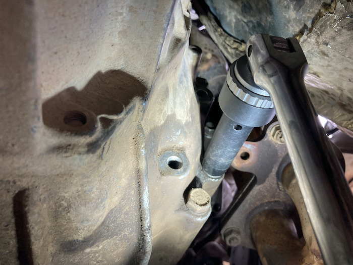

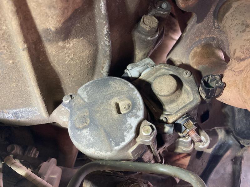

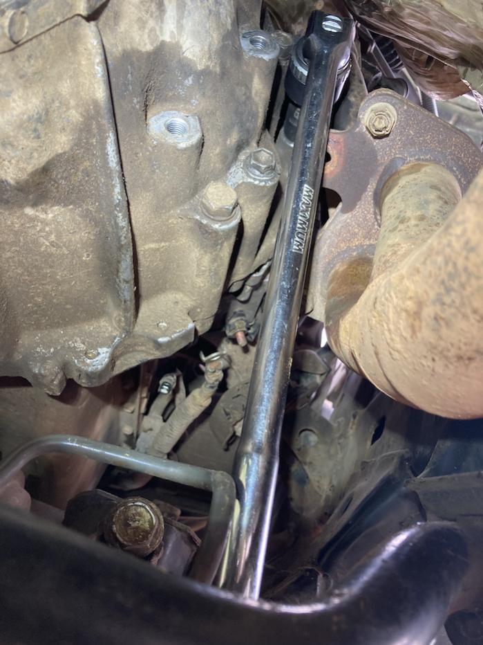

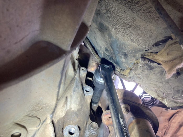

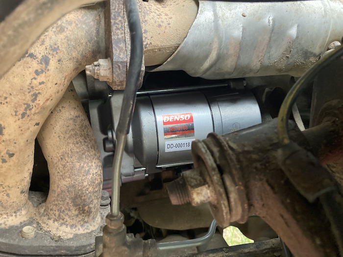

I did the starter on my 97 5-speed SR5 4WD a few weeks ago and didn't have to go thru the wheel well. It came out through the space above the steering rack - I had to flip it around first, and it was still pretty awkward, but seemed easier than squeezing it past the brake lines through the wheel well.
I was also able to get a socket wrench (and later, a torque wrench) right onto the starter bolts without any extensions.

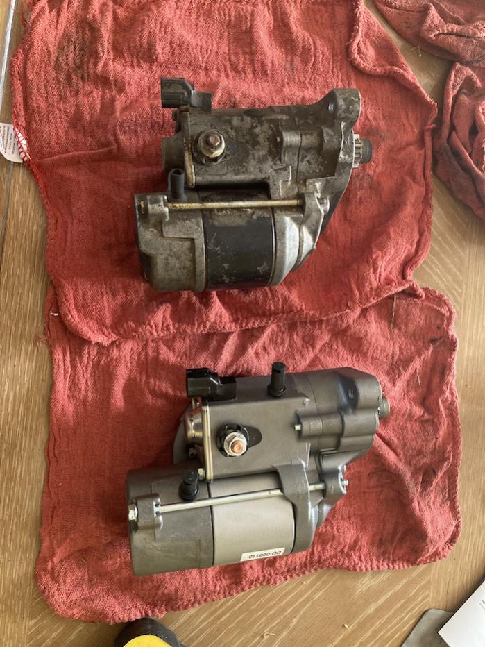

A shitty aftermarket 1.4kw starter came out...a 1.8kw Denso went in. There's a pic of both if anyone is curious about the size difference between them. I was a bit concerned that the bigger one wouldn't fit - I couldn't figure out which size mine originally had. it's a manual, and it seems like those got the 1.4 at the factory, but mine was also sold in Canada and as far as I can tell had the cold weather package (meaning the 1.8kw starter). Either way, the one I took out was definitely not the original. I opened up the solenoid and the contacts were pretty worn down (I was getting the click-no-start thing happening).
I don't know if this was easier because I have a standard rather than an automatic, just wanted to share that it is possible this way!
