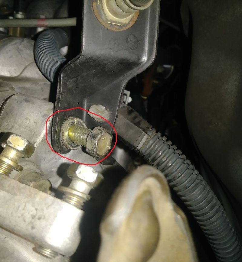

Please help/suggest
I have a 2000 4runner - 4wd - auto - I cannot get the nut holding the tranny dipstick to budge...I've tried PB blaster...the edges are beginning to round... the stupid starter is off, wires are off, brake lines loose, but the dipstick nut will not budge. I also cut off the box end of the wrench and welded a round piece of steel to make a longer handle...but I don't want to round the edges even more...okay guys...someone tell me the magic word.
Thanks
Update...
This is almost embarrassing. I kept looking at the tranny dipstick bracket thinking something wasn't right. I saw how I thought it should attach but it didn't. I got some extra light on the thing (from a different angle) and saw the stupid thing wasn't even attached. It was kinda pinched/forced/wedged into place. I gave it a twist and a pull; it popped out. Took about 45 minutes to complete the task. I feel like an idiot. Lesson learned...get plenty of light. Don't assume the PO or an mechanic somewhere put all the parts back together. I never got the nut off. So I ended up pinching/forcing/wedging the bracket right back where it was to start with. If I drank I'd drink...but, instead, I'm going to go eat some chocolate.:jaw:

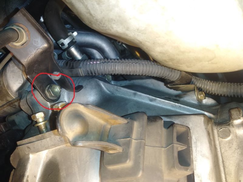

But where is that top bolt?
I came here to find WHERE that top starter bolt is because I can't even SEE it.

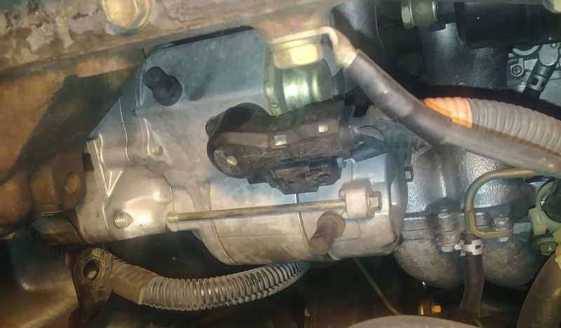

I think I got the bottom 14mm bolt if it's the one on the brake line bracket with the harness holder.
Can someone show me a picture of the TOP bolt?

I gout it out easily once I learned what was in this thread.
As was stated, both 14mm starter housing bolts go in from the transmission side to the front.
The top bolt was easy to find once I knew where to look which was through the driver side wheel where I pulled back the plastic flap and could see the bolt easily with a flashlight.
I couldn't get to the starter bolt due to a coil of hard brake line though
I couldn't get to that upper 14mm starter bolt from below either.
What worked easily was I climbed up on top of the engine and got that top 14mm starter bolt out using just a socket and handle. Nothing else.
It would only move about a 16th of a turn with each twist but that was enough. The starter just fell down after that bolt was removed, so I tucked it off to the side and continued on with my clutch job.
