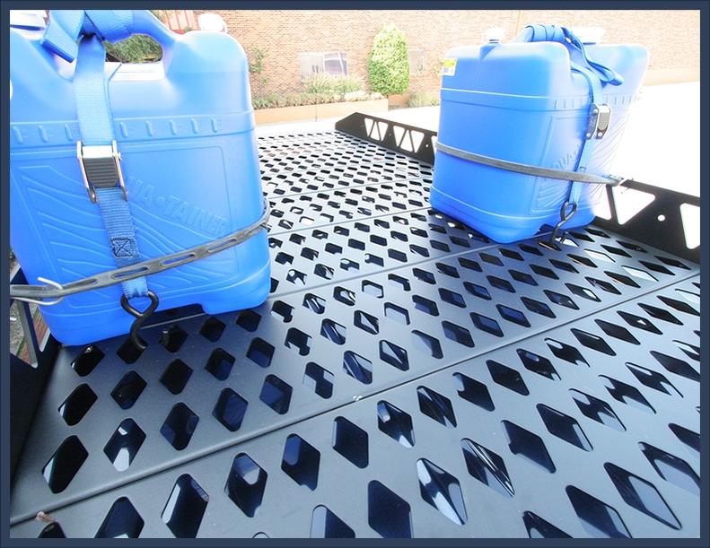

I like the additional crossbars in your design for support/inherent strength. I've been researching racks similar to yours. The use of perforated aluminum sheeting would make it VERY strong, as seen in the pic (from another site). All depends on the intended use. I intend to mount a roof top tent (RTT), and seek a flat surface. Also use it for two-plus person viewing and/or photography platform.

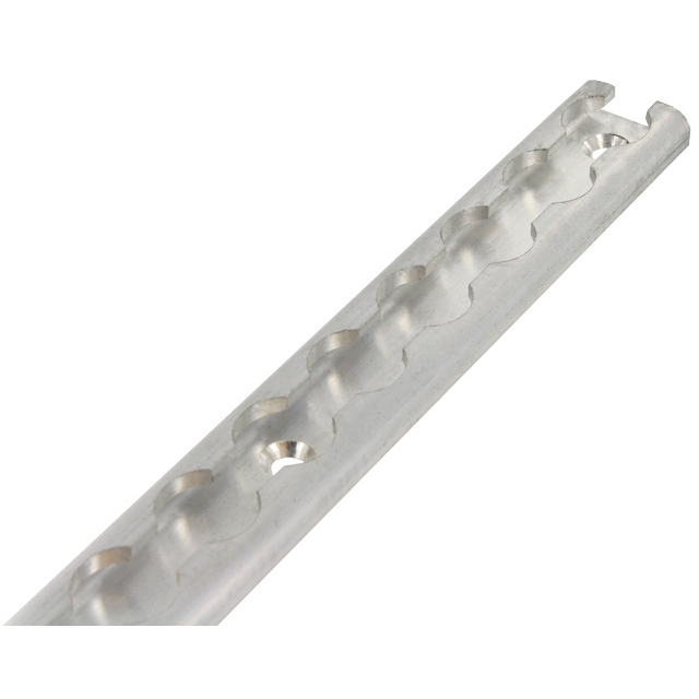

My thoughts keep going back to a square tube rack that will fit over the existing TE roof rails (which I think will hold more than the Limited or SR by design) and is easily removed, yet sturdy.
I say square tube because I want to use a tie down system on the sides, a spare tire mounting in the middle, and room for 2 -4 gal. Rotopax up front. I also want tabs for 2 -Rigid Ind. SR 10" LED's.
Here's a pic of the tie down and a link
http://www.uscargocontrol.com/Ratch...rline-Track-12-Aluminum-Finish-Logistic-Track
Great designs guys, I especially love the stamped aluminum product, makes great sense.... I like heavy built, it never disappoints....

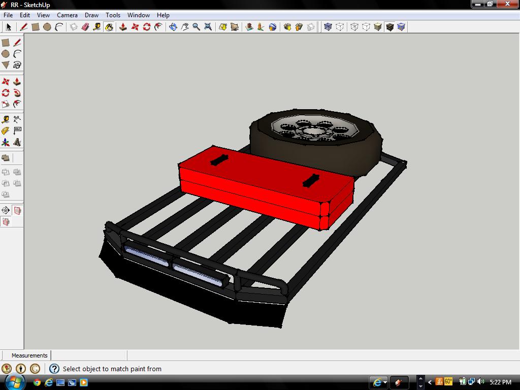

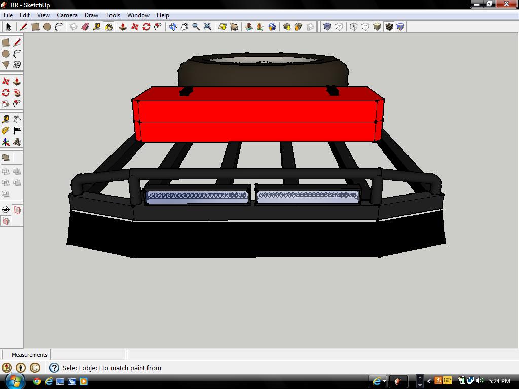

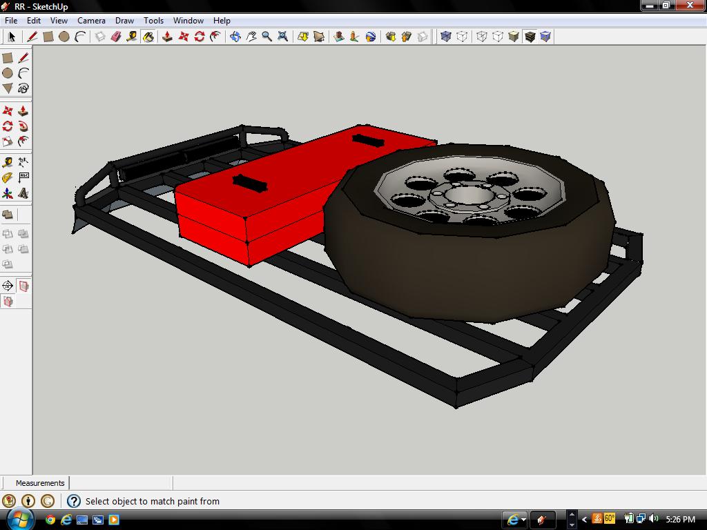

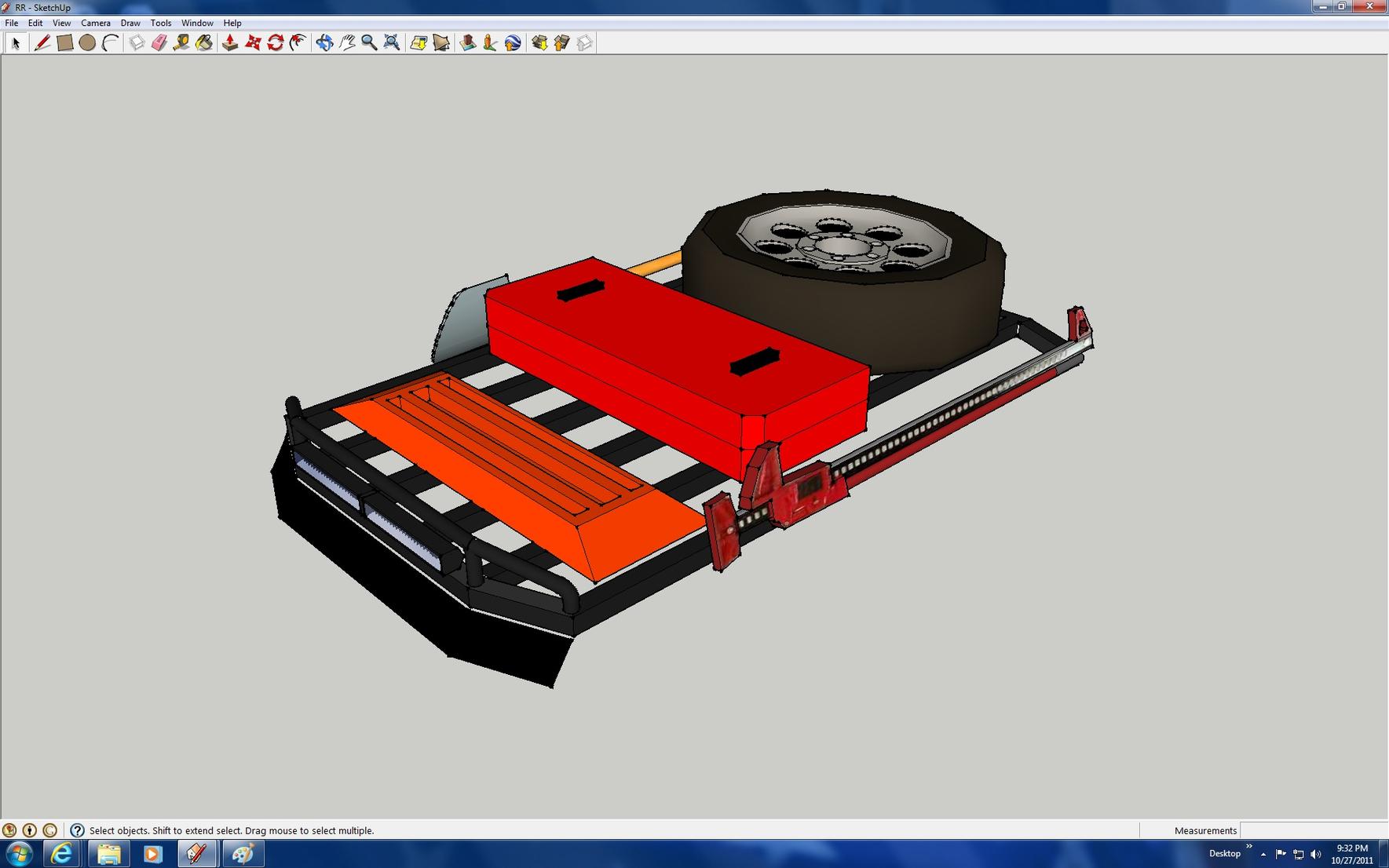

The pictures as promised...albeit late.
The rack was designed for a spare, Hi-Lift, and 2 -4 gal. Rotopax
The angles and material dimesions are the same used on my custom built steps. The LED's are based off Rigid 10"SR.
The brackets don't show to connect to the existing TE rack, but I'm sure once the metal starts flying it'll get figured out quick...
Cool rack.......how do you like using sketchup? I hear its pretty decent considering the price FREE FREE FREE. I'm sure its worth it considering what I pay for flippin' Solidworks and Catia. Cant wait to finish the design up on mine after I get my TE roof rack in. Post up your progress, would like to see it!
It's very cool....I just dabble it in though.
If a guy like yourself that can obviously design and draw fools with it, I think you'd like it!. I'll get a seperate thread going on the build stage....which I keep going back and forth on, after seeing jonessyy's rack...lol

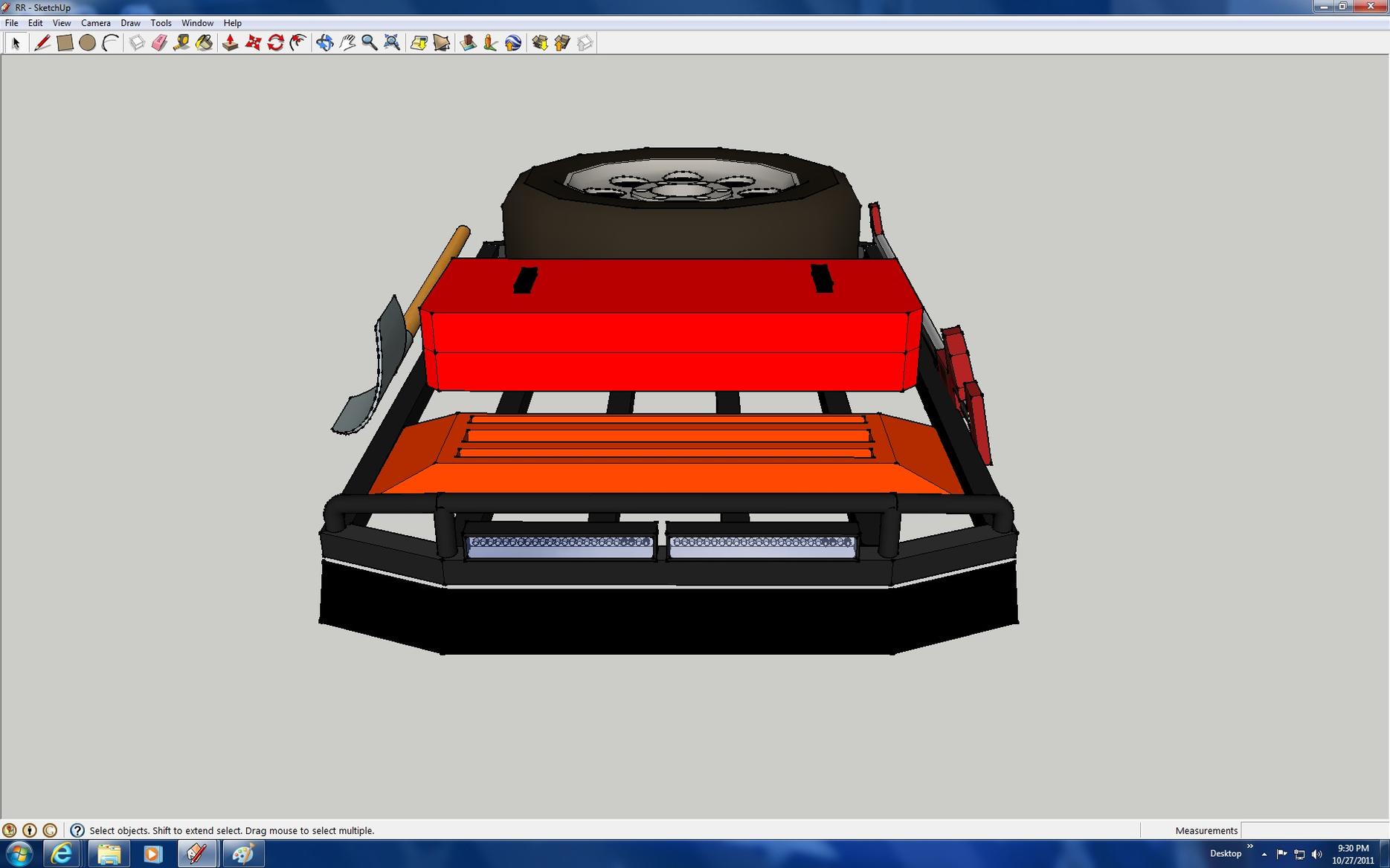

Final draft with Spare, rotopax, Hi-lift, shovel, MaxTrax
